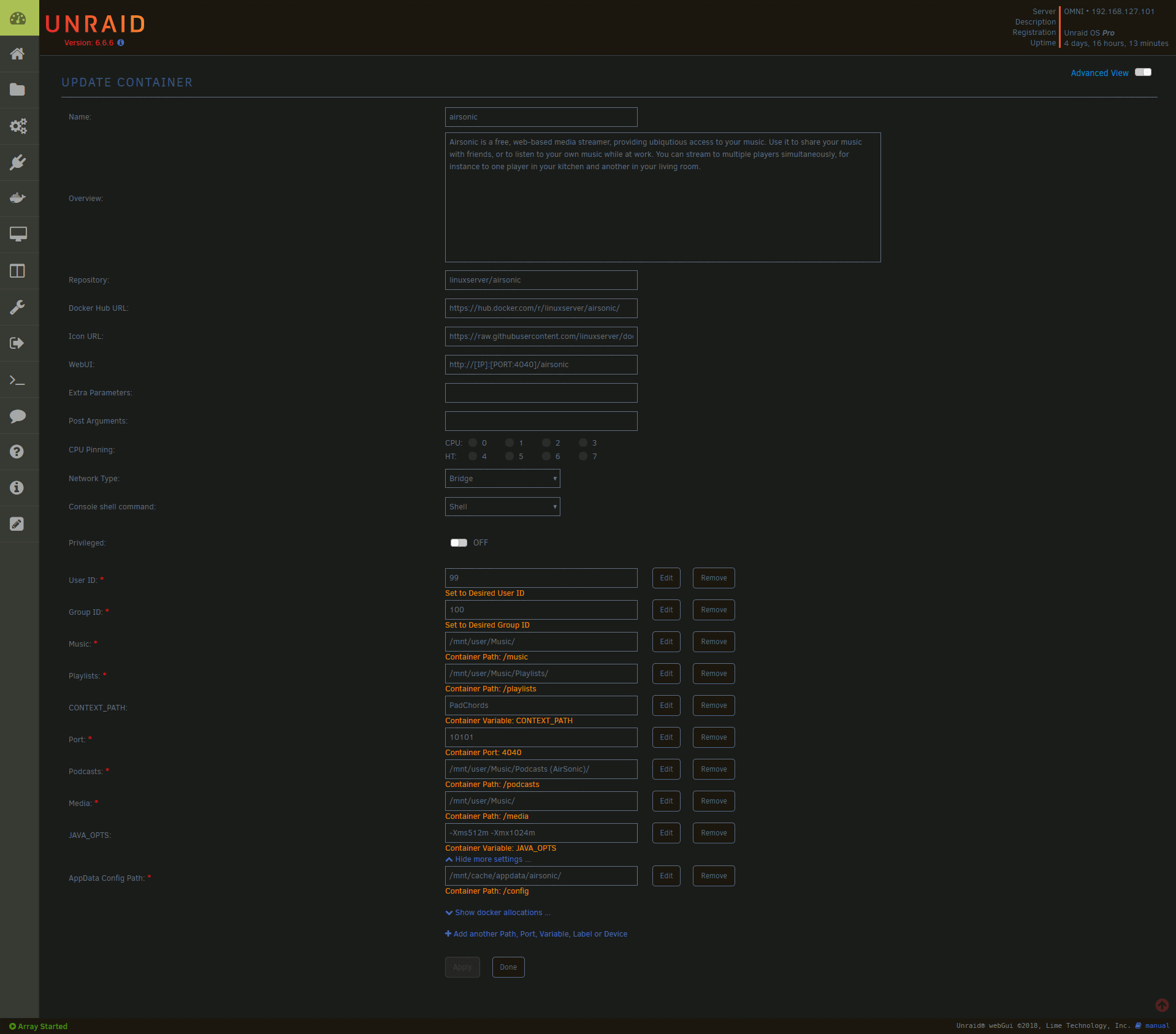

    set the variable to /   it's what i do
  • You have to turn on the authoring mode in docker settings, then remove the template url in the airsonic template and disable authoring mode again.

That was it!!! Thanks! I don't believe it used to have a URL path like that, so some update must have changed it. There should really be a 302 or 301 redirect on the root because a blank 404 is extremely unhelpful. I appreciate the help!
OK This was due to CONTEXT_PATH being set in the docker configuration.
-e CONTEXT_PATH=<URL_BASE>   For setting url-base in reverse proxy setups.
I've now removed it completely from my container settings, and after starting back up it's now serving on the root like it used to. Thanks again for the help.

Here's my
[s6-init] making user provided files available at /var/run/s6/etc...exited 0.[s6-init] ensuring user provided files have correct perms...exited 0.[fix-attrs.d] applying ownership & permissions fixes...[fix-attrs.d] done.[cont-init.d] executing container initialization scripts...[cont-init.d] 10-adduser: executing...-------------------------------------_ ()| | ___ _ __| | / __| | | / \| | \__ \ | | | () ||_| |___/ |_| \__/Brought to you by linuxserver.ioWe gratefully accept donations at:https://www.linuxserver.io/donate/-------------------------------------GID/UID-------------------------------------User uid: 99User gid: 100-------------------------------------[cont-init.d] 10-adduser: exited 0.[cont-init.d] 20-config: executing...[cont-init.d] 20-config: exited 0.[cont-init.d] done.[services.d] starting services[services.d] done._ _/\ (_) (_)/ \ _ _ __ ___ ___ _ __ _ ___/ /\ \ | | '__|/ __|/ _ \| '_ \| |/ __|/ ____ \| | | \__ \ (_) | | | | | (__/_/ \_\_|_| |___/\___/|_| |_|_|\___|10.2.1-RELEASE2019-03-05 20:11:39.627 INFO --- org.airsonic.player.Application : Starting Application v10.2.1-RELEASE on 25cc7c68fca1 with PID 210 (/app/airsonic/airsonic.war started by abc in /app/airsonic)2019-03-05 20:11:39.634 INFO --- org.airsonic.player.Application : The following profiles are active: legacy2019-03-05 20:11:41.942 INFO --- o.a.p.service.SettingsService : Java: 1.8.0_191, OS: Linux2019-03-05 20:11:42.327 INFO --- org.airsonic.player.Application : Detected Tomcat web server2019-03-05 20:12:07.425 INFO --- liquibase : Successfully acquired change log lock2019-03-05 20:12:07.425 INFO --- liquibase : Successfully acquired change log lock2019-03-05 20:12:09.359 INFO --- liquibase : Reading from DATABASECHANGELOG2019-03-05 20:12:09.479 INFO --- liquibase : classpath:liquibase/db-changelog.xml: classpath:liquibase/10.2/setup-hsqldb-checkpoint-defrag.xml::setup-hsqldb-checkpoint-defrag::fxthomas: Rolling Back Changeset:classpath:liquibase/10.2/setup-hsqldb-checkpoint-defrag.xml::setup-hsqldb-checkpoint-defrag::fxthomas2019-03-05 20:12:09.481 INFO --- liquibase : classpath:liquibase/db-changelog.xml: classpath:liquibase/6.4/add-album-mb-release-id.xml::add-album-mb-release-id::fxthomas: Rolling Back Changeset:classpath:liquibase/6.4/add-album-mb-release-id.xml::add-album-mb-release-id::fxthomas2019-03-05 20:12:09.483 INFO --- liquibase : classpath:liquibase/db-changelog.xml: classpath:liquibase/6.4/add-media-file-mb-release-id.xml::add-media-file-mb-release-id::fxthomas: Rolling Back Changeset:classpath:liquibase/6.4/add-media-file-mb-release-id.xml::add-media-file-mb-release-id::fxthomas2019-03-05 20:12:09.489 INFO --- liquibase : Successfully released change log lock2019-03-05 20:12:09.491 INFO --- liquibase : Waiting for changelog lock....2019-03-05 20:12:09.359 INFO --- liquibase : Reading from DATABASECHANGELOG2019-03-05 20:12:09.479 INFO --- liquibase : classpath:liquibase/db-changelog.xml: classpath:liquibase/10.2/setup-hsqldb-checkpoint-defrag.xml::setup-hsqldb-checkpoint-defrag::fxthomas: Rolling Back Changeset:classpath:liquibase/10.2/setup-hsqldb-checkpoint-defrag.xml::setup-hsqldb-checkpoint-defrag::fxthomas2019-03-05 20:12:09.481 INFO --- liquibase : classpath:liquibase/db-changelog.xml: classpath:liquibase/6.4/add-album-mb-release-id.xml::add-album-mb-release-id::fxthomas: Rolling Back Changeset:classpath:liquibase/6.4/add-album-mb-release-id.xml::add-album-mb-release-id::fxthomas2019-03-05 20:12:09.483 INFO --- liquibase : classpath:liquibase/db-changelog.xml: classpath:liquibase/6.4/add-media-file-mb-release-id.xml::add-media-file-mb-release-id::fxthomas: Rolling Back Changeset:classpath:liquibase/6.4/add-media-file-mb-release-id.xml::add-media-file-mb-release-id::fxthomas2019-03-05 20:12:09.489 INFO --- liquibase : Successfully released change log lock2019-03-05 20:12:09.491 INFO --- liquibase : Waiting for changelog lock....2019-03-05 20:12:19.492 INFO --- liquibase : Waiting for changelog lock....2019-03-05 20:12:29.493 INFO --- liquibase : Waiting for changelog lock....2019-03-05 20:12:39.494 INFO --- liquibase : Waiting for changelog lock....2019-03-05 20:12:49.495 INFO --- liquibase : Waiting for changelog lock....2019-03-05 20:12:59.496 INFO --- liquibase : Waiting for changelog lock....2019-03-05 20:13:09.497 INFO --- liquibase : Waiting for changelog lock....2019-03-05 20:13:09.497 INFO --- liquibase : Waiting for changelog lock....2019-03-05 20:13:19.497 INFO --- liquibase : Waiting for changelog lock....2019-03-05 20:13:29.498 INFO --- liquibase : Waiting for changelog lock....2019-03-05 20:13:39.499 INFO --- liquibase : Waiting for changelog lock....2019-03-05 20:13:49.500 INFO --- liquibase : Waiting for changelog lock....2019-03-05 20:13:59.501 INFO --- liquibase : Waiting for changelog lock....2019-03-05 20:13:59.501 INFO --- liquibase : Waiting for changelog lock....2019-03-05 20:14:09.502 INFO --- liquibase : Waiting for changelog lock....2019-03-05 20:14:19.503 INFO --- liquibase : Waiting for changelog lock....2019-03-05 20:14:29.503 INFO --- liquibase : Waiting for changelog lock....2019-03-05 20:14:39.504 INFO --- liquibase : Waiting for changelog lock....2019-03-05 20:14:49.505 INFO --- liquibase : Waiting for changelog lock....2019-03-05 20:14:59.506 INFO --- liquibase : Waiting for changelog lock....2019-03-05 20:14:59.506 INFO --- liquibase : Waiting for changelog lock....2019-03-05 20:15:09.507 INFO --- liquibase : Waiting for changelog lock....2019-03-05 20:15:19.507 INFO --- liquibase : Waiting for changelog lock....2019-03-05 20:17:09.517 ERROR --- o.a.p.spring.SpringLiquibase : ===============================================2019-03-05 20:17:09.517 ERROR --- o.a.p.spring.SpringLiquibase : An exception occurred during database migration2019-03-05 20:17:09.517 ERROR --- o.a.p.spring.SpringLiquibase : A rollback file has been generated at /config/rollback.sql2019-03-05 20:17:09.517 ERROR --- o.a.p.spring.SpringLiquibase : Execute it within your database to rollback any changes2019-03-05 20:17:09.521 ERROR --- o.a.p.spring.SpringLiquibase : The exception is as followsliquibase.exception.LockException: Could not acquire change log lock. Currently locked by c9f6f438f31c (172.17.0.4) since 3/1/19 10:01 PMat liquibase.lockservice.StandardLockService.waitForLock(StandardLockService.java:190) ~[liquibase-core-3.5.1.jar!/:na]at liquibase.Liquibase.update(Liquibase.java:196) ~[liquibase-core-3.5.1.jar!/:na]at liquibase.Liquibase.update(Liquibase.java:192) ~[liquibase-core-3.5.1.jar!/:na]at liquibase.integration.spring.SpringLiquibase.performUpdate(SpringLiquibase.java:434) ~[liquibase-core-3.5.1.jar!/:na]at liquibase.integration.spring.SpringLiquibase.afterPropertiesSet(SpringLiquibase.java:391) ~[liquibase-core-3.5.1.jar!/:na]at org.airsonic.player.spring.SpringLiquibase.afterPropertiesSet(SpringLiquibase.java:26) ~[classes!/:10.2.1-RELEASE]at org.springframework.beans.factory.support.AbstractAutowireCapableBeanFactory.invokeInitMethods(AbstractAutowireCapableBeanFactory.java:1689) [spring-beans-4.3.21.RELEASE.jar!/:4.3.21.RELEASE]at org.springframework.beans.factory.support.AbstractAutowireCapableBeanFactory.initializeBean(AbstractAutowireCapableBeanFactory.java:1627) [spring-beans-4.3.21.RELEASE.jar!/:4.3.21.RELEASE]at org.springframework.beans.factory.support.AbstractAutowireCapableBeanFactory.doCreateBean(AbstractAutowireCapableBeanFactory.java:553) [spring-beans-4.3.21.RELEASE.jar!/:4.3.21.RELEASE]at org.springframework.beans.factory.support.AbstractAutowireCapableBeanFactory.createBean(AbstractAutowireCapableBeanFactory.java:481) [spring-beans-4.3.21.RELEASE.jar!/:4.3.21.RELEASE]at org.springframework.beans.factory.support.AbstractBeanFactory$1.getObject(AbstractBeanFactory.java:312) [spring-beans-4.3.21.RELEASE.jar!/:4.3.21.RELEASE]at org.springframework.beans.factory.support.DefaultSingletonBeanRegistry.getSingleton(DefaultSingletonBeanRegistry.java:230) [spring-beans-4.3.21.RELEASE.jar!/:4.3.21.RELEASE]at org.springframework.beans.factory.support.AbstractBeanFactory.doGetBean(AbstractBeanFactory.java:308) [spring-beans-4.3.21.RELEASE.jar!/:4.3.21.RELEASE]at org.springframework.beans.factory.support.AbstractBeanFactory.getBean(AbstractBeanFactory.java:197) [spring-beans-4.3.21.RELEASE.jar!/:4.3.21.RELEASE]at org.springframework.beans.factory.support.AbstractBeanFactory.doGetBean(AbstractBeanFactory.java:297) [spring-beans-4.3.21.RELEASE.jar!/:4.3.21.RELEASE]at org.springframework.beans.factory.support.AbstractBeanFactory.getBean(AbstractBeanFactory.java:202) [spring-beans-4.3.21.RELEASE.jar!/:4.3.21.RELEASE]at org.springframework.beans.factory.config.DependencyDescriptor.resolveCandidate(DependencyDescriptor.java:208) [spring-beans-4.3.21.RELEASE.jar!/:4.3.21.RELEASE]at org.springframework.beans.factory.support.DefaultListableBeanFactory.doResolveDependency(DefaultListableBeanFactory.java:1136) [spring-beans-4.3.21.RELEASE.jar!/:4.3.21.RELEASE]at org.springframework.beans.factory.support.DefaultListableBeanFactory.resolveDependency(DefaultListableBeanFactory.java:1064) [spring-beans-4.3.21.RELEASE.jar!/:4.3.21.RELEASE]at org.springframework.beans.factory.annotation.AutowiredAnnotationBeanPostProcessor$AutowiredFieldElement.inject(AutowiredAnnotationBeanPostProcessor.java:583) [spring-beans-4.3.21.RELEASE.jar!/:4.3.21.RELEASE]at org.springframework.beans.factory.annotation.InjectionMetadata.inject(InjectionMetadata.java:87) [spring-beans-4.3.21.RELEASE.jar!/:4.3.21.RELEASE]at org.springframework.beans.factory.annotation.AutowiredAnnotationBeanPostProcessor.postProcessPropertyValues(AutowiredAnnotationBeanPostProcessor.java:364) [spring-beans-4.3.21.RELEASE.jar!/:4.3.21.RELEASE]at org.springframework.beans.factory.support.AbstractAutowireCapableBeanFactory.populateBean(AbstractAutowireCapableBeanFactory.java:1269) [spring-beans-4.3.21.RELEASE.jar!/:4.3.21.RELEASE]at org.springframework.beans.factory.support.AbstractAutowireCapableBeanFactory.doCreateBean(AbstractAutowireCapableBeanFactory.java:551) [spring-beans-4.3.21.RELEASE.jar!/:4.3.21.RELEASE]at org.springframework.beans.factory.support.AbstractAutowireCapableBeanFactory.createBean(AbstractAutowireCapableBeanFactory.java:481) [spring-beans-4.3.21.RELEASE.jar!/:4.3.21.RELEASE]at org.springframework.beans.factory.support.AbstractBeanFactory$1.getObject(AbstractBeanFactory.java:312) [spring-beans-4.3.21.RELEASE.jar!/:4.3.21.RELEASE]at org.springframework.beans.factory.support.DefaultSingletonBeanRegistry.getSingleton(DefaultSingletonBeanRegistry.java:230) [spring-beans-4.3.21.RELEASE.jar!/:4.3.21.RELEASE]at org.springframework.beans.factory.support.AbstractBeanFactory.doGetBean(AbstractBeanFactory.java:308) [spring-beans-4.3.21.RELEASE.jar!/:4.3.21.RELEASE]at org.springframework.beans.factory.support.AbstractBeanFactory.getBean(AbstractBeanFactory.java:197) [spring-beans-4.3.21.RELEASE.jar!/:4.3.21.RELEASE]at org.springframework.beans.factory.support.DefaultListableBeanFactory.preInstantiateSingletons(DefaultListableBeanFactory.java:761) [spring-beans-4.3.21.RELEASE.jar!/:4.3.21.RELEASE]at org.springframework.context.support.AbstractApplicationContext.finishBeanFactoryInitialization(AbstractApplicationContext.java:867) [spring-context-4.3.21.RELEASE.jar!/:4.3.21.RELEASE]at org.springframework.context.support.AbstractApplicationContext.refresh(AbstractApplicationContext.java:543) [spring-context-4.3.21.RELEASE.jar!/:4.3.21.RELEASE]at org.springframework.boot.context.embedded.EmbeddedWebApplicationContext.refresh(EmbeddedWebApplicationContext.java:124) [spring-boot-1.5.18.RELEASE.jar!/:1.5.18.RELEASE]at org.springframework.boot.SpringApplication.refresh(SpringApplication.java:693) [spring-boot-1.5.18.RELEASE.jar!/:1.5.18.RELEASE]at org.springframework.boot.SpringApplication.refreshContext(SpringApplication.java:360) [spring-boot-1.5.18.RELEASE.jar!/:1.5.18.RELEASE]at org.springframework.boot.SpringApplication.run(SpringApplication.java:303) [spring-boot-1.5.18.RELEASE.jar!/:1.5.18.RELEASE]at org.springframework.boot.builder.SpringApplicationBuilder.run(SpringApplicationBuilder.java:134) [spring-boot-1.5.18.RELEASE.jar!/:1.5.18.RELEASE]at org.airsonic.player.Application.main(Application.java:229) [classes!/:10.2.1-RELEASE]at sun.reflect.NativeMethodAccessorImpl.invoke0(Native Method) ~[na:1.8.0_191]at sun.reflect.NativeMethodAccessorImpl.invoke(NativeMethodAccessorImpl.java:62) ~[na:1.8.0_191]at sun.reflect.DelegatingMethodAccessorImpl.invoke(DelegatingMethodAccessorImpl.java:43) ~[na:1.8.0_191]at java.lang.reflect.Method.invoke(Method.java:498) ~[na:1.8.0_191]at org.springframework.boot.loader.MainMethodRunner.run(MainMethodRunner.java:48) [airsonic.war:10.2.1-RELEASE]at org.springframework.boot.loader.Launcher.launch(Launcher.java:87) [airsonic.war:10.2.1-RELEASE]at org.springframework.boot.loader.Launcher.launch(Launcher.java:50) [airsonic.war:10.2.1-RELEASE]at org.springframework.boot.loader.WarLauncher.main(WarLauncher.java:59) [airsonic.war:10.2.1-RELEASE]2019-03-05 20:17:09.522 ERROR --- o.a.p.spring.SpringLiquibase : ===============================================2019-03-05 20:17:09.522 WARN --- ationConfigEmbeddedWebApplicationContext : Exception encountered during context initialization - cancelling refresh attempt: org.springframework.beans.factory.UnsatisfiedDependencyException: Error creating bean with name 'playerSettingsController': Unsatisfied dependency expressed through field 'playerService'; nested exception is org.springframework.beans.factory.BeanCreationException: Error creating bean with name 'liquibase' defined in class path resource [applicationContext-db.xml]: Invocation of init method failed; nested exception is liquibase.exception.LockException: Could not acquire change log lock. Currently locked by c9f6f438f31c (172.17.0.4) since 3/1/19 10:01 PM2019-03-05 20:17:09.549 ERROR --- o.s.boot.SpringApplication : Application startup failedorg.springframework.beans.factory.UnsatisfiedDependencyException: Error creating bean with name 'playerSettingsController': Unsatisfied dependency expressed through field 'playerService'; nested exception is org.springframework.beans.factory.BeanCreationException: Error creating bean with name 'liquibase' defined in class path resource [applicationContext-db.xml]: Invocation of init method failed; nested exception is liquibase.exception.LockException: Could not acquire change log lock. Currently locked by c9f6f438f31c (172.17.0.4) since 3/1/19 10:01 PMat org.springframework.beans.factory.annotation.AutowiredAnnotationBeanPostProcessor$AutowiredFieldElement.inject(AutowiredAnnotationBeanPostProcessor.java:586) ~[spring-beans-4.3.21.RELEASE.jar!/:4.3.21.RELEASE]at org.springframework.beans.factory.annotation.InjectionMetadata.inject(InjectionMetadata.java:87) ~[spring-beans-4.3.21.RELEASE.jar!/:4.3.21.RELEASE]at org.springframework.beans.factory.annotation.AutowiredAnnotationBeanPostProcessor.postProcessPropertyValues(AutowiredAnnotationBeanPostProcessor.java:364) ~[spring-beans-4.3.21.RELEASE.jar!/:4.3.21.RELEASE]at org.springframework.beans.factory.support.AbstractAutowireCapableBeanFactory.populateBean(AbstractAutowireCapableBeanFactory.java:1269) ~[spring-beans-4.3.21.RELEASE.jar!/:4.3.21.RELEASE]at org.springframework.beans.factory.support.AbstractAutowireCapableBeanFactory.doCreateBean(AbstractAutowireCapableBeanFactory.java:551) ~[spring-beans-4.3.21.RELEASE.jar!/:4.3.21.RELEASE]at org.springframework.beans.factory.support.AbstractAutowireCapableBeanFactory.createBean(AbstractAutowireCapableBeanFactory.java:481) ~[spring-beans-4.3.21.RELEASE.jar!/:4.3.21.RELEASE]at org.springframework.beans.factory.support.AbstractBeanFactory$1.getObject(AbstractBeanFactory.java:312) ~[spring-beans-4.3.21.RELEASE.jar!/:4.3.21.RELEASE]at org.springframework.beans.factory.support.DefaultSingletonBeanRegistry.getSingleton(DefaultSingletonBeanRegistry.java:230) ~[spring-beans-4.3.21.RELEASE.jar!/:4.3.21.RELEASE]at org.springframework.beans.factory.support.AbstractBeanFactory.doGetBean(AbstractBeanFactory.java:308) ~[spring-beans-4.3.21.RELEASE.jar!/:4.3.21.RELEASE]at org.springframework.beans.factory.support.AbstractBeanFactory.getBean(AbstractBeanFactory.java:197) ~[spring-beans-4.3.21.RELEASE.jar!/:4.3.21.RELEASE]at org.springframework.beans.factory.support.DefaultListableBeanFactory.preInstantiateSingletons(DefaultListableBeanFactory.java:761) ~[spring-beans-4.3.21.RELEASE.jar!/:4.3.21.RELEASE]at org.springframework.context.support.AbstractApplicationContext.finishBeanFactoryInitialization(AbstractApplicationContext.java:867) ~[spring-context-4.3.21.RELEASE.jar!/:4.3.21.RELEASE]at org.springframework.context.support.AbstractApplicationContext.refresh(AbstractApplicationContext.java:543) ~[spring-context-4.3.21.RELEASE.jar!/:4.3.21.RELEASE]at org.springframework.boot.context.embedded.EmbeddedWebApplicationContext.refresh(EmbeddedWebApplicationContext.java:124) ~[spring-boot-1.5.18.RELEASE.jar!/:1.5.18.RELEASE]at org.springframework.boot.SpringApplication.refresh(SpringApplication.java:693) ~[spring-boot-1.5.18.RELEASE.jar!/:1.5.18.RELEASE]at org.springframework.boot.SpringApplication.refreshContext(SpringApplication.java:360) ~[spring-boot-1.5.18.RELEASE.jar!/:1.5.18.RELEASE]at org.springframework.boot.SpringApplication.run(SpringApplication.java:303) ~[spring-boot-1.5.18.RELEASE.jar!/:1.5.18.RELEASE]at org.springframework.boot.builder.SpringApplicationBuilder.run(SpringApplicationBuilder.java:134) [spring-boot-1.5.18.RELEASE.jar!/:1.5.18.RELEASE]at org.airsonic.player.Application.main(Application.java:229) [classes!/:10.2.1-RELEASE]at sun.reflect.NativeMethodAccessorImpl.invoke0(Native Method) ~[na:1.8.0_191]at sun.reflect.NativeMethodAccessorImpl.invoke(NativeMethodAccessorImpl.java:62) ~[na:1.8.0_191]at sun.reflect.DelegatingMethodAccessorImpl.invoke(DelegatingMethodAccessorImpl.java:43) ~[na:1.8.0_191]at java.lang.reflect.Method.invoke(Method.java:498) ~[na:1.8.0_191]at org.springframework.boot.loader.MainMethodRunner.run(MainMethodRunner.java:48) [airsonic.war:10.2.1-RELEASE]at org.springframework.boot.loader.Launcher.launch(Launcher.java:87) [airsonic.war:10.2.1-RELEASE]at org.springframework.boot.loader.Launcher.launch(Launcher.java:50) [airsonic.war:10.2.1-RELEASE]at org.springframework.boot.loader.WarLauncher.main(WarLauncher.java:59) [airsonic.war:10.2.1-RELEASE]Caused by: org.springframework.beans.factory.BeanCreationException: Error creating bean with name 'liquibase' defined in class path resource [applicationContext-db.xml]: Invocation of init method failed; nested exception is liquibase.exception.LockException: Could not acquire change log lock. Currently locked by c9f6f438f31c (172.17.0.4) since 3/1/19 10:01 PMat org.springframework.beans.factory.support.AbstractAutowireCapableBeanFactory.initializeBean(AbstractAutowireCapableBeanFactory.java:1631) ~[spring-beans-4.3.21.RELEASE.jar!/:4.3.21.RELEASE]at org.springframework.beans.factory.support.AbstractAutowireCapableBeanFactory.doCreateBean(AbstractAutowireCapableBeanFactory.java:553) ~[spring-beans-4.3.21.RELEASE.jar!/:4.3.21.RELEASE]at org.springframework.beans.factory.support.AbstractAutowireCapableBeanFactory.createBean(AbstractAutowireCapableBeanFactory.java:481) ~[spring-beans-4.3.21.RELEASE.jar!/:4.3.21.RELEASE]at org.springframework.beans.factory.support.AbstractBeanFactory$1.getObject(AbstractBeanFactory.java:312) ~[spring-beans-4.3.21.RELEASE.jar!/:4.3.21.RELEASE]at org.springframework.beans.factory.support.DefaultSingletonBeanRegistry.getSingleton(DefaultSingletonBeanRegistry.java:230) ~[spring-beans-4.3.21.RELEASE.jar!/:4.3.21.RELEASE]at org.springframework.beans.factory.support.AbstractBeanFactory.doGetBean(AbstractBeanFactory.java:308) ~[spring-beans-4.3.21.RELEASE.jar!/:4.3.21.RELEASE]at org.springframework.beans.factory.support.AbstractBeanFactory.getBean(AbstractBeanFactory.java:197) ~[spring-beans-4.3.21.RELEASE.jar!/:4.3.21.RELEASE]at org.springframework.beans.factory.support.AbstractBeanFactory.doGetBean(AbstractBeanFactory.java:297) ~[spring-beans-4.3.21.RELEASE.jar!/:4.3.21.RELEASE]at org.springframework.beans.factory.support.AbstractBeanFactory.getBean(AbstractBeanFactory.java:202) ~[spring-beans-4.3.21.RELEASE.jar!/:4.3.21.RELEASE]at org.springframework.beans.factory.config.DependencyDescriptor.resolveCandidate(DependencyDescriptor.java:208) ~[spring-beans-4.3.21.RELEASE.jar!/:4.3.21.RELEASE]at org.springframework.beans.factory.support.DefaultListableBeanFactory.doResolveDependency(DefaultListableBeanFactory.java:1136) ~[spring-beans-4.3.21.RELEASE.jar!/:4.3.21.RELEASE]at org.springframework.beans.factory.support.DefaultListableBeanFactory.resolveDependency(DefaultListableBeanFactory.java:1064) ~[spring-beans-4.3.21.RELEASE.jar!/:4.3.21.RELEASE]at org.springframework.beans.factory.annotation.AutowiredAnnotationBeanPostProcessor$AutowiredFieldElement.inject(AutowiredAnnotationBeanPostProcessor.java:583) ~[spring-beans-4.3.21.RELEASE.jar!/:4.3.21.RELEASE]... 26 common frames omittedCaused by: liquibase.exception.LockException: Could not acquire change log lock. Currently locked by c9f6f438f31c (172.17.0.4) since 3/1/19 10:01 PMat liquibase.lockservice.StandardLockService.waitForLock(StandardLockService.java:190) ~[liquibase-core-3.5.1.jar!/:na]at liquibase.Liquibase.update(Liquibase.java:196) ~[liquibase-core-3.5.1.jar!/:na]at liquibase.Liquibase.update(Liquibase.java:192) ~[liquibase-core-3.5.1.jar!/:na]at liquibase.integration.spring.SpringLiquibase.performUpdate(SpringLiquibase.java:434) ~[liquibase-core-3.5.1.jar!/:na]at liquibase.integration.spring.SpringLiquibase.afterPropertiesSet(SpringLiquibase.java:391) ~[liquibase-core-3.5.1.jar!/:na]at org.airsonic.player.spring.SpringLiquibase.afterPropertiesSet(SpringLiquibase.java:26) ~[classes!/:10.2.1-RELEASE]at org.springframework.beans.factory.support.AbstractAutowireCapableBeanFactory.invokeInitMethods(AbstractAutowireCapableBeanFactory.java:1689) ~[spring-beans-4.3.21.RELEASE.jar!/:4.3.21.RELEASE]at org.springframework.beans.factory.support.AbstractAutowireCapableBeanFactory.initializeBean(AbstractAutowireCapableBeanFactory.java:1627) ~[spring-beans-4.3.21.RELEASE.jar!/:4.3.21.RELEASE]... 38 common frames omitted
This continues for some time. It will ultimately throw an error, restart the server, and get stuck in the same loop. What can I do?
Post your docker run command
Sent from my Mi A1 using Tapatalk
I can't find that. I haven't upgraded to 6.6.7 yet, so maybe it's available in that version? Here's a screenshot of the Update Container page, if that will help:
Edited by elecgnosis
Not really sure what your issue is? But if you can't get to the webgui, which address do you go to? You have set your context path to PadChord, so you need to use that at the end.
Yourip:4040/PadChord

36 minutes ago, CHBMB said:
@IamSpartacus Docker run command?
I'm sorry @CHBMB what are you asking exactly?
Edited by IamSpartacus
11 minutes ago, CHBMB said:
Link is in my sig, command you're running to start the container.
docker run airsonic
Unable to find image 'airsonic:latest' locally
docker: Error response from daemon: pull access denied for airsonic, repository does not exist or may require 'docker login'
However I just realized I'm running binhex's container for this instead of yours.  Just goes to show you how much of your containers I'm running that I assume all are yours haha.  So I won't bother you with troubleshooting this.
docker run airsonicUnable to find image 'airsonic:latest' locallydocker: Error response from daemon: pull access denied for airsonic, repository does not exist or may require 'docker login'
"airsonic" isnt a valid repository You've modified the template and changed that entry to an invalid one
Sent via telekinesis
I think he opened command line and typed docker run airsonic.
