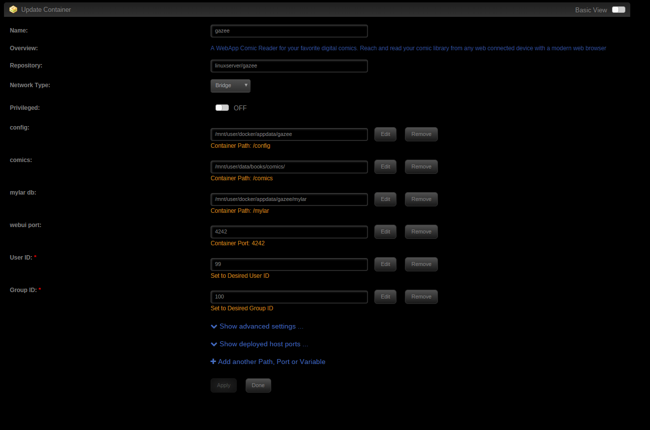

started using this today found a problem
1. Default directories do not map back: /comics and /mylar do not map in the docker image, you have to go into the app itself after startup to add the config file locations. This will cause any changes you make to be null and void.
2. mylar directory: i changed this once to be /mylar in the application itself but when i restarted the app the changes was not saved and it reverted my user additions and password changes.
1. I do not understand what the problem is. Could you try to explain it a different way?
2. Are you changing the config folder?
1.  In the default template you set your /comics and your /mylar config.  These drive mappings are not carried over when the application starts to automatically populate the Settings>Server>Comic Library Path or Mylar Path. You have to manually go in and set them in the application's WebUI
2. I'm not selecting anything but letting the system use the default which is mapped to my cache/docker/appdata/gazee/mylar  I'm not entirely sure it's writing to that dir or to the base image itself.

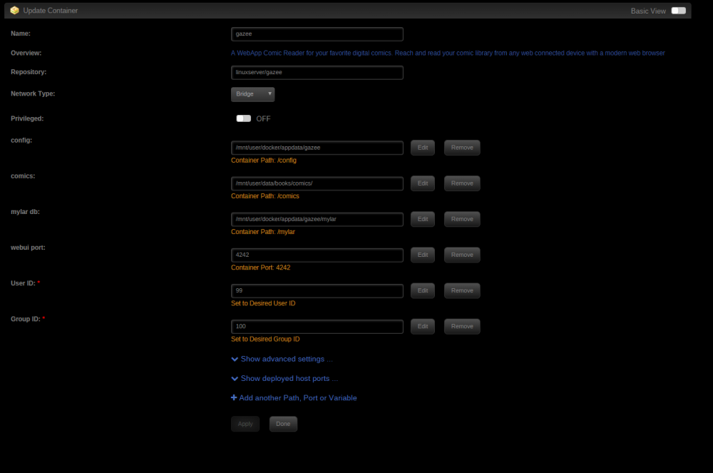

Please provide a screenshot of your template so I can see what you are entering.
1. Mapping folders to a container doesn't make the settings in the app populate. That you have to do yourself. Sometimes we add the settings if its possible, so might not be an easy way to do it with this app.
2. The default is not adding mylar to the end. Did you by any chance use /mnt/cache/appdata/gazed/mylar for the /mylar volume mapping?

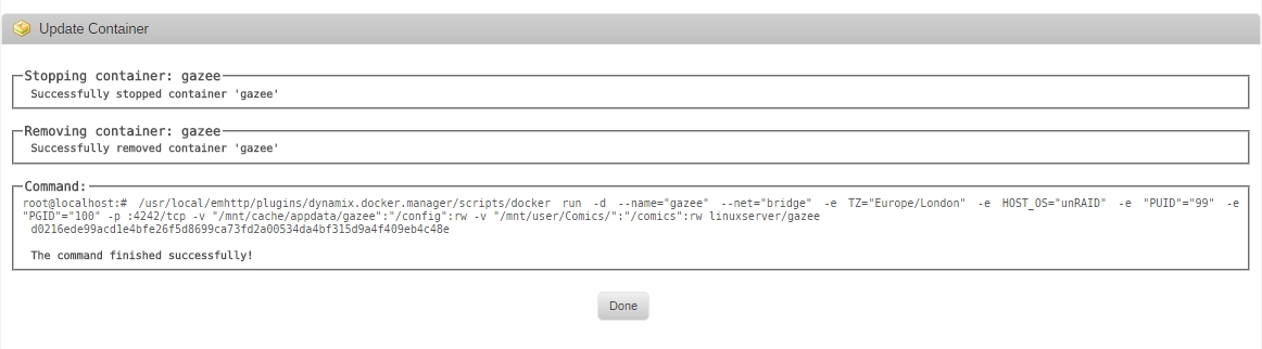

I'm seeing the same behavior:
root@localhost:# /usr/local/emhttp/plugins/dynamix.docker.manager/scripts/docker run -d --name="gazee" --net="bridge" -e TZ="America/Los_Angeles" -e HOST_OS="unRAID" -e "PUID"="99" -e "PGID"="100" -p 4242:4242/tcp -v "/mnt/user/appdata/gazee":"/config":rw -v "/mnt/user/Comics/":"/comics":rw -v "":"/mylar":rw linuxserver/gazee
/usr/bin/docker: Error response from daemon: Invalid volume spec ":/mylar:rw": Invalid volume specification: ':/mylar:rw'.
See '/usr/bin/docker run --help'.
The command failed.
The command failed.

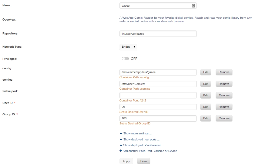

Just installed this. I had added my Mylar DB but see in the threads above I should delete this.
I did this but when I fire up the Web UI for Gazee I get sent right to the unRAID console. See docker template attached.
