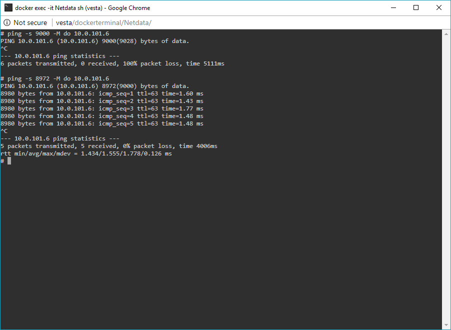

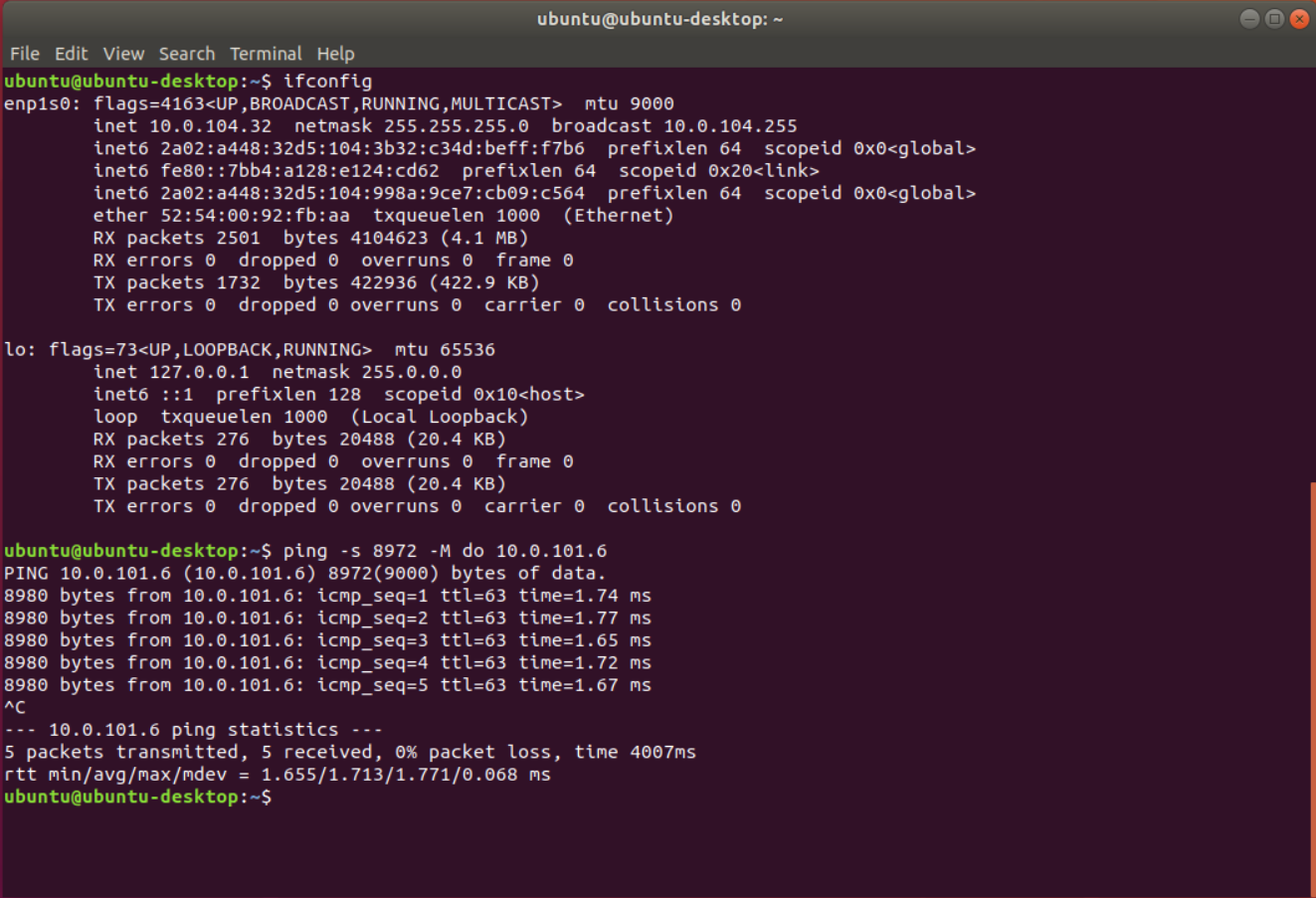

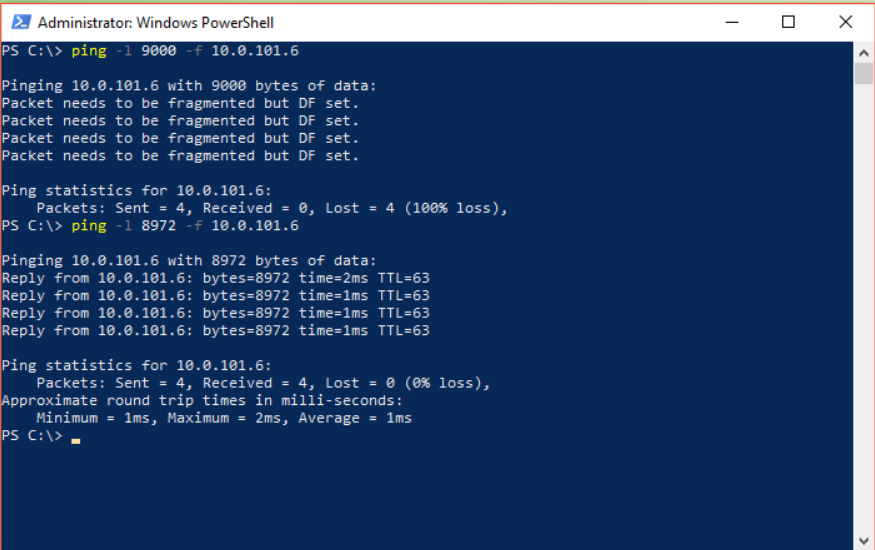

jumbo frames are working fine on my test server.
# ping 10.0.101.1 -s 9000
PING 10.0.101.1 (10.0.101.1) 9000(9028) bytes of data.
9008 bytes from 10.0.101.1: icmp_seq=1 ttl=64 time=0.879 ms
9008 bytes from 10.0.101.1: icmp_seq=2 ttl=64 time=0.787 ms
9008 bytes from 10.0.101.1: icmp_seq=3 ttl=64 time=0.803 ms
^C
--- 10.0.101.1 ping statistics ---
3 packets transmitted, 3 received, 0% packet loss, time 2032ms
rtt min/avg/max/mdev = 0.787/0.823/0.879/0.040 ms
The above is my test server pinging my router.

The next example is jumbo frame support in a Ubuntu VM, which requires the VM interface to support jumbo frames (Ubuntu allows changes thru GUI, but requires a restart to make them effective) AND because this VM is in a separate network (VLAN) it is required that the router supports jumbo frames too on its LAN interface(s).
The same for a Windows 10 VM
This is from inside a docker container (Netdata)
Edited by bonienl
