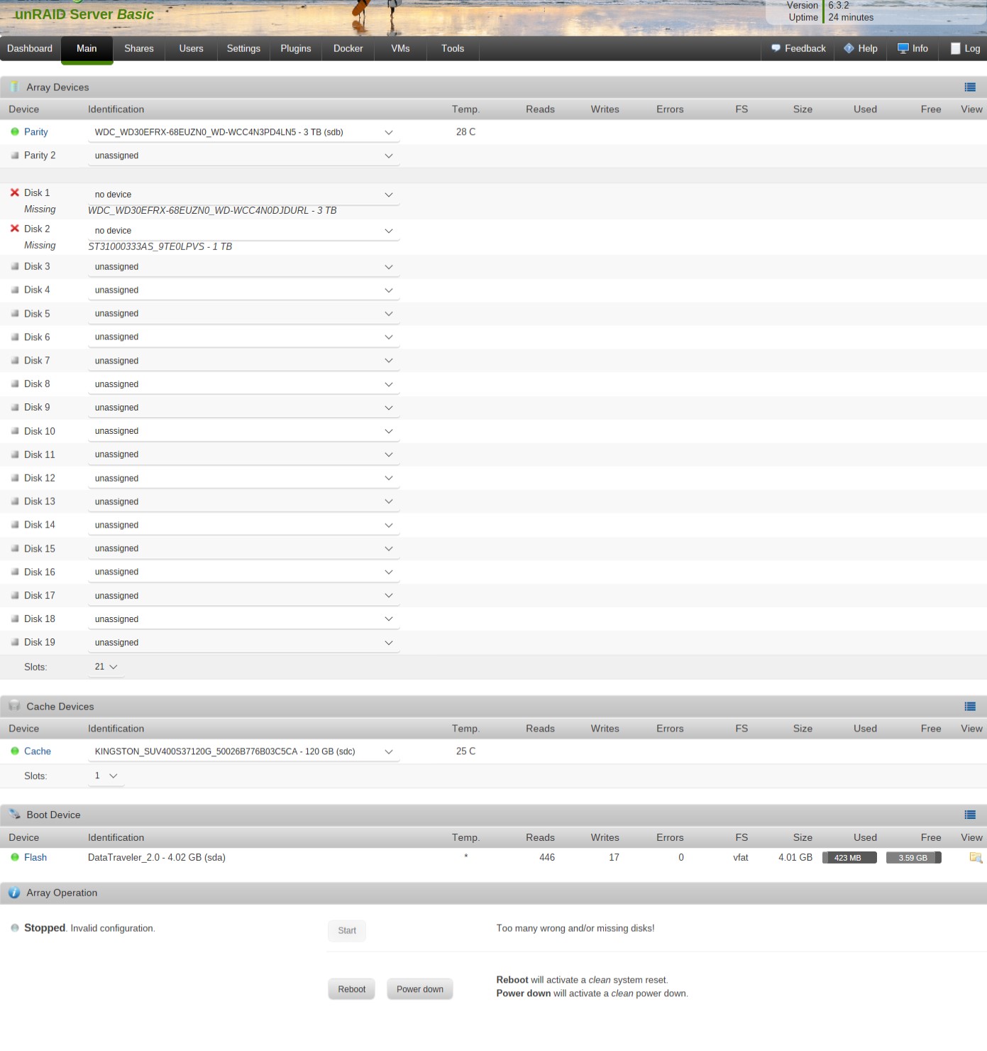

January 3, 20188 yr Hi, I am new to unraid, but I had it working fine for a few months, I stopped the Array and powered down over the holidays while I was away. I went to restart tonight and it shows both of my Disks missing, The parity is good, and so is the cache. I haven't done anything other than a restart. I've checked the form but I haven't seen a solution to this problem. Thanks for the help Andy disk.cfg docker.cfg domain.cfg go ident.cfg network.cfg network-rules.cfg share.cfg super.dat syslog.txt no qemu log files a-----a.cfg d-----s.cfg D-------s.cfg i--s.cfg L----------------e.cfg L-----------f.cfg M---a.cfg P------s.cfg S--------------------------------e.cfg S-----------------h.cfg s----m.cfg Kingston_DataTraveler_2.0_2008012500000000000003E0-0-0-20180102-2102.txt KINGSTON_SUV400S37120G_50026B776B03C5CA-20180102-2102.txt Optiarc_DVD_RW_AD-7260S-20180102-2102.txt WDC_WD30EFRX-68EUZN0_WD-WCC4N3PD4LN5-20180102-2102.txt cmdline.txt df.txt ethtool.txt folders.txt ifconfig.txt iommu_groups.txt lsmod.txt lsof.txt lspci.txt lsscsi.txt lsusb.txt memory.txt ps.txt vars.txt unRAID-6.3.2.txt
January 3, 20188 yr In the future please post the diagnostics zip as a single file. Missing disks are not being detected, check cabling, you can see if they are detected in the bios, also take the opportunity to change your IDE controller to AHCI, it might have reverted to IDE mode e.g. because of a low CMOS battery and be causing issues: Jan 2 20:36:26 StarKillerBase kernel: ata2.00: link is slow to respond, please be patient (ready=0) Jan 2 20:36:26 StarKillerBase kernel: ata2.00: SRST failed (errno=-16) Jan 2 20:36:26 StarKillerBase kernel: ata2.00: link is slow to respond, please be patient (ready=0) Jan 2 20:36:26 StarKillerBase kernel: ata2.00: SRST failed (errno=-16) Jan 2 20:36:26 StarKillerBase kernel: ata2.00: link is slow to respond, please be patient (ready=0) Jan 2 20:36:26 StarKillerBase kernel: ata2.00: SRST failed (errno=-16) Jan 2 20:36:26 StarKillerBase kernel: ata2.00: limiting SATA link speed to 1.5 Gbps Jan 2 20:36:26 StarKillerBase kernel: ata2.01: limiting SATA link speed to 1.5 Gbps Jan 2 20:36:26 StarKillerBase kernel: ata2.00: SRST failed (errno=-16) Jan 2 20:36:26 StarKillerBase kernel: ata2.00: reset failed, giving up

January 5, 20188 yr Author Thanks for your help, I haven’t move the computer and I checked all the cables, I also rearranged the cables. I got one more of the WD disks to show up after I changed to AHCI. I was wondering if this might be more of a mother board issue.
