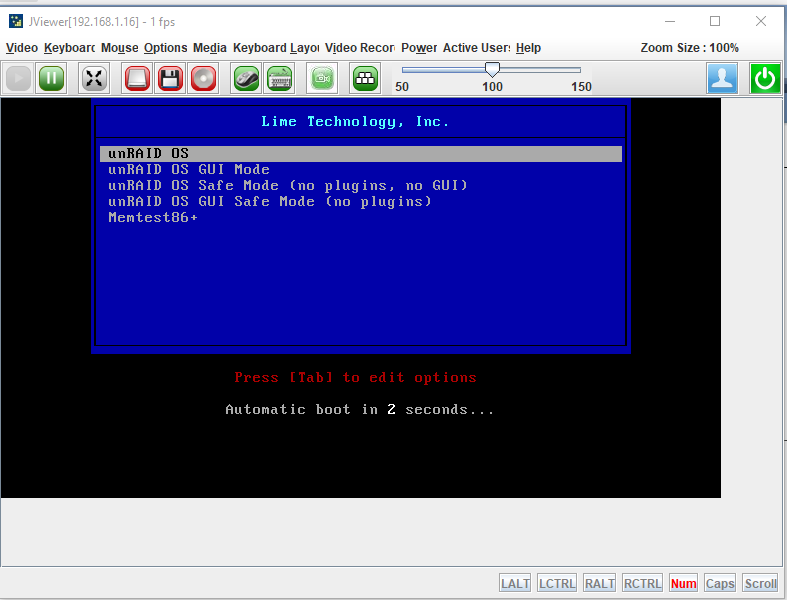

Beginning with unRAID 6.5.0 and with the latest BIOS update for my board (C236 WSI) unRAID would no longer boot in legacy mode and I had to switch to UEFI boot.
The BIOS video settings for my board are shown below.
Primary Graphics Adapter [Onboard] sets the AST2300/BMC as the primary video card.
Intel VGA Device Control [Enabled] enables the iGPU and creates the /dev/dri drivers for QSV transcoding.  I assume the equivalent in your board BIOS is the IGFX [Enabled] setting.
Here you can see the system booting via IPMI using the onboard AST2300:
And here you can see that I have a /dev/dri directory with the necessary contents for transcoding once the system is booted:
I hope this is helpful.

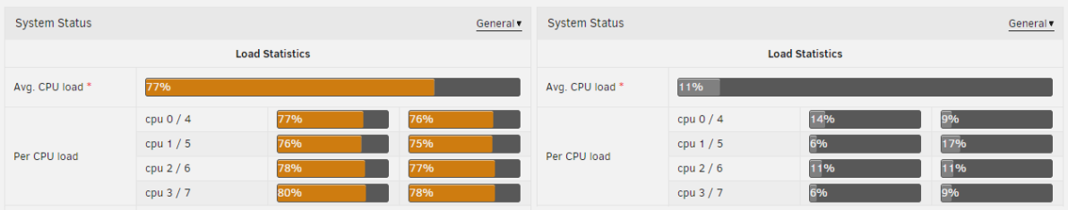

Edit: here is an image showing the CPU loads before and after while transcoding movies without throttling:
Totally worth the efforts. I'm surprised how CPU hungry Plex can be if you let it be. Obviously the 60s buffer throttling option largely mitigate the CPU load eventually on both sides but still.
