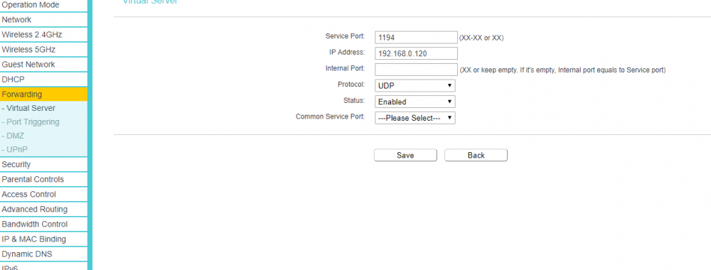

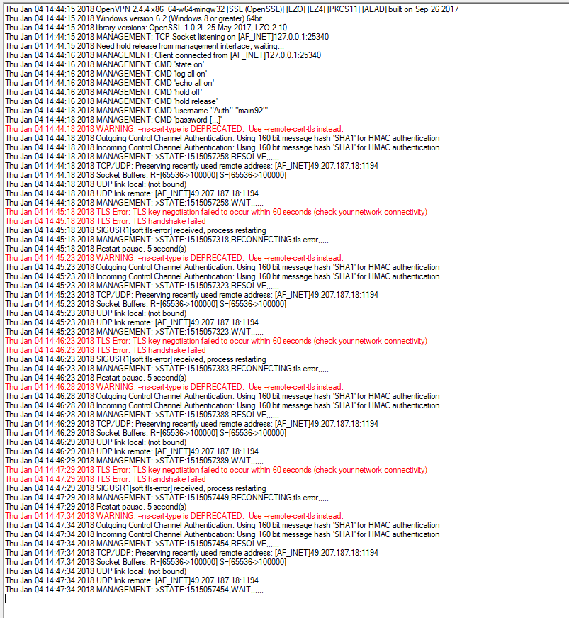

I have followed the steps given by the space invader video and solved almost everything but still the application is not going through to connect to the server.
I have attached the screenshot of Router, Docker, Open vpn client software reports.
Hope you can help here. Am a complete noob to this environment I just wanna make this work, please help :) TIA

Your server name dynamic dns resolves to 183.82.38.233 at the moment, your client appears to be trying to connect to 49.207.187.18, and who knows what your actual WAN IP is at this point.
