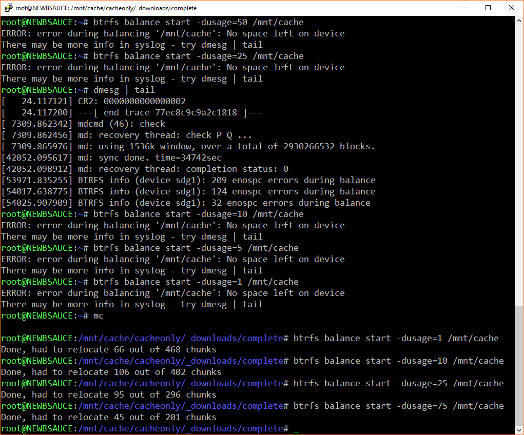

I did have to nuke some downloads to make space for the process, but I have completed a balance -dusage=75 without an error.
To anyone performing this in the future, as that -dusage percentage goes up... so does the time it takes to complete.  That last one at 75% took *at least* 20 minutes.  Restarting the server now to see if this did the trick.  *crosses fingers*  :)
Forgot to add that you'll need to delete recreate docker image after the balance.

Good, while on v6.3.5 it's good practice to schedule a weekly balance with -dusage=75 to keep the filesystem allocation under control, this issue it's supposedly fixed on the newer kernel used on v6.4, though still early to say if it's really fixed or not.
