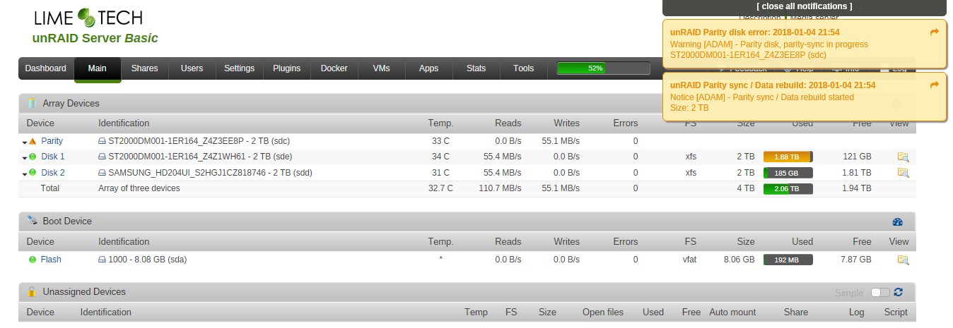

So. I had a 1TB drive fail. The drive was empty (no files at all) so no real problem at all. I replaced it with a 2TB drive and started the array, rebuilding etc.
Within a few seconds the replacement 2TB was grumpy so I stopped the array to pull the drive out.

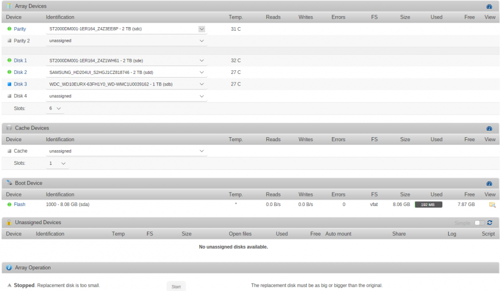

I had another spare 1TB drive so I stuck that in. Added it to the original position and it now won't let me start the array as the system thinks the 2TG was the original one and now complains
" The replacement disk must be as big or bigger than the original."
I can mount the replacement disk in slot #4, leaving #3 blank and restart as a new drive, but that will leave slot #3 complaining about a missing drive.
What's the best way to resolve this? The "New Array" option appears to be in the help things but that kinda worries me.

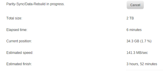

image.thumb.png.b9e8c963e58a9c72fef54c06079ccda2.png Oh well, here goes.... 4 hours to rebuild. Not too bad.
Edited by Wisnaeme
Adding further details.
Ok. All done, we're back up and running with that failed disk allocation removed.
