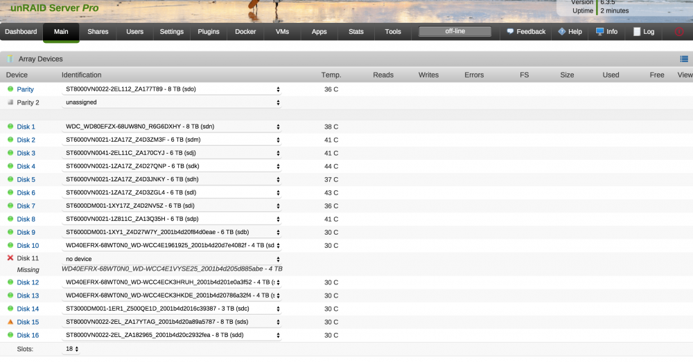

I have a dilemma I need some help with resolving. I have an array with 16 drives. About 3 times in 4 months I have had drive 15 drop out and need a rebuild. Generally this is not a problem but the drive tests good so I have been waiting for further symptoms to diagnose. Well, it may be related and may not but I was about 3% into the rebuild and lost drive 11. Now my challenge is  how to get the array online without compromising data. Obviously a second parity drive would resolve yeh problem but unfortunately I only have a single parity drive at the moment. Screen shot and diags attached if anyone has any thoughts.

Disk11 dropped offline, there's no SMART, post new diags after power cycling the server, though it's using a fiber connection, and SMART reports are like for SAS drives, I'd like to see a standard SATA SMART report.
There are no pending sectors but SMART shows triple digits raw read error rate, not good on a WD disk, anything above single digits is bad news.
You can try re-enabling that disk and rebuild disk15 again and see how it holds up, but only if the array is 100% unchanged (this includes docker and/or VMs using the array) since before the second disk got disable.
OK I was able to re-enable the disk in the JBOD controller and I disabled SMART monitoring for now. I disabled docker and VM support in UNRAID. All the drives are online again and I'm rebuilding drive 15. It will take awhile but by tomorrow my two new 8TB drives should arrive. One for replacing drive 11 and second parity drive to reduce the chances of this happening again. I love UNRAID but when things go wrong it's nerve wracking. I should have looked a little deeper instead of panicking, I could have done this yesterday.
