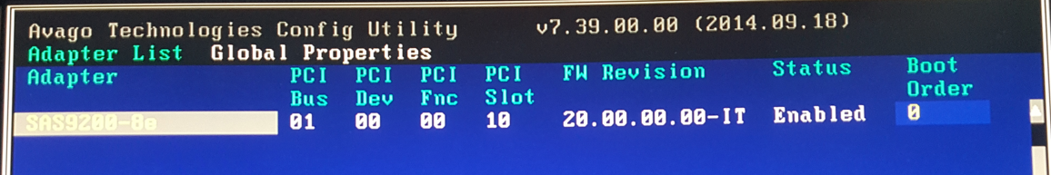

I am back for a little help with my LSI 9211-8i which is putting up errors during a parity check after installing, 4x disks are connected,

I bought the LSI pre-flashed to IT mode, which has FW version 20.00.00.00-IT,
Boot order is 0, with no option to disable boot support.
There are known issues with this firmware, update to 20.00.07

Just now, HK-Steve said:
re-flash to a lower version.
not lower, latest, which is 20.00.07.
