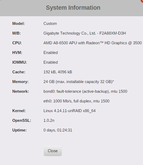

So I am currently trying out unRAID. My goal is to have a Windows 7 VM with a GTX 960 passed through to it along with a keyboard and mouse as my workstation. I have tried everything I have been able to find so far and nothing seems to be working. I am attaching the VMs config file, system information, system devices, and the syslinux config file. This machine is currently just for testing so I have no issues with wiping or resetting.
Note that both "pcie_acs_override=downstream" and "vfio_iommu_type1.allow_unsafe_interrupts=1" are enabled. As well as the pass through works fine with a Windows 10 VM. However I am looking to get Windows 7 running.

Unfortunately no nothing it says the VM is running but no output. I have tested with 3 cards (Nvidia 8400 GS, GT 210, GTX 960). I know that the 8400 GS and the GT 210 both have legacy bios while the GTX 960 seems to support both. All three have been tested in a couple other machines and work fine. And with the Windows 10 EFI machine posting on the GTX 960 I know that PCIe Pass through seems to work fine. I am going to try dumping the vbios and adding to the XML I will post back with results.
