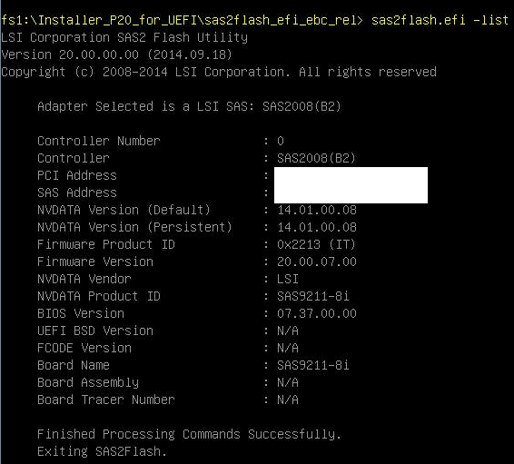

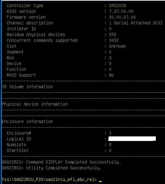

Thanks for all the help...Would you please look at these screens and confirm that my cards are properly setup...
They look fine.
