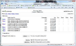

What have I done! red dots everywere
I am really new to unraid. Have been trying it out for the last 2 weeks screwing up and rebuilding about 4 times now reading the forums and learning as I went along. I got confident enough and upgraded to pro version building an unraid with 6 sata drives including parity. All went well until I decided to add a 300gb ide drive to the array. When I started up I had parity green disks 1 and 2 red and disk 3 blue. Disks 4 and 5 are green along with the offending new ide drive.
I removed the ide drive from the array and restarted with no luck. I physically disconnected it from the motherboard still no luck. The tower main page displays too many wrong and/or missing disks even though they are still there in their same order. I have data on disks 1 and 2 and nothing on the others. How can I just get the unraid to start a parity check as no data should have changed. Its not giving me the option. I do not know anything about linux just sort of decided to jump in the deep end.
I thought I knew my way around computers now I think Im just a dumb ass

Well then I guess Im screwed because I have already powered down the array. Mabey I should just remove the 2 drives with data, rebuild a new unraid with the others then move the data back onto those drives and add the removed drives afterward?

Here is the syslog just in case, have checked all cables and seem fine, am presently burning the ide cable with thermite.

It appears as if some of your drives are "paired" on simulated IDE controllers on the MB
May 25 21:46:45 Tower emhttp: pci-0000:00:1f.2-scsi-0:0:0:0 host5 (sdc) ST31000528AS_5VP50PDG
May 25 21:46:45 Tower emhttp: pci-0000:00:1f.2-scsi-0:0:1:0 host5 (sdd) SAMSUNG_HD753LJ_S13UJ1MQ328490
May 25 21:46:45 Tower emhttp: pci-0000:00:1f.2-scsi-1:0:0:0 host6 (sde) WDC_WD10EACS-00D6B0_WD-WCAU42375728
May 25 21:46:45 Tower emhttp: pci-0000:00:1f.2-scsi-1:0:1:0 host6 (sdf) SAMSUNG_HD501LJ_S0MUJ1MP892737
May 25 21:46:45 Tower emhttp: pci-0000:03:00.0-scsi-0:0:0:0 host0 (sda) ST3500320AS_9QM08JXA
May 25 21:46:45 Tower emhttp: pci-0000:03:00.0-scsi-1:0:0:0 host1 (sdb) ST3500320AS_9QM08L16
It is possible the IE disk shares a controller with either sda, or sdb.   In any case, it appears as if all 6 of your currently connected drives are identifying themselves to the OS.
According to this, disk1 and disk2 are now connected to different disk controller ports than they were originally.  Also according to this, disk3 has been replaced by a different disk.     Did you perhaps get the connectors mixed up?    It really does not matter though at this point.  see below...
May 25 21:46:45 Tower kernel: md: import disk0: [8,32] (sdc) ST31000528AS     5VP50PDG offset: 63 size: 976762552
May 25 21:46:45 Tower kernel: md: import disk1: [8,64] (sde) WDC WD10EACS-00D WD-WCAU42375728 offset: 63 size: 976761496
May 25 21:46:45 Tower kernel: md: disk1 wrong
May 25 21:46:45 Tower kernel: md: import disk2: [8,48] (sdd) SAMSUNG HD753LJ  S13UJ1MQ328490       offset: 63 size: 732573496
May 25 21:46:45 Tower kernel: md: disk2 wrong
May 25 21:46:45 Tower kernel: md: import disk3: [8,80] (sdf) SAMSUNG HD501LJ  S0MUJ1MP892737       offset: 63 size: 488385496
May 25 21:46:45 Tower kernel: md: disk3 replaced
May 25 21:46:45 Tower kernel: md: import disk4: [8,0] (sda) ST3500320AS      9QM08JXA offset: 63 size: 488386552
May 25 21:46:45 Tower kernel: md: import disk5: [8,16] (sdb) ST3500320AS      9QM08L16 offset: 63 size: 488386552
To get back to a good starting point, I think you can reset the array configuration and then press "Start" to begin computing parity on the existing set of drives.  Once parity is calculated you can then try again with your IDE drive.
To reset your array configuration log in on the system console or via telnet and type:
initconfig
Then on the web-management page, refresh it, and press the "Start" button to begin the process of calculating parity on the array.
Joe L.
The reason the two disks are showing as "wrong" is that your motherboard BIOS has apparently added an HPA to each changing its size. They are no longer the same size as when they were added to the array.  This is really bad, since the partition on the disk is potentially affected and so is the formatting.  (The file-system might still expect to be able to use those last few sectors stolen by the HPA)
You'll need to remove the HPA before those disks will work properly, but only after disabling the "feature" in the BIOS that is creating them.

This is a HUGE problem, and you should look in the wiki to learn about the HPA issue and at the least disable the "feature" in your Gigabyte BIOS.  That feature, if enabled in the BIOS by default and disabled by you, is a ticking time-bomb.  When the CMOS battery dies, the feature is re-enabled, it could corrupt the file-systems, or, as in this case, take multiple disks off-line.    You really need to update the MB BIOS (or the motherboard itself) to one where the feature is disabled by default.
See here: http://lime-technology.com/wiki/index.php?title=UnRAID_Topical_Index#HPA

Oh thats just awesome, Ive gone into the bios and cant find any setting to disable HPA, have tried the ctrl-f4 for more options but cant see any. Have just downloaded latest bios for mb trying to find a floppy drive to plug into the board. Ive read a few of the issues on HPA so does this mean that the affected drives can still be recovered?

The HPA feature is usually called something like 'Save a copy of BIOS to the hard drive'.  Look for that and disable it.
Here is the long but thorough explanation as to how to remove HPA partitions from your drives:
http://lime-technology.com/forum/index.php?topic=5072.msg46903#msg46903

Hi all, have didnt have time to try fixing during the week but have now swapped out motherboards to another gigabyte with the option of disabling hpa writing. Tower now showing 2 parity drive and disk 1 with red dots. I ran the hdparm command in accordance with the forum link substituting my drives native size which seems to have worked but Unraid is expecting the smaller hpa size. I then ran the initconfig command which brought all the except parity to green and have started a parity check. All seems to be looking well for now. Will post an update with syslog when partiy is completed.
