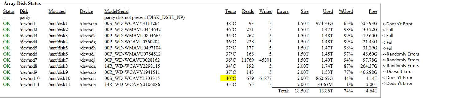

I am constantly losing connection to my server when transferring files to it. It is not a network/cable issue. It seems, the fuller the hard drive is, the higher the chance for it to time out. I can transfer to 50% full hard drives all day long, but if I transfer to a <20% full hard drive.. theres a high chance to lose connection to my server. These are large files 20+ GB each.
