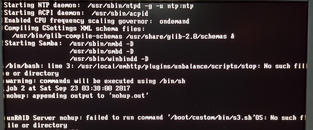

unRAID boot screen
I see these warnings every time I start unRAID:
1:) unbalance plugin (bin/bash: line 3:... etc.)
2:) warning: commands will be executed using bin/bash
3:) nohup: appending output to 'nohup.out'
4:) nohup: failed to run command '/boot/custom... etc.)
I'm including a diagnostics report as well in the hopes it will help...

The unabalance line, look for updates to unbalance, or post in it's support thread.
The nohup lines, looks like you've got (if I was going to guess) the s3 sleep plugin set to run a command at startup (located at /custom/bin on the flashdrive), and it doesn't exist.
I don't know "s3.sh" but for sure it isn't related to the dynamix s3 sleep plugin.
Check your 'go' file, it may have outdated commands.

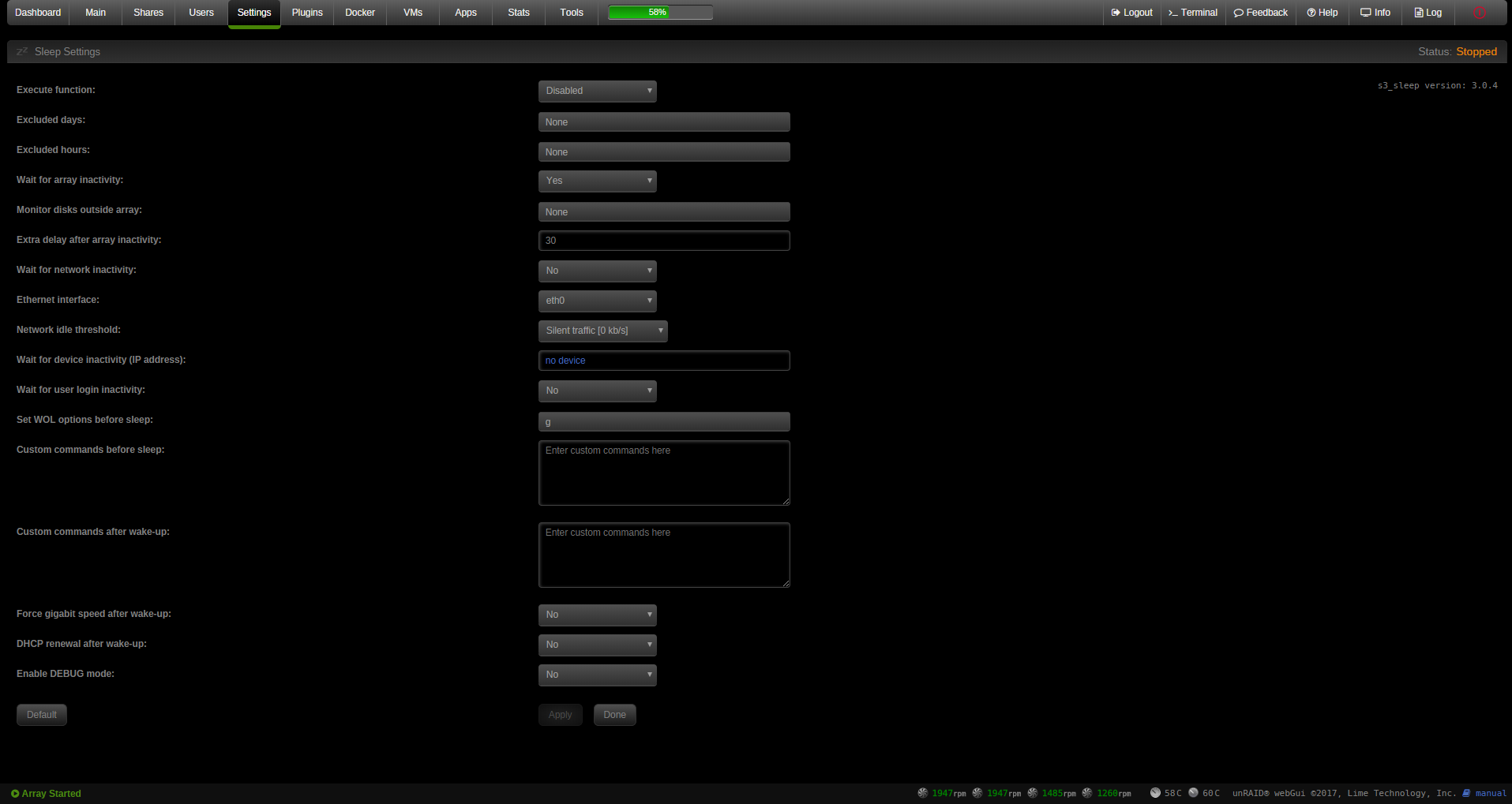

I don't have sleep enabled (via the settings), as it doesn't seem to work well with my system, and here is the contents my 'go' file:

5 minutes ago, RGauld said:
I couldn't find a "/custom/bin/" directory on the flashdrive either...
That's why it was giving the error.
That script is being referenced somewhere.  (not in go).  No idea where, but its probably not an issue.  You'd have to go through everything to try and find the reference.
