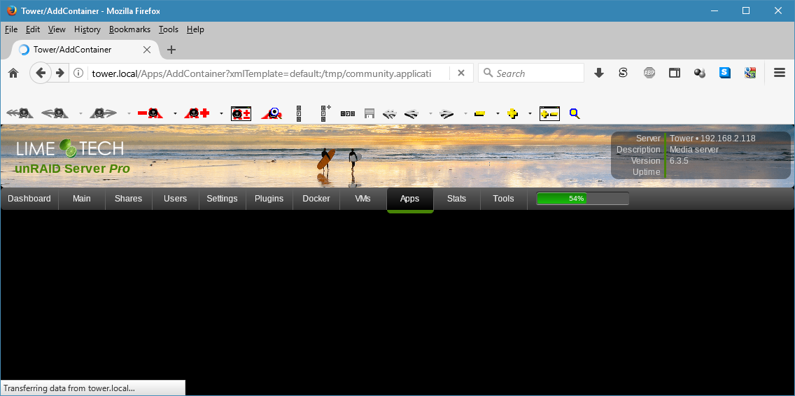

I started out three days about doing a backup (7TB of data) onto some USB hard drives using unassigned devices. I was using the Krusader plug in and that worked fine for the first two days where it was writing to the drives at 100mbs+ I then started the next few folders (1.5TB) onto another USB hard drive, turned off my main PC and then went to bed. I woke up this morning and there was no drive activity, but when I went to the web browser for tower.local it was VERY slow to the point nothing would load

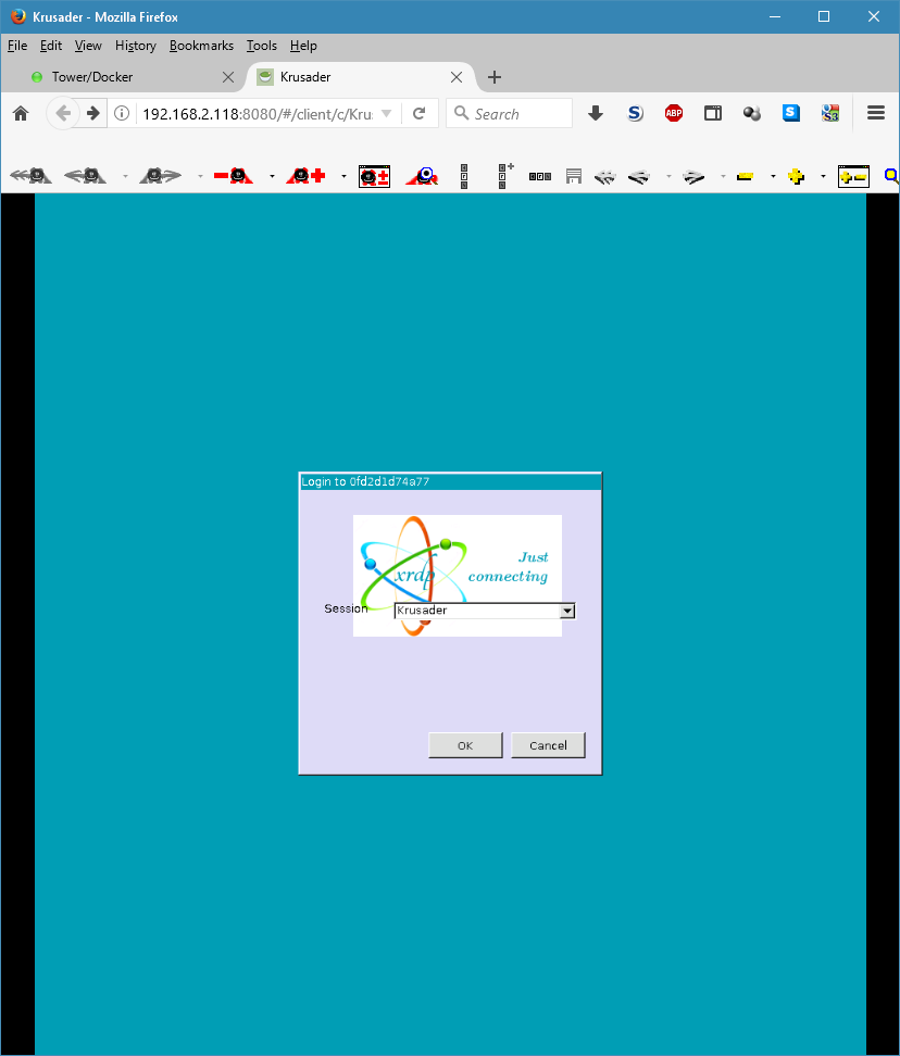

I have tried to reboot the krusader docker, then the login window to krusader locks up on the same screen!Untitled.thumb.png.3cf7aa37fa21b033332d17df14a4a724.png

Now im looking at the front of the tower and it seems to have disk activity on one drive for 5 mins and then will jump to the next drive for another few mins. it then does this for some more disks and then the web browser GUI will come back to life
