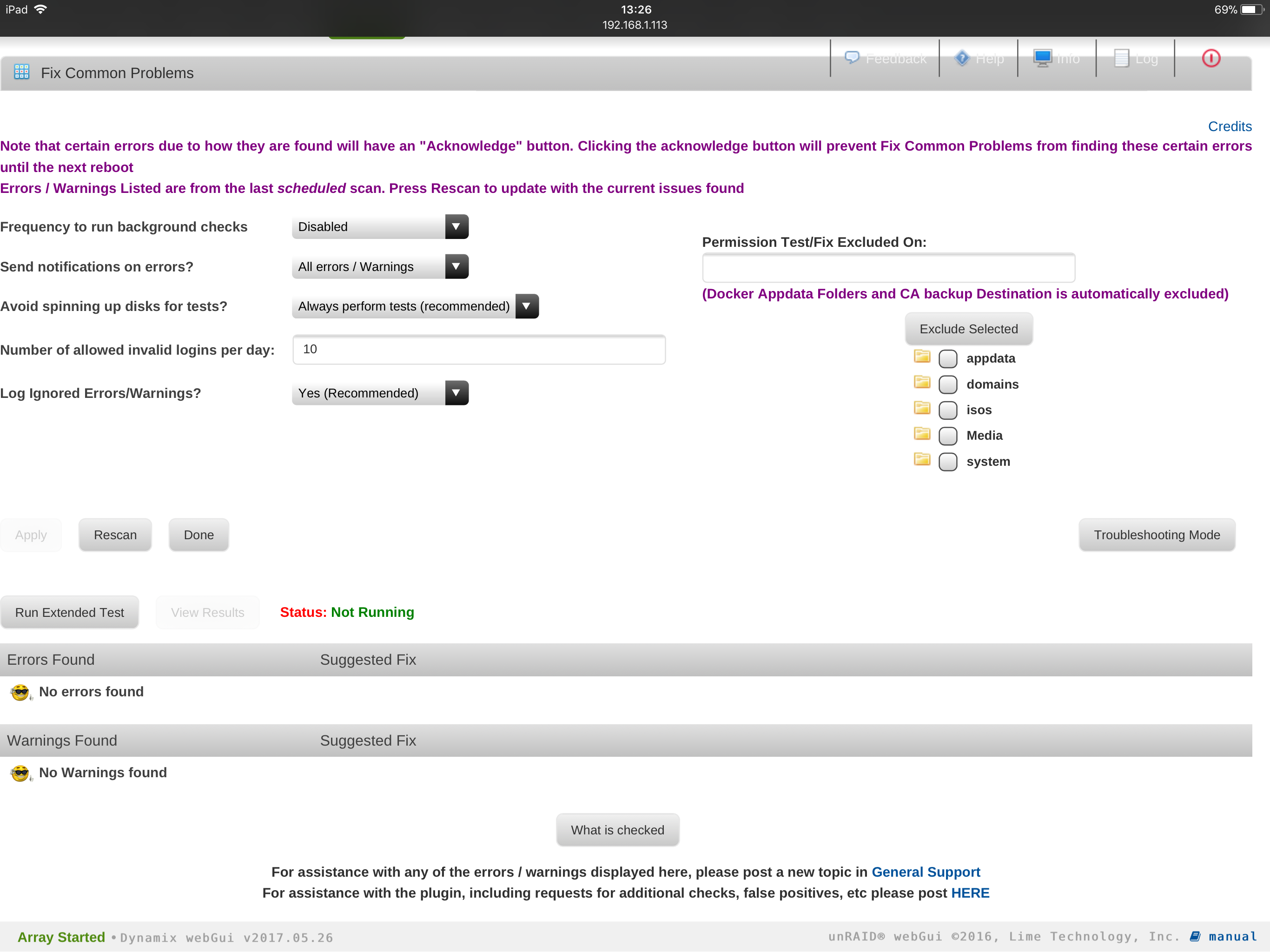

You might want to check out if the Fix Common Problems plugin is finding  issues and address each one.
I’ve done that but it’s reporting no errors?
Million reasons why FCP could take that long.  Depends upon the spin up avoidance setting in FCP, write checks to all the drives, etc....

Thanks guys, I’ll uninstall FCP and feed back
