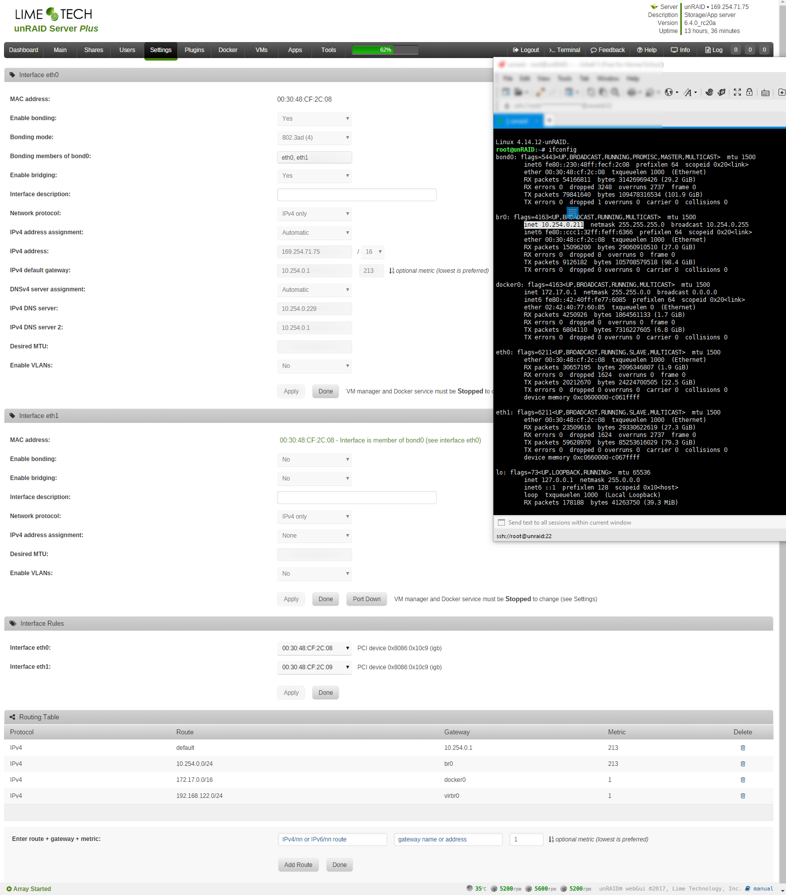

unRAID is using DHCP and successfully gets IP/subnet/gateway/DNS assignments from the DHCP server, but on the network page it lists an APIPA address for br0 with correct subnet/gateway/DNS settings.  This incorrect address is also used by unRAID for things like docker webui links, etc.
I use 802.3ad bonding and have bridging enabled if that makes any difference. IPv4 only.
You can see from my screenshot that unRAID is in fact accessible by the IP it gets from the DHCP server and not the one displayed in the network settings.

Looks like the GUI went out of sync. Can you do
create_network_ini
And refresh the network page.
create_network_ini
That worked temporarily, but the problem reappeared after reboot.

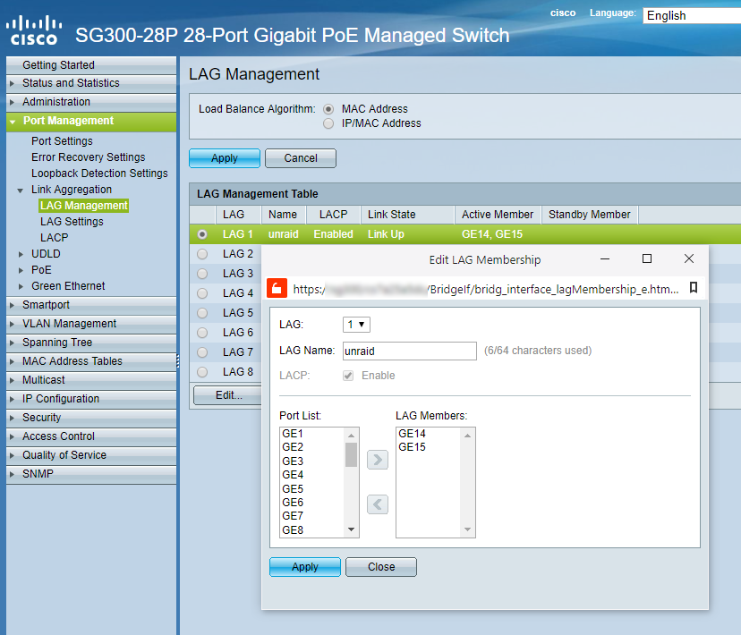

Does your switch support LACP?
It looks like initial bonding doesn't work properly. You can test by changing the bonding mode, e,g use mode 1 (active-standby).

Yes, it supports LACP and bonding is working correctly.  I didn't have this issue with 6.3.

Bonding works fine for me on 21b - I'm using a HP 1920-24G switch with 802.3ad bonding.

Change bonding to mode 1 (active-backup) and removed aggregation setting on those switch ports: unRAID displayed correct IP address
Changed bonding mode back to 4 (802.3ad) and reconfigured switch:  issue came back
