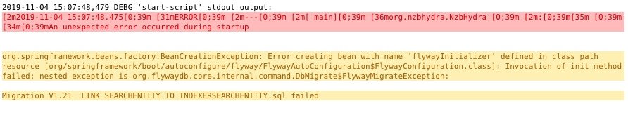

  • I will take a look at the issue tonight guys. If you want to roll back then see link to documentation in first post, then unraid faq. Sent from my CLT-L09 using Tapatalk

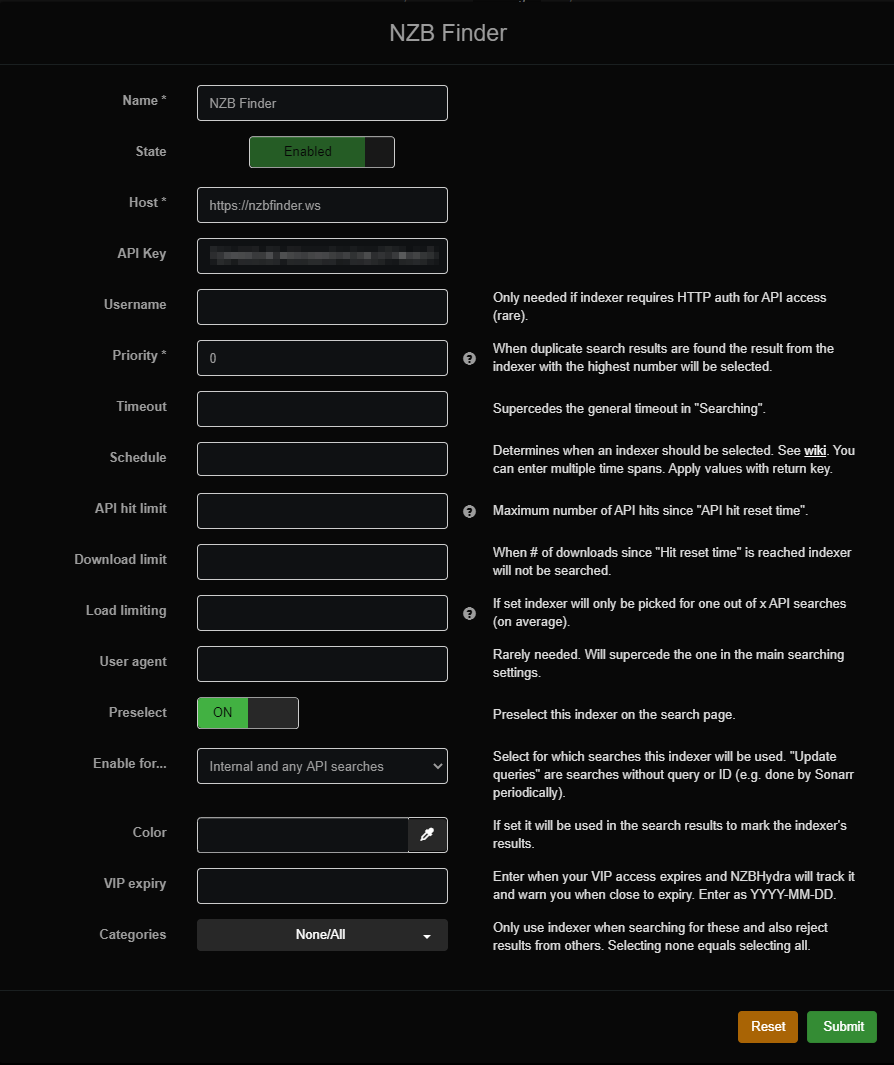

Hey there,
I'm unable to add any NZB indexers into NZBHydra, even though all of my torznabs are working fine and imported from Jackett perfectly.
This is the error I'm getting.
I've tried with the 2 NZBIndexers I use, NZBPlanet and NZB Finder, but neither one seems to be working.
The config panel on both is pretty much identical, just their respective API URLs and Keys, everything else is left blank:
Any ideas what could be causing this error? Happy to upload logs if that helps.

I'm having the same issue as you with my two indexers. Hopefully, someone can assist!
Funny enough NZBPlanet has since resolved itself for me, and for NZBGeek I eventually got it working by adding my username/password as a backup method if API calls failed. For NZBPlanet I'd just suggest removing it, updating the container, and re-adding it.
Indexers (including NZBGeek) have also stopped working for me; removing and re-adding them doesn't help.  Hydra seems unable to connect to any.  This is a new problem for me, and historically have had few issues with this setup.
Edit:  It seems disabling proxy settings in NZBHydra solved the issue for me, though I would still love to send my search requests through a VPN...

I am getting this error when the docker starts. It had been working flawlessly for ages.
Any ideas on the problem, or solution?

I updated to latest and now docker does not start
2023-01-23 06:52:31,240 DEBG 'start-script' stdout output:
2023-01-23 06:52:31.234 ERROR --- [              main] org.nzbhydra.NzbHydra                    : FATAL: An unexpected error occurred during startup:
org.springframework.beans.factory.BeanCreationException: Error creating bean with name 'flywayInitializer' defined in class path resource [org/springframework/boot/autoconfigure/flyway/FlywayAutoConfiguration$FlywayConfiguration.class]: Found non-empty schema(s) "PUBLIC" but no schema history table. Use baseline() or set baselineOnMigrate to true to initialize the schema history table.
        at org.springframework.beans.factory.support.AbstractAutowireCapableBeanFactory.initializeBean(AbstractAutowireCapableBeanFactory.java:1751)
        at org.springframework.beans.factory.support.AbstractAutowireCapableBeanFactory.doCreateBean(AbstractAutowireCapableBeanFactory.java:599)
        at org.springframework.beans.factory.support.AbstractAutowireCapableBeanFactory.createBean(AbstractAutowireCapableBeanFactory.java:521)
        at org.springframework.beans.factory.support.AbstractBeanFactory.lambda$doGetBean$0(AbstractBeanFactory.java:326)
        at org.springframework.beans.factory.support.DefaultSingletonBeanRegistry.getSingleton(DefaultSingletonBeanRegistry.java:234)
        at org.springframework.beans.factory.support.AbstractBeanFactory.doGetBean(AbstractBeanFactory.java:324)
        at org.springframework.beans.factory.support.AbstractBeanFactory.getBean(AbstractBeanFactory.java:200)
        at org.springframework.beans.factory.support.AbstractBeanFactory.doGetBean(AbstractBeanFactory.java:313)
        at org.springframework.context.support.AbstractApplicationContext.getBean(AbstractApplicationContext.java:1130)
        at org.springframework.context.support.AbstractApplicationContext.finishBeanFactoryInitialization(AbstractApplicationContext.java:905)
        at org.springframework.context.support.AbstractApplicationContext.refresh(AbstractApplicationContext.java:584)
        at org.springframework.boot.web.servlet.context.ServletWebServerApplicationContext.refresh(ServletWebServerApplicationContext.java:146)
        at org.springframework.boot.SpringApplication.refresh(SpringApplication.java:730)
        at org.springframework.boot.SpringApplication.refreshContext(SpringApplication.java:432)
Caused by: org.flywaydb.core.api.FlywayException: Found non-empty schema(s) "PUBLIC" but no schema history table. Use baseline() or set baselineOnMigrate to true to initialize the schema history table.
        at org.flywaydb.core.Flyway.lambda$migrate$0(Flyway.java:166)
        at org.flywaydb.core.FlywayExecutor.execute(FlywayExecutor.java:204)
        at org.flywaydb.core.Flyway.migrate(Flyway.java:128)
        at org.springframework.boot.autoconfigure.flyway.FlywayMigrationInitializer.afterPropertiesSet(FlywayMigrationInitializer.java:66)
        at org.springframework.beans.factory.support.AbstractAutowireCapableBeanFactory.invokeInitMethods(AbstractAutowireCapableBeanFactory.java:1797)
        at org.springframework.beans.factory.support.AbstractAutowireCapableBeanFactory.initializeBean(AbstractAutowireCapableBeanFactory.java:1747)
2023-01-23 06:52:37,764 DEBG 'start-script' stdout output:
2023-01-23 06:52:37,764  ERROR - Main process shut down unexpectedly. If the wrapper was started in daemon mode you might not see the error output. Start Hydra manually with the same parameters in the same environment to see it
2023-01-23 06:52:37,777 DEBG fd 8 closed, stopped monitoring <POutputDispatcher at 23241208409072 for <Subprocess at 23241208404080 with name start-script in state RUNNING> (stdout)>
2023-01-23 06:52:37,777 DEBG fd 10 closed, stopped monitoring <POutputDispatcher at 23241208409024 for <Subprocess at 23241208404080 with name start-script in state RUNNING> (stderr)>
2023-01-23 06:52:37,778 WARN exited: start-script (exit status 255; not expected)
2023-01-23 06:52:37,778 DEBG received SIGCHLD indicating a child quit
i have confirmed the image is ok by simply starting from a blank config and the web ui starts up no issue, so i would suspect this is a database corruption issue, probably best raising an 'issue' on github:- https://github.com/theotherp/nzbhydra2/issues
How can I revert back to previous image because it worked fine?
Edited by Blade
