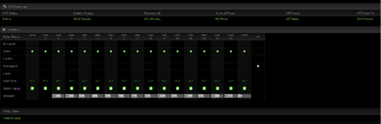

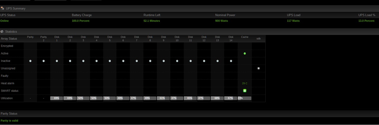

Here are some pics with the UPS running on my server. Just the server, 8 port switch, and a fan.

*edit* for an unknown reason, the HDDs seemed spinned down, this never happened before, do you know what might caused that?! the only thing that I did was to make the array starts automatically...

The one thing you want to check is the actual runtime at the expected load.  I would probably use 140W in your case.  The reason for looking at the spec is that the battery is heavy and probably the most expensive component in the UPS.  You usually have to go to the Manufacturer's website and find the specs that will show this number.   BTW, they will often use the same battery in several models in the product so the runtime at any specific power level are the same for those models.  The only difference is the components in the switching transistors and their setup.
