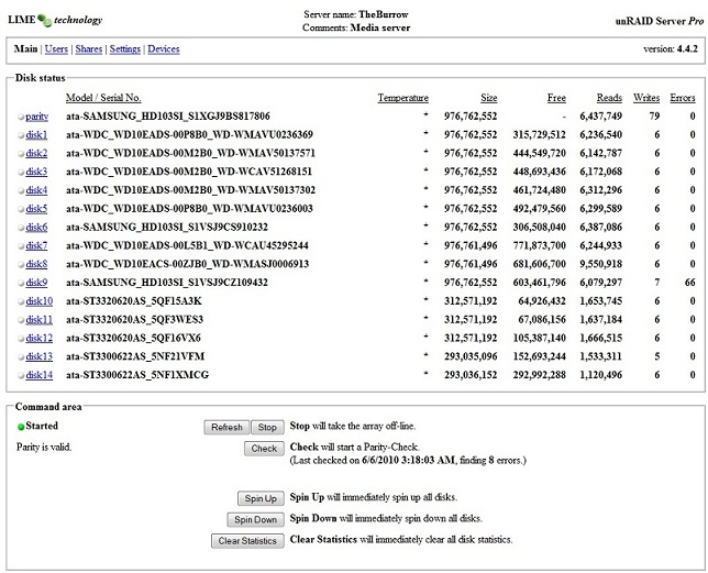

Recently I had some internet issues which required a long powerdown of my router. When I powered backup I couldnt contact my unraid server so had to hit the power button on the server initiating an unclean powerdown.
When I powered it back up it started doing a parity check as expected. It quickly found 8 Parity Sync errors before i could even load the web interface. It didnt discover any more Parity Sync errors after that though. However when it did finish the parity check it came up telling me there were 66 "Errors" on drive 9.
I havent had time to do anything else with the server since this happened as i've been out of town but there have been no writes to the array since the errors occured for fear of losing/corrupting any data.
Attached is a zip of my syslog (which has a heap of DHCP stuff at the bottom so you will need to scroll up to the date where the errors occured - 6th June) as well as a screen shot of the web interface showing the errors.
Also I noted that Disc 8 took approximately 50% more reads to do the parity check compared to all the other discs - 9.5 million-ish reads on disc 8 versus 6 million-ish on all the others of the same size. Is this normal or signs of something wrong with that drive as well as Disc 9?
Any of the unraid guru's able to have a look at my log/shot and suggest what actions I should be taking from here to get my system working a-ok again please? I'm not sure where to start or what to do without risking my data.

Hopefully you've already resolved this by now, but just in case:
With those read errors on disk 9 in the log, I'd immediately move the data off of that drive onto others - you appear to have plenty of free space to accommodate it.  You could either use Midnight Commander from within a telnet session to the server, or use the disk shares (\\tower\disk9 for example) and move the data that way.
Then once that data is safe, follow the instructions here - http://lime-technology.com/wiki/index.php?title=Check_Disk_Filesystems  to check the filesystem on drive 9, as well as a smart report - http://lime-technology.com/wiki/index.php?title=Troubleshooting#Obtaining_a_SMART_report
Depending on the results of those, you can either start using the disk again or replace it.
Start with doing the SMART report. Post the results before plotting next step.

Your smart report looks fine - although looks like you are keeping the drive is an icebox!
Usually problems with a drive with clean SMART reports turn out to be some sort of cabling / drive cage connection issue.  These are usually accompanied, however, with logged errors which show up at the bottom of the SMART report.  (This makes sense because if the signal between computer and drive is not clean, the drive will be getting corrupted requests that it does not know how to process.  These are logged by the drive.)  However, your SMART report has no such logged errors.  I still think that the drive connection is your most likely culprit.
I would suggest checking to ensure that the SATA cable is connected securely on both the "computer end" and disk end.  Sometimes just unplugging and replugging a cable can dislodge an obstruction causing intermittent problems.  Or you might want to just replace the SATA cable with a new or known good cable.  Locking SATA cables can be helpful.  I have a motherboard SATA port that is a little loose and if I try to use a regular SATA cable it gives problems.  Using a locking cable was my solution.
If you are using drive cages the problem may be in the internal wiring / connections within the drive cage.  You might try moving the drive to a different location and see if it resolves.
Good luck. Let us know how it goes!

As an update to my problem above, I broke the server down over the weekend, replaced the SATA cable to the drive and reseated the cradle for the drive in the backplane. After I fired it back up I ran a parity check and 5ish hours later all it came up with no sync errors and no drive errors. So I'm not sure if it was a failed SATA cable or the caddy had a connection issue but it all appears to fine for now. Will definitely be running more regular parity checks from now on.
