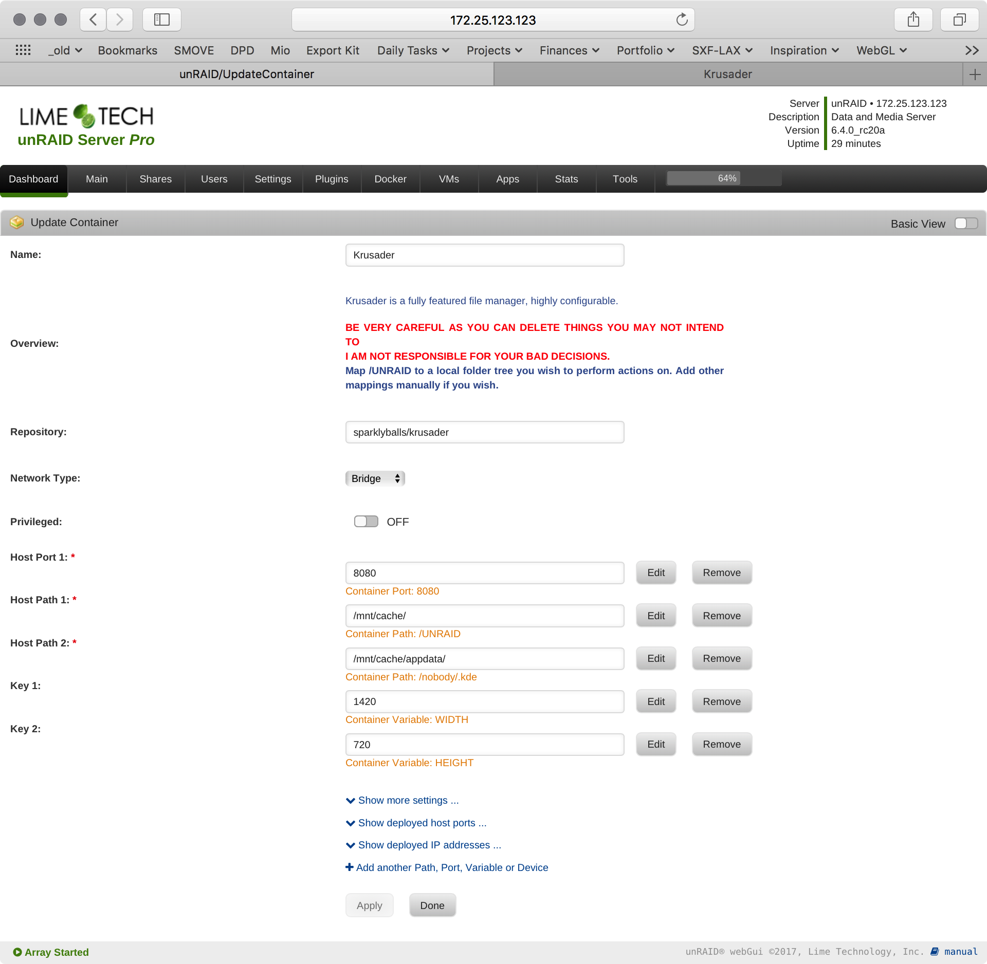

my Krusader Docker alerted me that I had to recreate the Docker Image due to a bug in an earlier version of unRAID v6.
after re-creating the Docker with what I thought to be the correct parameters, it starts up fine, but when I go into the "unRAID" folder in Krusader now, I only see the app data, docker, domains, isos and system Shares, but not my disk and user shares anymore, like I did before.
what did I do wrong?
I tell ya, it's one thing after another...
You're mapping /UNRAID to /mnt/cache instead of /mnt/user
Change host path 1 to /mnt/ instead of /mnt/cache/, and host path 2 to /mnt/cache/appdata/krusader/
/mnt/
got me back to where I was...thanks!

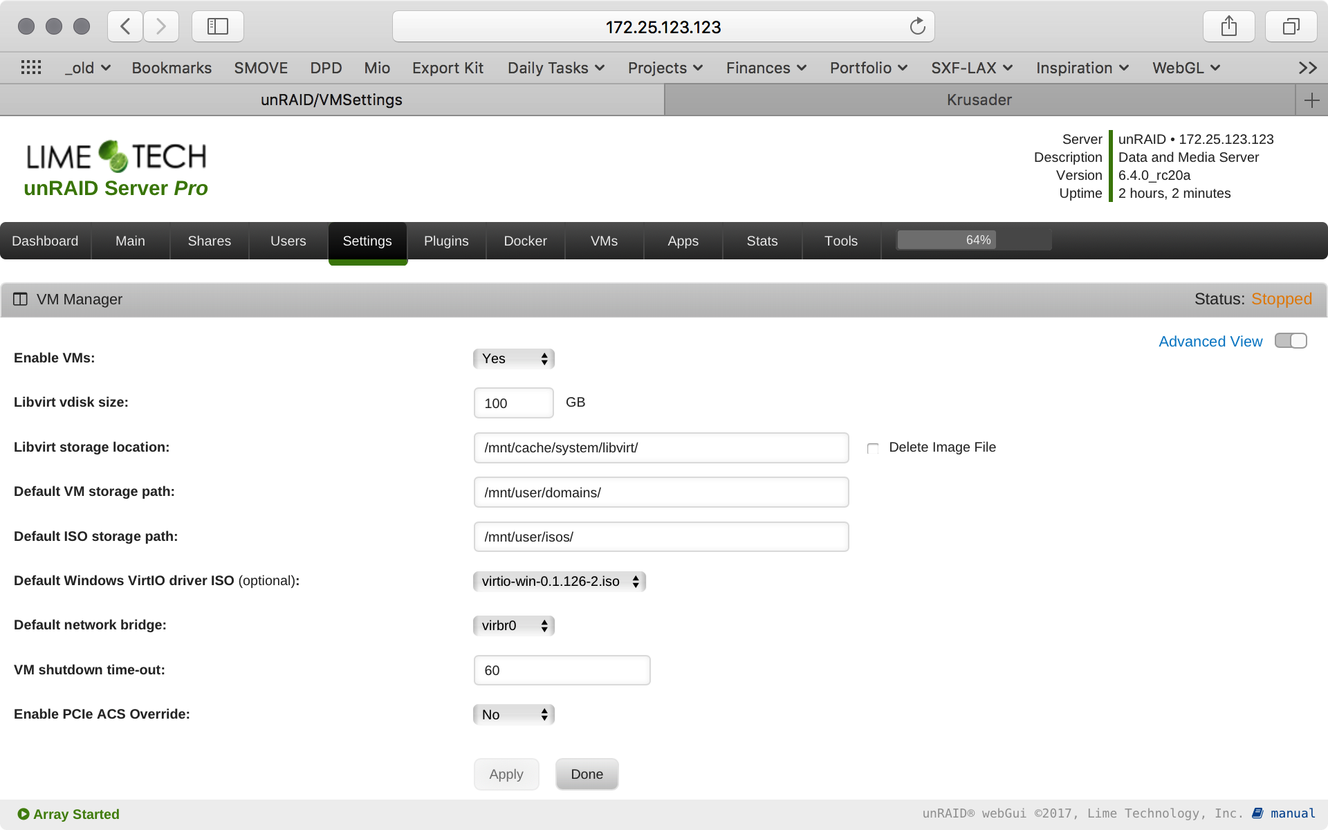

Libvirt storage is pointing to a dir, not the image, e.g.: /mnt/cache/system/libvirt.img
I corrected that, stopped and restarted the array, but VM Manager still shows as "Stopped"...what am I missing here?
it worked beautifully before I did the cache swap...but my inexperience with these matters is glaring.
do I need to delete the old libvirt.img and let it re-create that file, perhaps? I had moved the old one over to the new SSD cache manually.
If you move it manually it may be corrupt, syslog will show.
apparently so...I deleted libvert.img and recreated it through the unRAID GUI and now the VM Manager is running again.

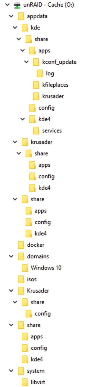

does making all of these folders run off the SSD potentially cause any conflicts with each other? I mean, I know an SSD is very different from a spinner, where trying to access files in different places on a platter can cause the head(s) to not work efficiently anymore, but is it ok for all of them to be on the SSD? do any of them *not* benefit from being on the SSD and could just as well be moved back onto disk1 (if only to make more space on the SSD)?
- appdata
- docker
- domains
- isos
- Krusader
- share
- system

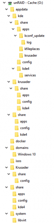

Not sure why you ended up with all that on your cache drive, I think you may have separated some stuff out to root folders that is normally in subdirectories.
isos for sure could be set to cache:yes instead of prefer, the other folders I'd need to see content to have an idea what happened and whether they need to be moved. Krusader should be under appdata, if you set the krusader docker to /mnt/cache/appdata/krusader and before it was set to /mnt/cache/Krusader that would explain that folder.
For neatness sake you could have the docker img file and libvirt img file both in the system folder.
Did you keep the 100GB setting for libvirt.img? That is freakin' HUGE, I have 126MB used in a 1GB allocated libvirt.img file with 10 VM's currently defined.

I ended up with all of that on my cache drive by going it there, manually (for the most part)...I guess you have noticed that I make a lot of mistakes, still, and am very green behind the ears with all of this VM stuff (and much of the inner workings of unRAID itself)...so it's very likely that I moved a few folders onto the SSD in less than correct ways...I attached a screen grab of all folders open to reveal their sub-folders.
so, the isos should definitely reside there, which is what I've read elsewhere as well.
I see that the "share" folder in the root is the same as the one inside of "krusader"...can I delete it from the root, manually?
I deleted the "Krusader" folder (it was empty, save for the "share" and "config" subfolders, which were also empty) moved "krusader" inside of appdata, all manually (or should I not have done that)?
how would I go about moving the docker image into the system folder without breaking anything?
same regarding the huge libvert I have...how do I go about reducing that down to the same 1GB you have without breaking anything?
you da best!
How many dockers do you have installed? It appears that you may have installed krusader a bunch of times, specifying a different config location each time. All but the current config should probably be deleted.
You could also delete your current docker.img and set it to /mnt/cache/system/docker/docker.img with a size of 5GB, and delete the docker folder in the root.
If krusader is your only docker, maybe the best thing to do would be to remove it, then clean out all the leftover junk, then reinstall it to /mnt/cache/appdata/krusader/
When I said set the isos share to cache:yes instead of cache:prefer, that setting will move the isos share to the array disks, following any rules set for the isos share. There is no need for it to take up space on the SSD.
Since you only have 1 VM, the easiest thing to do would probably be to save the XML text from the edit XML screen, delete and recreate the libvirt.img file with the settings you want, then create a new VM and paste in the XML to recreate the VM.
Your tree graphic is very hard for me to follow for some reason, I can't quickly determine which folders are at the root. I think I interpreted it correctly though.
If you allow mover to relocate isos to the array, then the only permanent root folders on the cache drive would be appdata, domains, and system. Any other folders would be created and moved automatically to the array by data written to shares that are set to cache:yes
