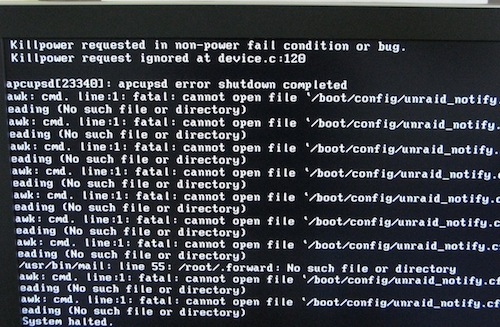

I have been having troubles lately when I powerdown my system from the Powerdown button within the unraid interface. I have APC installed and working fine as well as powerdown and unraid notify.
Specifically, when I hit the button to shut everything down after stopping the array the system goes through it's powerdown procedures and then never actually turns off. It seems like this began happening after installing unraid notify; which does work properly as a side note. Or perhaps this is APC related?
Here's the error message on screen in the terminal mode:
Killpower requested in non-power fail condition or bug.
Killpower request ignored at device .c:120
apcupsd[23340]: apcupsd error shutdown completed
awk: cmd. line:1:fatal: cannot open file '/boot/config/unraid_notify.cfg for reading (no such file or directory)
/usr/bin/mail: line 55: /root/.forward: No such file or directory
System halted.
I would sincerely appreciate any assistance in correcting this issue so that my system will powerdown properly. I have no idea what might be going wrong.
Thanks...
**Error Screen Photo Attached**

The script I wrote for unMENU adds a command to invoke killpower to the end of /etc/rc.0 if you are not rebooting.  It is being ignored since you are not in a power fail mode.  You can ignore those messages, they are quite normal and usually you would not see them since the server would power itself down in the next command.
It sure looks like unraid_notify is looking for the unraid_notify.cfg file, and it does not exist.  That again does not look related to your problem, but depending on if you edited /etc/rc.0, it might.

You did not say how you installed apcupsd.  unMENU does what it need to do to invoke killpower, but immediately after that command is the one in /etc/rc.0 to power down the server. (but that won't work completely unless ACPI is enabled in the BIOS)
Also, I'm not sure what you mean by me editing the /etc/rc.0 - how would I have done this or would it have had to be something I knew what I was doing?
It was done for you when you installed apcupsd through unMENU.
Also, I have confirmed that the unraid_notify.cfg file does exist in the /config folder - and since it does send emails right now then it must be working properly right? Why would this error message be showing that the file doesn't exist when it actually does? Any Ideas on this?
No, you'll have to ask its author.
