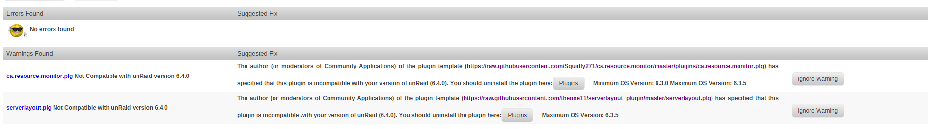

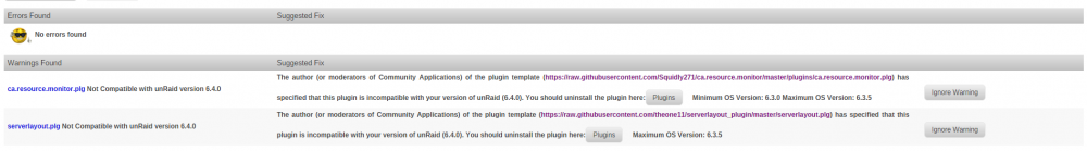

7 minutes ago, dlandon said:
Take a look at fix common problems.  You have issues to sort out.
What issues are you seeing?  This is all I got:
1 hour ago, Pauven said:
Is that a thing?  All I know is I needed the kvm_intel.netsted=1 statement to allow VMWare images to play inside a Linux VM, and it works even on my Ryzen box.  Without this option, the passed through CPU reports no VM capabilities.
But I'll look into it further, maybe the AMD version would work even better...
Can't find the page I saw earlier that said to exchange Intel with and, but here is a link to jonp suggesting the same.
https://lime-technology.com/forums/topic/40927-nested-virtualization/?tab=comments#comment-420127
7 minutes ago, johnnie.black said:
Likely the S3 plugin
Interesting.  I did have this set to suspend after 30 minutes of inactivity on the server.  But I now realize that the VM is on an unassigned device which has not been selected to be monitored.  However, this was note an issue on 6.3.5.  Any idea what changed between 6.3.5 and 6.4 which would cause this freezing issue now?
I believe I read in another thread about some compatibility issue with that plugin and v6.4, better to uninstall it until it's updated.
I just bought a pro license few days ago, and I'm on the latest stable release. I am only using my system as file storage, I have one plugin installed, the community one, and I might even remove it. Usually I wait for the next minor update, I don't jump on major updates. regarding meltdown, if I am not accessing my system remotely, and I don't surf the web through it...I believe I am safe, correct?
Thnx
Jan 14 17:12:02 unraid root: Fix Common Problems: Warning: Share vm set to not use the cache, but files / folders exist on the cache drive
Jan 14 17:12:08 unraid root: Fix Common Problems: Warning: ca.resource.monitor.plg Not Compatible with unRaid version 6.4.0
Jan 14 17:12:09 unraid root: Fix Common Problems: Warning: serverlayout.plg Not Compatible with unRaid version 6.4.0
Jan 14 17:12:11 unraid root: Fix Common Problems: Warning: Docker application headphones does not have the same webUI interface as what the template author specified ** Ignored
Jan 14 17:12:11 unraid root: Fix Common Problems: Warning: Docker application letsencrypt does not have the same webUI interface as what the template author specified
Jan 14 17:12:11 unraid root: Fix Common Problems: Warning: Docker application zoneminder does not have the same webUI interface as what the template author specified ** Ignored
Jan 14 17:12:14 unraid root: Fix Common Problems: Warning: Template URL for docker application binhex-delugevpn is missing.
Jan 14 17:12:14 unraid root: Fix Common Problems: Warning: Template URL for docker application DuckDNS is missing.
Jan 14 17:12:14 unraid root: Fix Common Problems: Warning: Template URL for docker application freshrss is missing.
Jan 14 17:12:14 unraid root: Fix Common Problems: Warning: Template URL for docker application headphones is missing.
Jan 14 17:12:14 unraid root: Fix Common Problems: Warning: Template URL for docker application hydra is missing.
Jan 14 17:12:14 unraid root: Fix Common Problems: Warning: Template URL for docker application jackett is missing.
Jan 14 17:12:14 unraid root: Fix Common Problems: Warning: Template URL for docker application letsencrypt is missing.
Jan 14 17:12:14 unraid root: Fix Common Problems: Warning: Template URL for docker application mariadb is missing.
Jan 14 17:12:14 unraid root: Fix Common Problems: Warning: Template URL for docker application NZBGet is missing.
Jan 14 17:12:14 unraid root: Fix Common Problems: Warning: Template URL for docker application openvpn-as is missing.
Jan 14 17:12:14 unraid root: Fix Common Problems: Warning: Template URL for docker application plex is missing.
Jan 14 17:12:14 unraid root: Fix Common Problems: Warning: Template URL for docker application radarr is missing.
