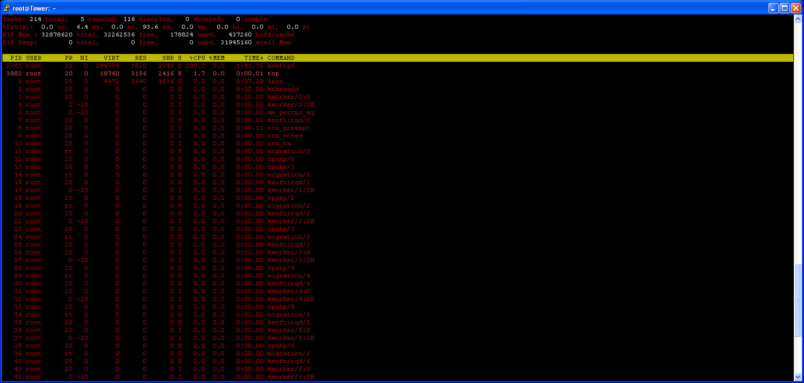

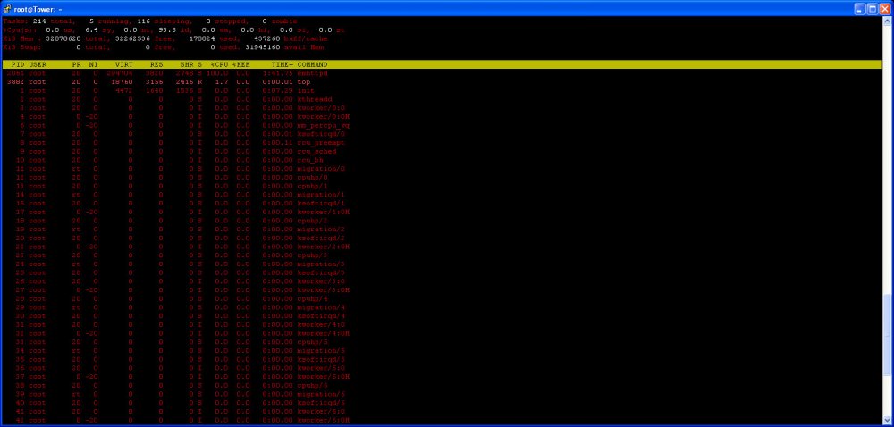

HI,
I started using Unraid for the first time with 6.4.0 Stable release .(On Ryzen 1700X/X370 Asus Prime)
USB booting is Ok,
The system just had one & only one new hard disk.(WD Datacenter)
I think I started the array, Unraid was telling that the hdd is unpartitioned/unformatted and such.
After that  I initiated a quick smart test & was clicking around the GUI,
Suddenly the Web interface got stuck, went to the putty/ssh session to check, ran top, saw a process @100% and then the ssh session go stuck too.
But ping to the Tower was responding.
Initiating a second ssh session did not help either. Had to hard shutdown & restart the machine.
Wondering what is going on...
Then later after a fresh reboot the hdd was formatted, Tried to create a Ubuntu VM & so on and then, the server was left on its own for an hour.
ping was running on the client machine & Tower was responding.
Then tried to refresh the unraid page, and then that was it.. Unraid got stuck.. Then ping also timed out.
Screenshot attached of 100% cpu use.
Client machine runs on XP & uses Firefox ESR & Putty to connect to Unraid Tower.
(Also had another issue where I started VirtIO download & then could not stop the array.. Had to kill the wget, so that it did not use the share.)
Guys.. any ideas for the above mentioned issue... ??
There are issues with Ryzen, try disabling "Global C-state control" in your bios.
