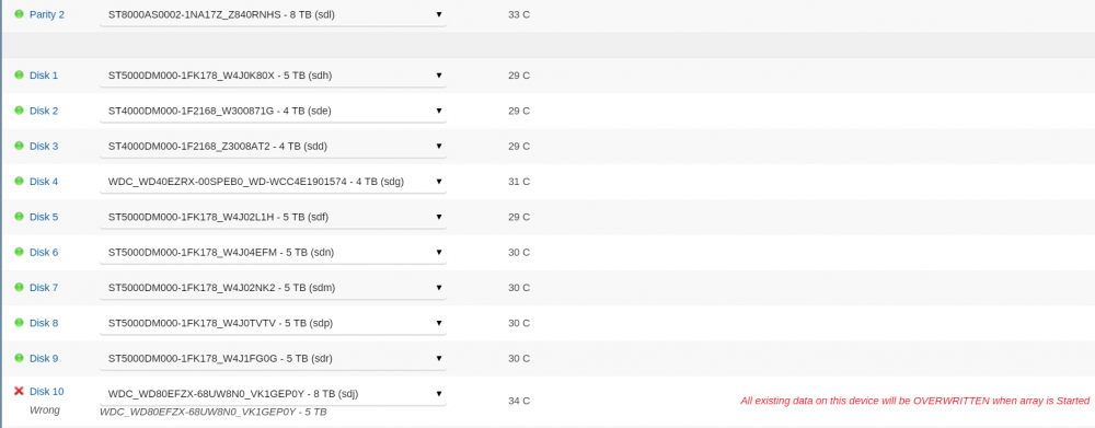

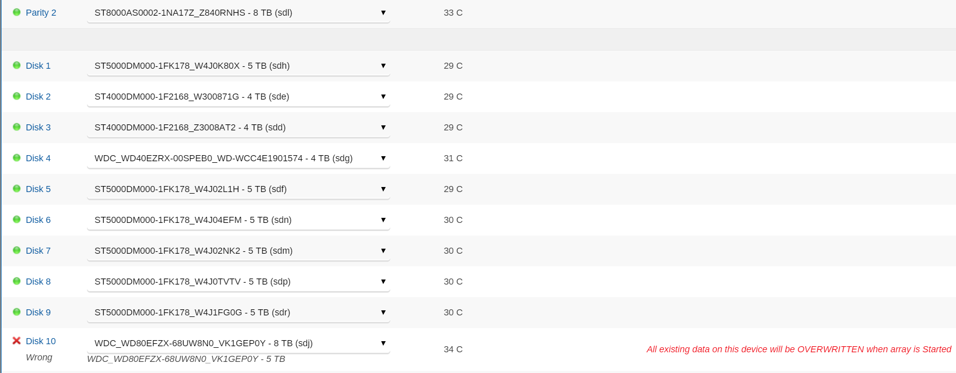

Ok another issue just happened to me though.
I did my sync of Drive 10 to an 8TB drive (All I have).
I just took the array offline to do what you said.  It's now telling me that it's expecting the drive to be 5TB in size, because that was the original drive size. However, I used an 8TB  drive to restore that drive.  What do I do now?
You just assign the 8TB drive and start the array, it will expand the file system.
It's telling me it will delete all the data?
That's ok?
4 minutes ago, tential said:
That's ok?
No, I though you were talking about disk9, post current diags.
OK, I think I know what happened, you replaced the old 5TB disk10 with the new 8TB while its status was invalid, so unRAID didn't consider a new disk and kept the original filesystem size, this can be considered a bug though it's an unusual situation.
Unfortunately this means you'll need to rebuild disk10 before replacing disk9, to be safer I would use a new disk (e.g. the one you were going to use to replace disk9) and keep the previously rebuilt one untouched until the rebuild is done, after it's done you use it to replace disk9.
