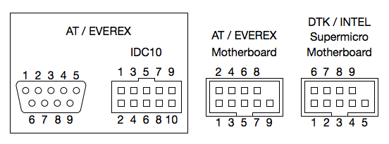

So the first thing you need to do is pickup a 9 pin serial male to IDC 10 pin female motherboard header adapter.  My local store had the StarTech PLATE9M in stock so I picked that one up.
This however will not work with my Supermicro motherboard and the reason for this is the fact that there are two different IDC10 header standards i.e. AT/Everex and DTK/Intel.  Turns out that Supermicro uses the latter DTK/Intel.  So to fix this, you either need to buy a different header in the first place or disassemble the DB9 connector from the plate and unsolder and re-solder the wires to their correct positions.  All the wires are in the wrong locations except Pin 1.  Also to note pin 1 on a ribbon cable is usually denoted by a red wire.

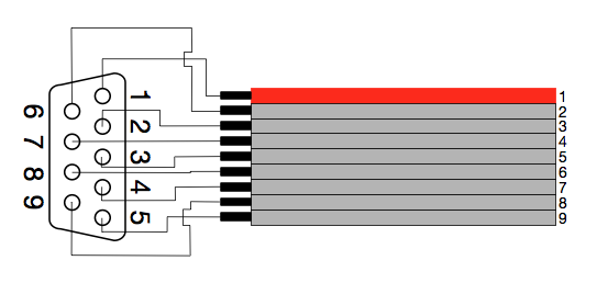

So to fix this, unsolder all the wires from the DB9 except for pin 1.  As mentioned earlier the red wire is pin 1, so if you bought the AT / EVEREX motherboard header connector then re-solder the pins as follows:
5a593bceca34d_ScreenShot2018-01-12at3_50_31PM.png.9ea19281e2095dff164308e575359391.png
Now that we have that out of the way, we can re-assemble our cable and attach it to the header and computer chassis.

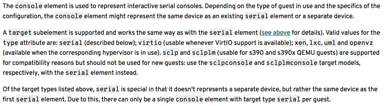

Now according to this documentation from Consoles, serial, parallel & channel devices and I will restate it here:
5a5941576dd2c_ScreenShot2018-01-12at4_12_21PM.thumb.png.05bb553830795ab7168e0198e75a853b.png
Now it's important to note that in the third paragraph we see that the console element in the xml file is tied to the first serial device in the same file.
