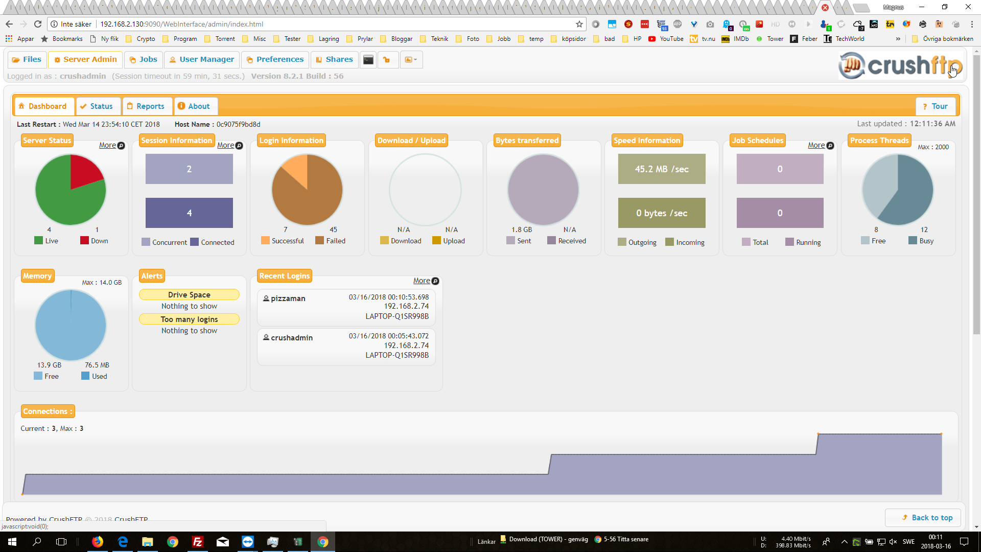

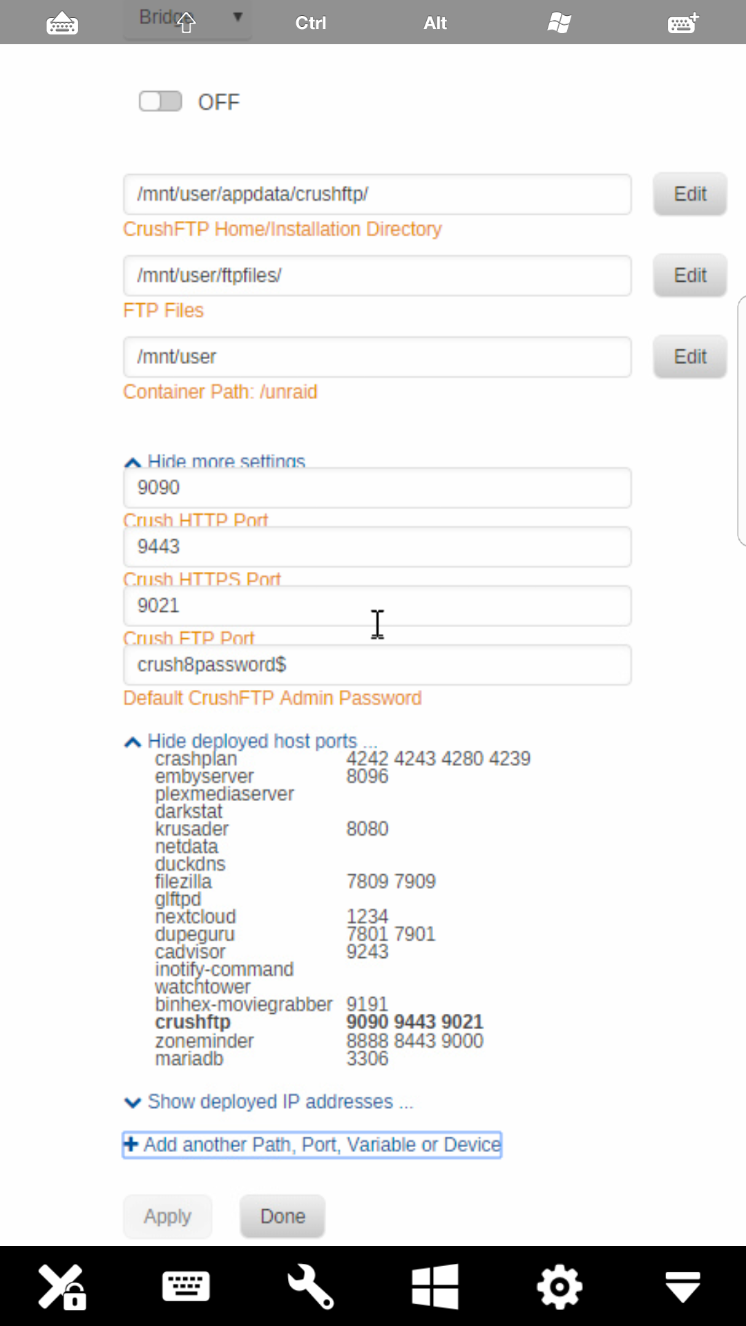

This is my settings :)
Just made some screenshots on my phone. Still in bed but got to go to work so let me know if you need better pictures.
Haven't had the time to play around with crush and forgot my password but did reset it yesterday and looked around and set the rest up inside crush like 2 hours before your post :P are you spying on me? ??
Really like the gui :)
Edited by PiZZaMaN
edit some typos
Just made screenshots in my phone. Still in bed but got to go to work so let me know if you need better pictures.
Really lik the gui :)
thx. for your help here, will try it out, as soon as i got a few hours time to do so. :D

Can't really remember at all but maybe crushadmin with blank password?
But in my screenshot that's a password in the dockersettings.

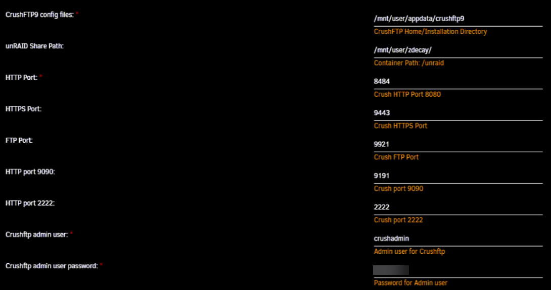

I've changed a few ports since I used them.image.thumb.png.ceb1438cf1f2299195480489698cc659.png
I've blurred my password, but the picture is my settings.
Because I'm going insane, I tried all 5 ports.
When I try to access one of them, I get:
This site can’t be reached X.X.X.X refused to connect.
Try:
Checking the connection
Checking the proxy and the firewall
ERR_CONNECTION_REFUSED
I tried restarting the docker, and the log says:
*** Booting runit daemon...
*** Runit started as PID 31
Oct 21 08:31:28 299e35538811 cron[35]: (CRON) INFO (pidfile fd = 3)
Oct 21 08:31:28 299e35538811 cron[35]: (CRON) INFO (Skipping @reboot jobs -- not system startup)
log4j:WARN No appenders could be found for logger (com.maverick.nio.Daemon).
log4j:WARN Please initialize the log4j system properly.
log4j:WARN See http://logging.apache.org/log4j/1.2/faq.html#noconfig for more info.
I don't know what to do to fix it. Can you help?
For some reason, it works in the old Microsoft Edge, Brave and FireFox, but not in Google Chrome. It works in Google Chrome incognito though.
I'm not planning on clearing cookies and cache again, I'm doing that too often now, but it might be something like that, or a weird setting somewhere.
Eitherway, my solution was another browser/incognito mode.
