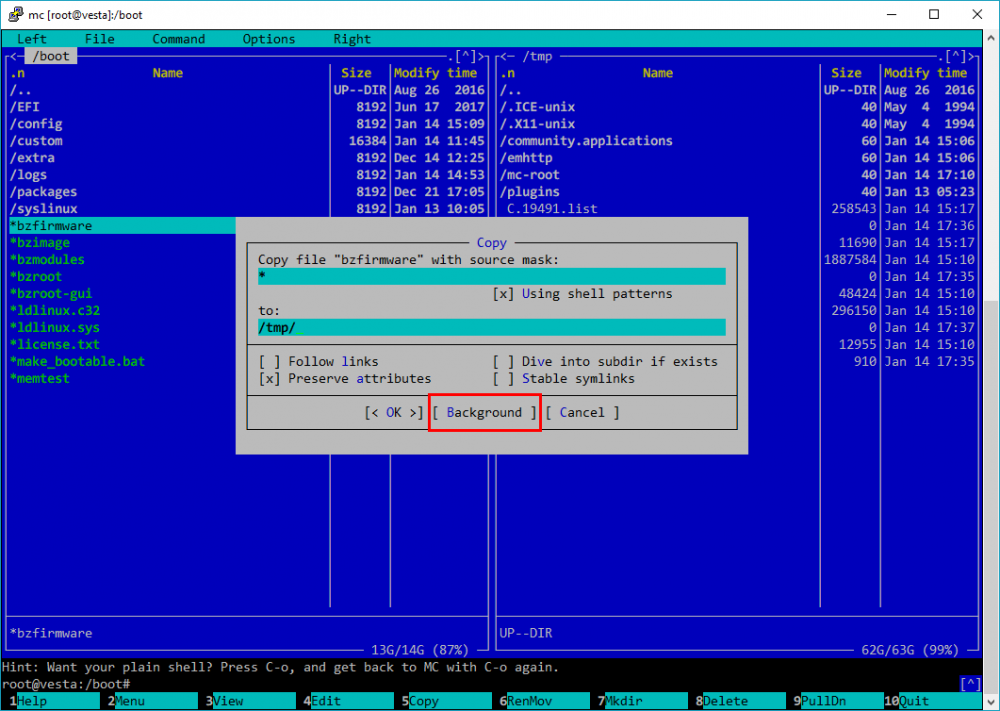

MMmm doesnt work..
As soon as i close puty on my laptop, the copying stops, although i clicked "background" in mc ... in that puty session on my laptop
I suppose that only works if i run mc, straight on the server...

only thin left is able to do it from my laptop
as soon as i exit puty, it stops copying although i clicked on "background" in mc (inside my puty session)

No, when you click on backgroud, MC creates a new background process which does the copying and continues when putty is closed.
how come i dont see the size of files copied increasing then?
dunno whats wrong, but it stops copying as soon as i close puty
Don't know either. I've used MC and background copying in the past to convert my array. Took about 10 days and surely putty wasn't opened all that time.

Is there any other way to copy files from disk to disk, without stopping copying when i disconnect?

you were using putty on another computer right?
Eureka! Its copying ! Using puty and "screen"
Once finished, how can i compare so i'm sure its good?
Just made a test and all is working fine (start background copy + terminate putty).
Since you have another working solution, just keep using that.
