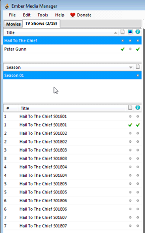

I'm having an interesting problem:  I'm using unRAID to store my media and Ember Media Manager (http:www.embermm.com) to organize the media.  It's working fine for the movies, but the TV shows are doubling up for some reason.  This is how I have it laid out:
unRAID\disk3\HB TV Files\Hail To The Chief\S01E01
unRAID\disk3\HB TV Files\Hail To The Chief\S01E02
unRAID\disk3\HB TV Files\Hail To The Chief\S01E03
unRAID\disk3\HB TV Files\Hail To The Chief\S01E04
unRAID\disk3\HB TV Files\Hail To The Chief\S01E05
unRAID\disk3\HB TV Files\Hail To The Chief\S01E06
unRAID\disk3\HB TV Files\Hail To The Chief\S01E07
unRAID\disk3\HB TV Files\Peter Gunn\101
unRAID\disk3\HB TV Files\Peter Gunn\102
For those unfamiliar with this stuff, these are the way Ember recognizes the seasons and episodes.  You can include an S and E or not, it doesn't care.  But when I point Ember to these file paths I get each episode twice.

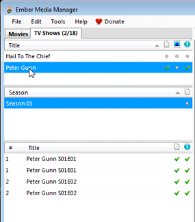

But I did notice that one of these episode listings apparently is a phantom.  There's a feature in Ember that allows you to load the file and scan through it. But the file only comes up on the second of the two listings.
Now I think this is an unRAID issue because I just added another networked source located on my iMac instead of the unRAID server and Ember sees it accurately, no duplication.
Any ideas?
I'm including pics of Ember doubling the episodes.

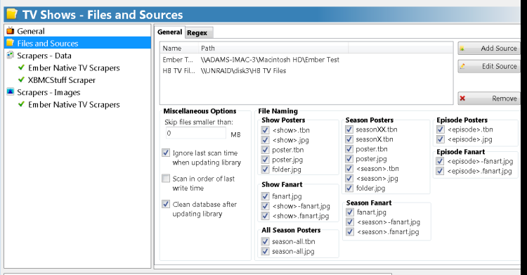

Can post a screen from Edit >> Settings >> TV Shows >> Files and Sources ??
If an "ls -al" does not show it listing twice, then it is certainly not an unRAID issue, but an application issue.
gfjardim, OK, here's the pic of the sources page.

First, you must set only the UNRAID path (can't you access it through "//UNRAID/HB TV Files"?) , then you must, in Tools, run "Clear All Cache" and "Clean Database".
After that, click "Update Library".

I had a similar problem with Ember, but it was because I used \\MOVIES rather than adding each disk, \\Disk1, \\Disk2.

It's always a good idea to learn and understand what you are using. For example, it's also not a very good approach that you have enabled every single accompanying file types in EMM. This doesn't help.
