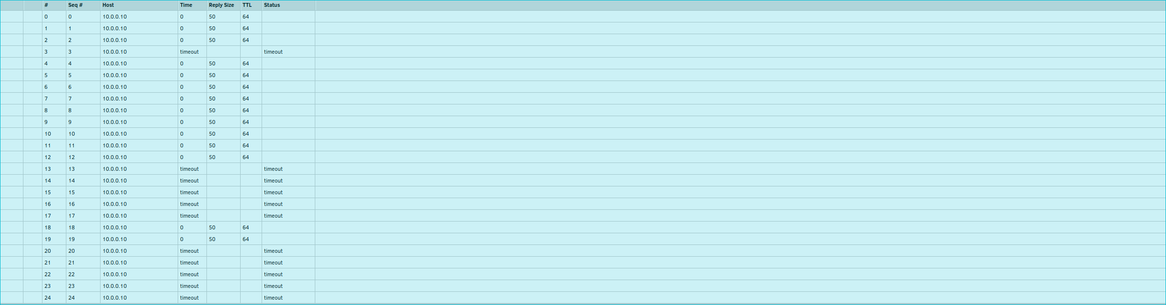

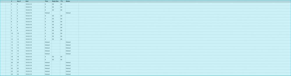

I have a mikrotik hEX router, which includes a handy little ping tool so I pinged the unRAID server.  As I suspected, there is some serious packet loss from the router to the unRAID server.  I've attached an image showing how bad it is.  It isn't rhythmic at all, just random packet loss from what I can tell.  It's upwards of 40% sometimes.

Thanks for the reply bonienl.  I updated the post while you were typing this reply.  I've tried swapping the port and ethernet cable with no luck.  I just tried pinging my server from my desktop and had 30% packet loss.  However, I thought I'd ssh into the unRAID server and try pinging my desktop, and the packet loss was very minimal; 3% after about 3 minutes.  I don't think that is considered "acceptable", but it's certainly better than 30%.
