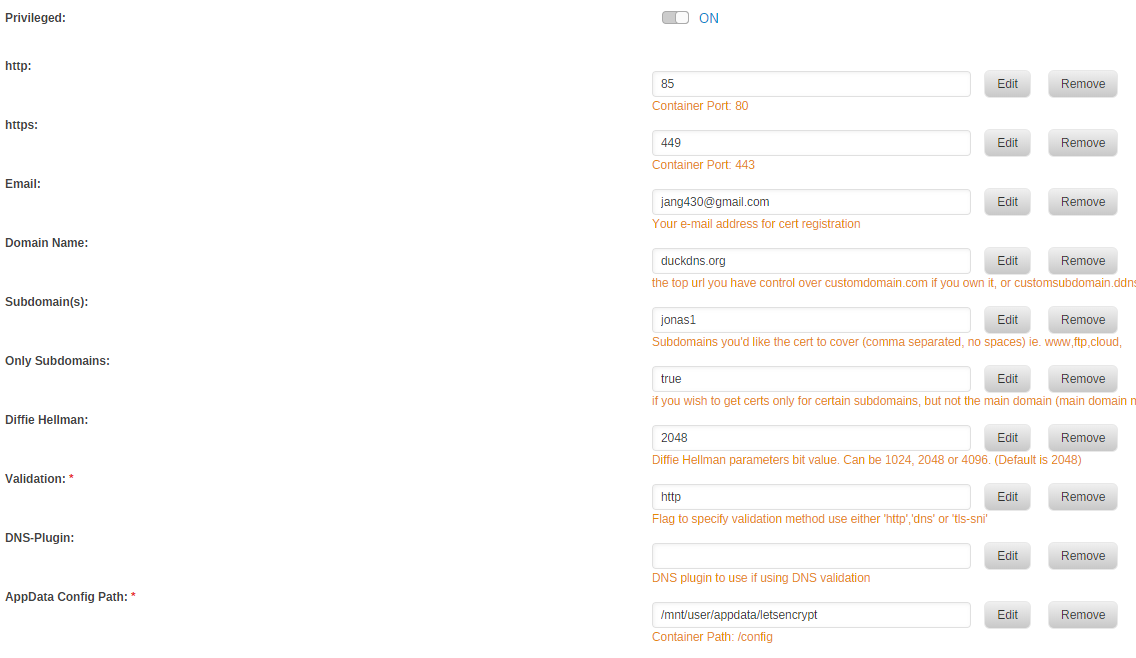

4 hours ago, jang430 said:
@vortexrap, @LordShad0w, I'm seeing the following:
But still getting
Failed authorization procedure. jxxxx1.duckdns.org (http-01): urn:ietf:params:acme:error:connection :: The server could not connect to the client to verify the domain :: Fetching http://jxxxx1.duckdns.org/.well-known/acme-challenge/boKxf6D_5_zgK27HQt2LSwowiMaHcicSWgtnm12EDbY: Connection refused
IMPORTANT NOTES:
- The following errors were reported by the server:
Domain: jxxxx1.duckdns.org
Type: connection
Detail: Fetching
Connection refused
ERROR: Cert does not exist! Please see the validation error above. The issue may be due to incorrect dns or port forwarding settings. Please fix your settings and recreate the container
You don't own or control duckdns.org, only jXXXX1.duckdns.org. Read the descriptions of the docker fields carefully.

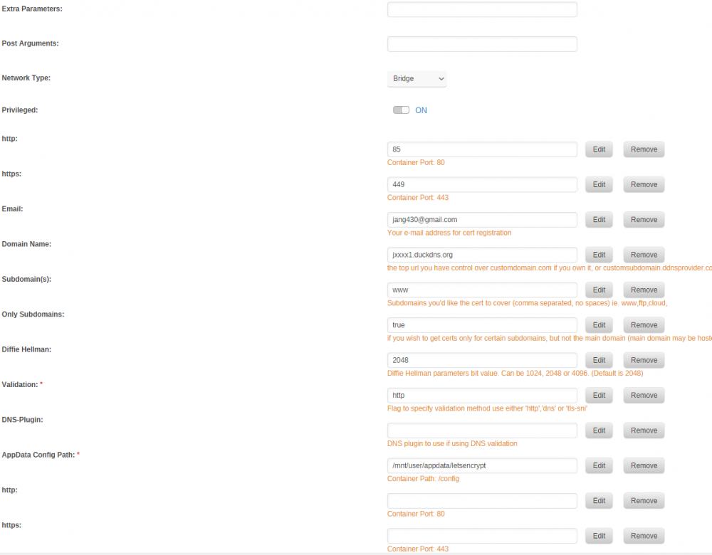

@jonathanm, ok.  Changed settings to the following:
Same error persists.  I tried to go to www.jxxxx1.duckdns.org, still the same error.

Hi!  Any more suggestions on how to fix this?
Thanks!

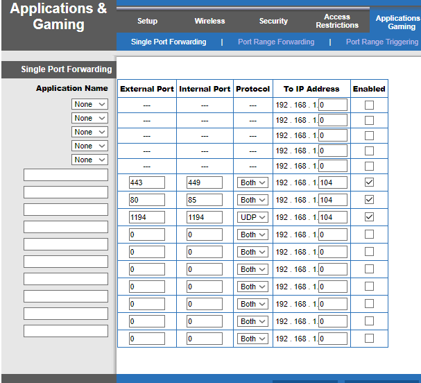

@saarg, port forwarding is ok.  Tested already.
It can't connect on port 80, so it seems that the issue is port forwarding. How did you test it?
Or the dns is not pointing to the correct IP.
Edited by saarg
I turned off the LE docker container, and started an nginx docker container, mapping exactly on the same ports as LE.  Without changing any port forwarding in the router (already pre-adjusted), I can see that it's forwarded to the nginx page.
Looks correct if your IP is correct.

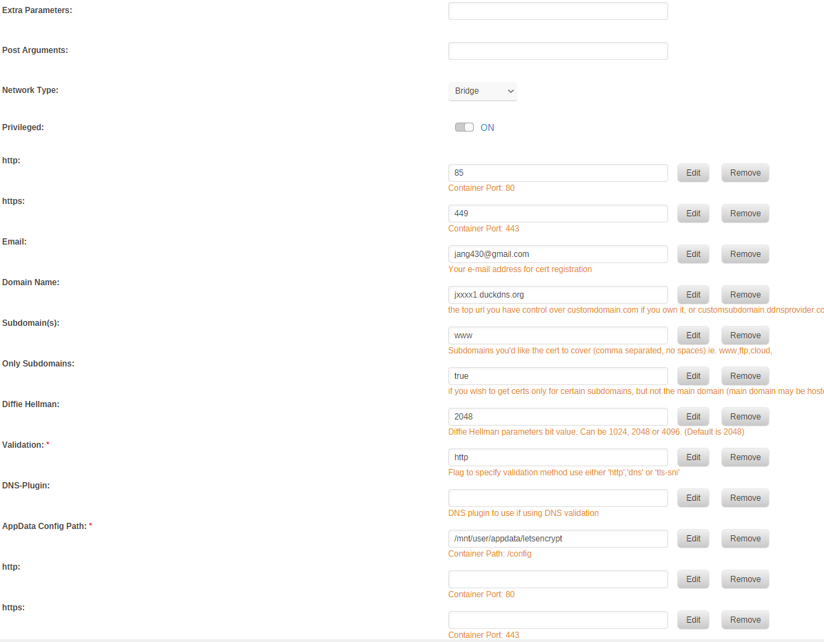

Can you try to remove the two http and https port mappings that are empty in the bottom of your template? That might be the issue.
didn't notice it popped up again.  I did try deleting it earlier, and still not working.
Finally got it working.  All I did was delete the whole docker container, then recreated it with exactly the same values.
