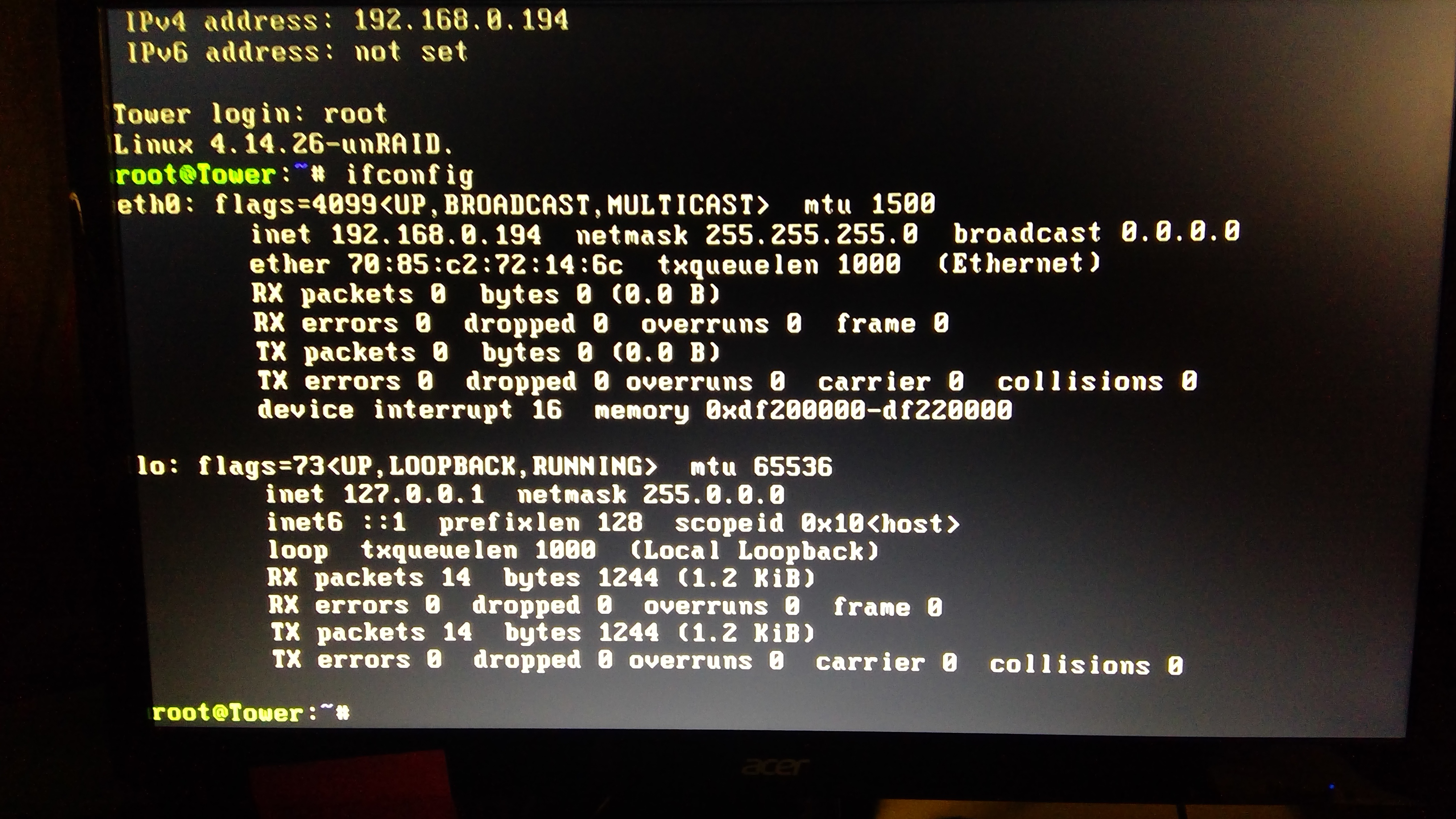

if you could, give me the ifconfig from the terminal on the unraid server.
one sec, trying without the router static address.

the eth0 broadcast in that screenshot is 0.0.0.0
on unraid can you ping itself by ip address?

Correct, no lights on back of card when running 6.4/6.5
Lights on when running 6.2.4
unraid pings itself successfully.
Edited by nautarch
I think either your NIC is dead, or we're on a dead port on the router - or the cable is shot.
