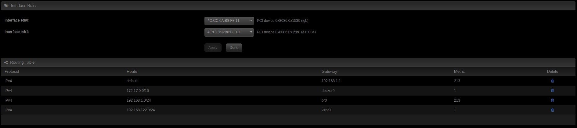

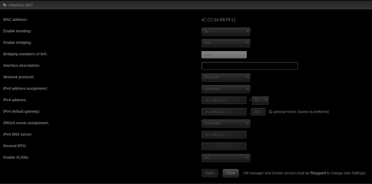

VMs have no internet access after unRAID upgrade to 6.4.0
I ran unRAID v 6.3.4 and after I've upgraded it to 6.4.0 I started to see some strange things and one of those is that not one of my 4 VMs have Internet access (my containers have Internet access) and they had it before.
This is the config for 3 of those VMs:

And the pictures are the network config on the unRAID server.
Thank you!
