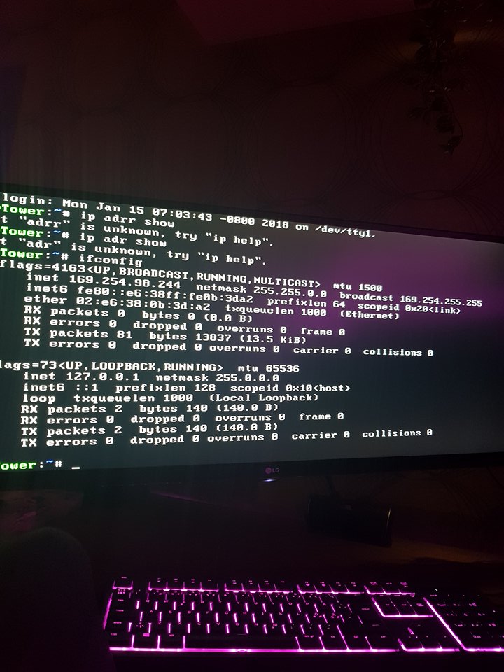

Hello! Im having some issues when trying to install UNRaid on my server. I downloaded the file from LimeTech and installed it on 3 different USB devices. Plugged it in to my computer and booted in to the USB drive. Started up the server. But its not possible to find it on the network. Tried restarting and different USB memory but no luck.
- When prompted with the login username and password the ip says 168.192.24.5 <- something in that style.
- cannot find device bond0
I don't really know what to do or what im doing wrong. Tried searching to find the answer but no luck. Anyone got an idea on what the problem could be?

The 169.254.98.244 is a self assigned address and is standard no matter the OS when you've set the operating system to get an IP address via DHCP (from like your router) but the OS is not assigned an IP address. If you know how try setting a static IP address. My networks is setup to give 192.168.1.x addresses so I would set mine to something like 192.168.1.5. Also, when typing ip addr you don't need to type show. Just "ip addr" and it will show you. ifconfig also works like you used.

Yes im using an ethernet cable. Okey, I will try setting up an static IP and see if that changes anything. Should I also set it to the config file in the usb flash drive? As for drives, I was thinking I would use the 6TB to store all my Media, and have the 1 TB as taking "small backups" of the 6TB or only backup up important stuff from the 6 TB and the SSD was thinking like u said a cache drive.
