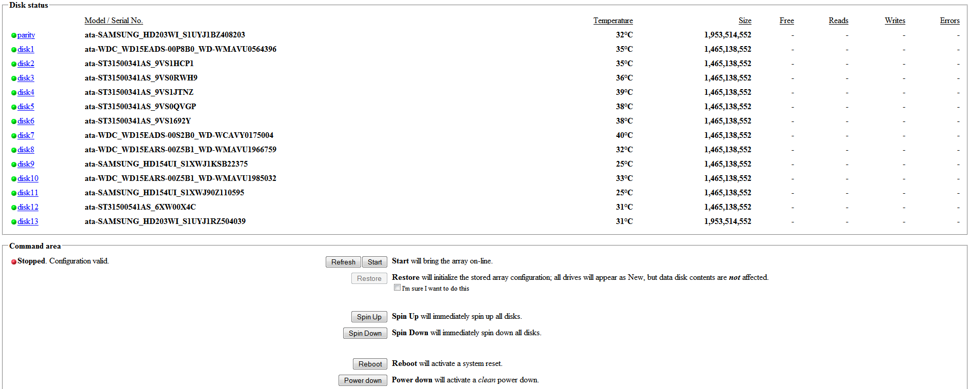

I have unraid 4.5.3 and the start button was there, but when I pushed that
the discs show unformatted for a while and then return to "array stopped mode".

Should I press restore, even though all the drives are green?
Why don't you press "Start" ?    You should be able to if all the disks are showing "green"
You can press "the button labeled as"restore" only if all the disks in the array are working and you do not expect to need to re-construct any of them from parity, since parity will immediately be invalidated when you press the button.  When you subsequently press "Start", after using the "restore" button to "Initialize the Disk Configuration" the array will begin a full parity calculation.
You might be on a buggy version of unRAID if it does not let you start.  Please upgrade to 4.5.6.  On it the "restore" button has been removed and replaced with an "initconfig" command invoked on the system console.  (functionally equivalent, but better named, and less likely to be pressed accidentally)

The start button does not start the array, it shows the disks as unformatted for couple of seconds and returns to "array stopped".

Sorry, but I did mention that I have 4.5.3 version and posted the syslog as well as a screenshot of the main view. But syslog is attached here too.
I am just wondering what does it "restore" if all the dots are green. There's no way I can delete all information by pressing restore or if I update to 4.5.6?
It NEVER "restores" anything.  That is the issue with the label on the button.  It sets an new initial configuration based on the currently assigned and working disks.  The button was removed in 4.5.4 and replaced with a command line utility that is named "initconfig", a name that more accurately describes what it does.
You can lose information if you have accidentally assigned a data drive as your parity drive.  You can lose information if a data disk shows up as "un-formatted" and you press the "Format" button that then appears.  Other than that, you are pretty safe.
So, un-assign the parity drive, just at first, and press "restore" then, do expect all the disks to come online when you press "Start"
If they do, and if none show as un-formatted, you can then stop the array and assign parity and start it once more.
If ALL the drives show as un-formatted, that is the major bug in 4.5.3, do not panic, just press "Stop" and then press "Start" once more.  They should then all mount.  DO NOT PRESS FORMAT!!!!!
Then, once parity is calculated and you are protected once more, upgrade to 4.5.6 so you do not get bit by the bug in 4.5.4 as several users have.  It is no fun when you realize you just re-formatted ALL your disks.

Can you post a new one covering the time during which you attempted to "Start" the array (and where it would not start)

So, you are saying you used a window's utility in a different PC to remove the partition on disk13.
Yes.
You think that the other 2TB drive (the parity drive) is un-changed from when it was last in the unRAID array?
Yes. I did the parity check just a few days ago.

Here is what I now understand.  If It is incorrect, do not proceed without guidance.
You wiped out the partition on disk13, your data disk.
You think the parity disk is untouched from when you last were able to boot unRAID.
We need to force unRAID to think disk13 needs to be rebuilt.  Right now, it is some state I cannot explain and you do not seem to be able to start it by pressing "Start"
So... READ ALL THE FOLLOWING STEPS BEFORE DOING ANY OF THEM.  If you do not have the situation I described, then do not proceed.
1. All the disks that were in the server when you last calculated parity MUST still be in the server and assigned their original slots.
If not, DO NOT PROCEED.
The parity disk must be assigned to the parity slot.
Check the checkbox under the button labeled as "restore" and then click on the "restore" button BUT DO NOT START THE ARRAY just yet.
On the command line type the following command to force disk13 to be considered invalid.
/root/mdcmd set invalidslot 13
It should respond with "OK"
Refresh your browser on the unRAID management interface.  Disk13 should show as "red"
Only then is it OK to press the "Start" button on the management interface.   It should say something about re-constructing the failed disk (I don't remember the exact wording)
The array will use parity in combination with all the other disks to reconstruct the contents of disk13.

Yes, you have understood correctly and thank you for your help.
I have to do the rebuild on some other day that I'm at home.
Even though there wasn't than like 200Gb's of files, does it still take as long as a normal parity check?
