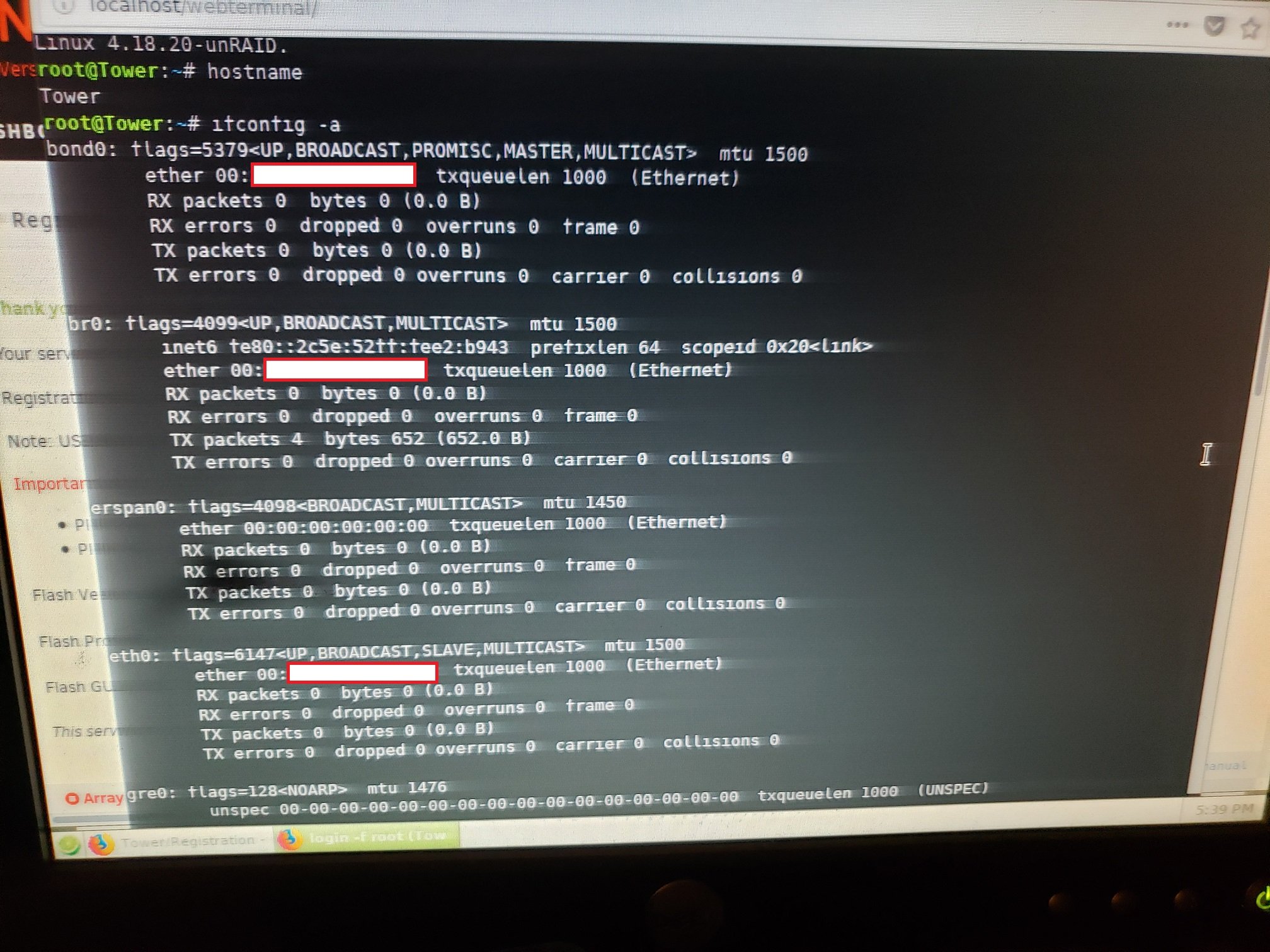

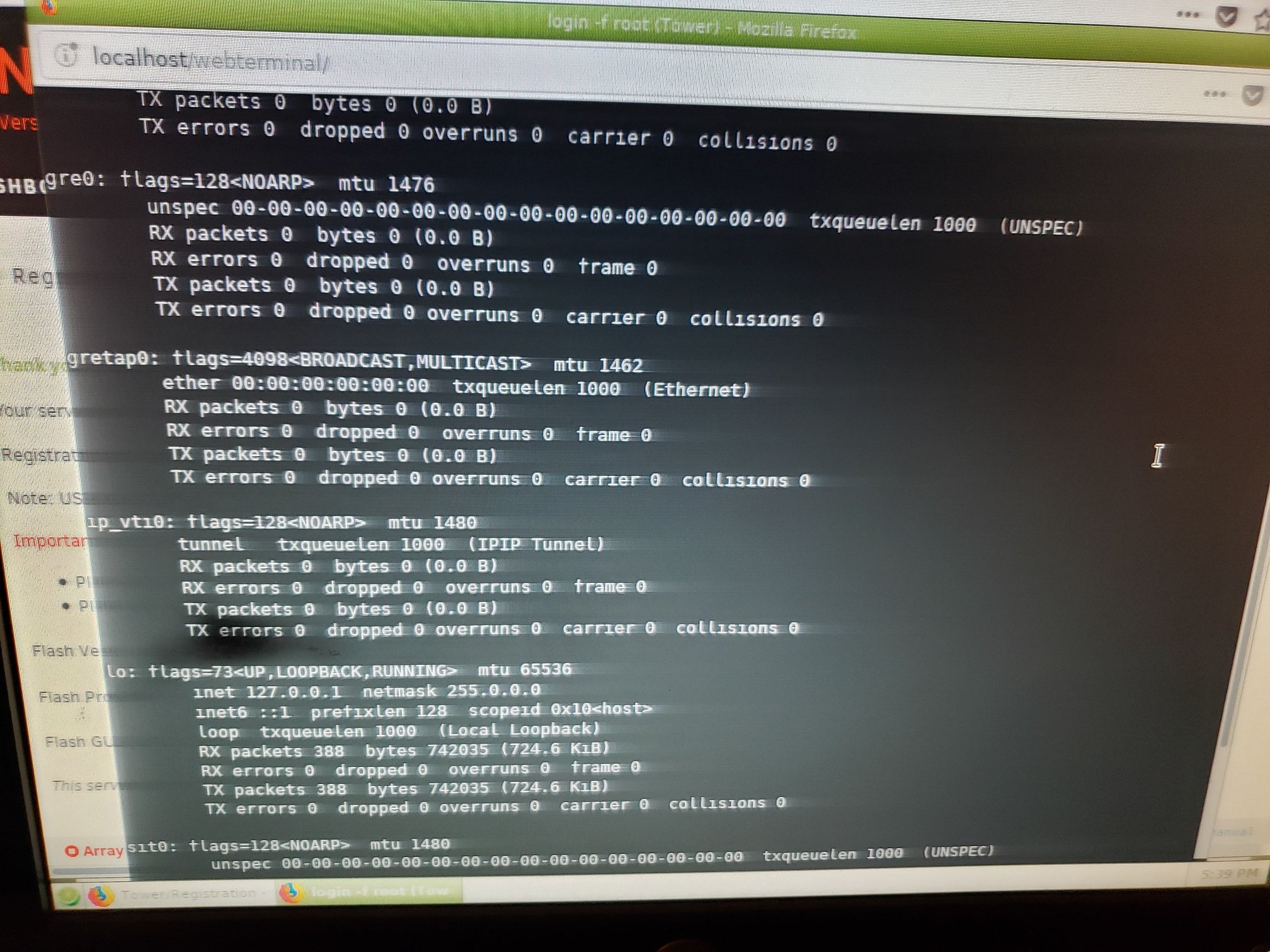

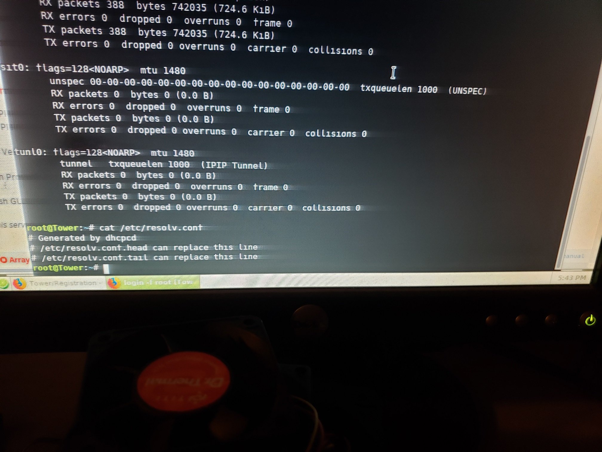

Here are some screenshots from what I figured would be applicable here. I'm not super familiar with Linux so i had to lookup most of these terminal commands. If we need something more let me know and I can get that. I'm not sure what the best way to go about this is so I'll just play it by ear.
hostname, ifcongfig - all, resolv.conf (All 3 blanked out MAC addresses are the same)

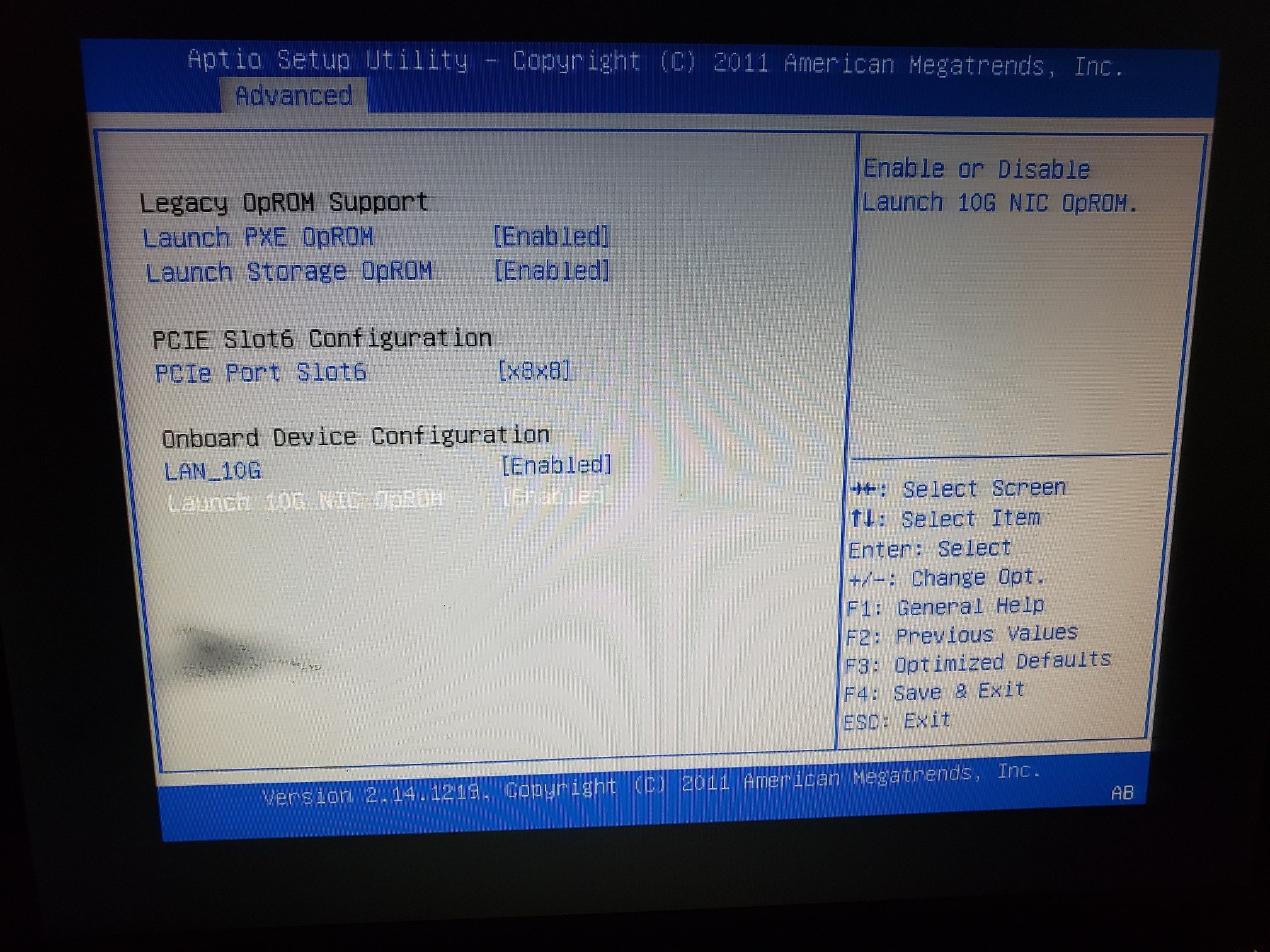

Bios > Advanced > Onboard Device Configuration

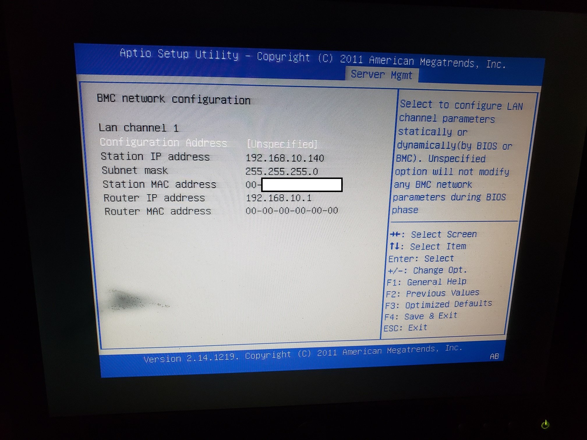

Bios > Server Mgmt > BMC Network Configuration (I believe this is for remote booting but it seems to be the only thing I can see that is getting assigned an IP so I figured I'd include it. This MAC address if different than the three in the previous image.)
Inventec B800 mainboard RJ45 should be an IPMI port ( remote management ), only 10G SFP+ was network port, if you not planing run in 10G optical, you may try some converter from SFP+ to 1G RJ45 or add a Network card.
This is exactly what I was thinking but I wasn't sure. Since I saw so many people having success with this card I figured they were using the RJ45. Thank you so much for your insight!
