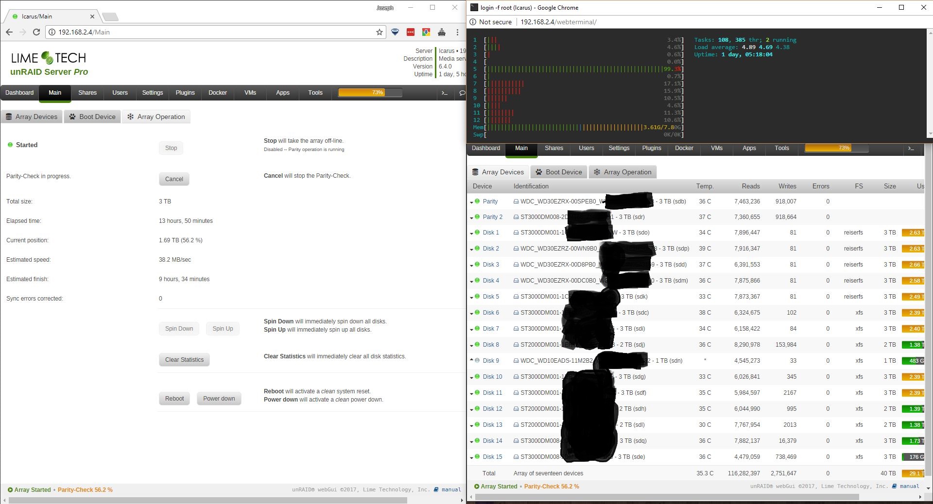

Thanx johnnie, yea it normally takes 18 - 24 hours for my 3 tb system. Not sure why or that that was slower than others. I wonder what the issue is on the time to do parity.
Total size: 3 TB
Elapsed time: 13 hours, 48 minutes
Current position: 1.68 TB (56.1 %)
Estimated speed: 35.9 MB/sec
Estimated finish: 10 hours, 12 minutes

If the parity check is CPU related it must me single core only as my system is only using 1 core to 100% the rest are sub 20%.....If that is true is there any way to make it multi-threaded.
Edited by pyrater

If the parity check is CPU related it must me single core only as my system is only using 1 core to 100% the rest are sub 20%.....If that is true is there any way to make it mult-threaded.
Yes, it's technically possible to make it multi-threaded, since each stripe is independent of other stripes. So the CPU could compute data for two stripes concurrently.
The main reason for not implementing a multi-threaded scan is the percentage of systems that are CPU-limited compared to the percentage of systems that are I/O-limited. Only systems that are CPU-limited would get any advantage from using multiple threads. My guess is that most installations are I/O-limited. Either by the total bandwidth supported by the disk controller or by the maximum bandwidth of the slowest disk.

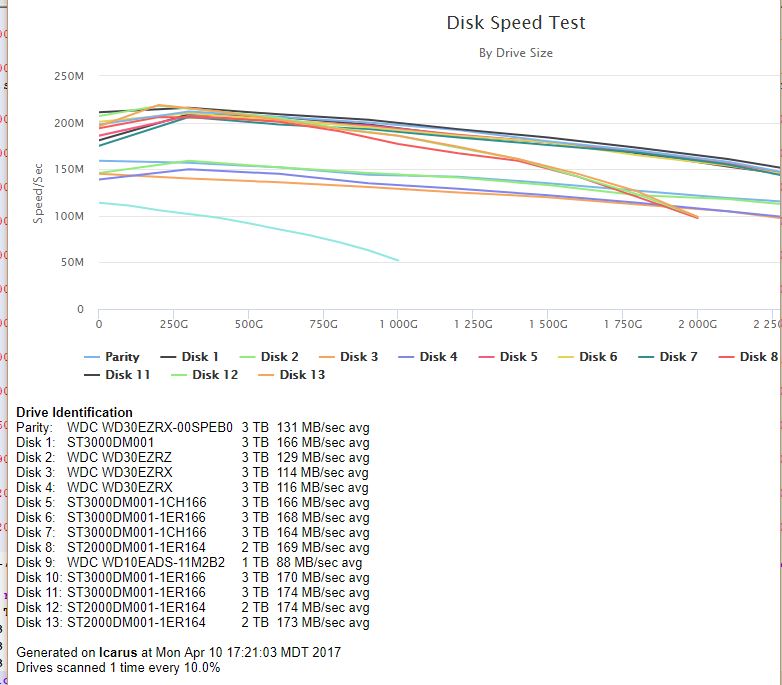

I did run a disk speed test awhile back, seemed like slowest drive was 88 mb, not the 30 that the parity is doing. So i assume im CPU limited?
Edited by pyrater
Most likely, assuming your using SAT2-MV8s and not some slower PCI controllers, those CPU have a very low single thread performance.
Yes. No disk you would ever be interested in is as slow as 30 MB/s for sequential read.
