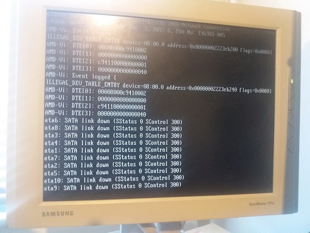

There was no network connectivity despite the NIC LEDS being lit, I have tried unplugging and replugging the network cable and rebooting the network switch too.
I have had to do a hard reboot, the server comes up OK but the hard disks are now not being detected again - see attached diagnostics file

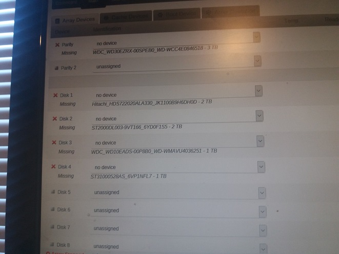

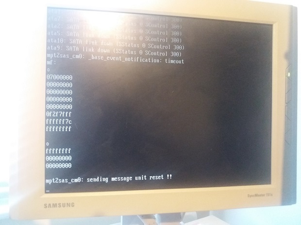

I tried moving the DELL H200 card back to it's orginal PCIe slot, but it is not being detected by UnRaid and times out
On reaching the GUI, all disks are missing - see attached screenshot
I have now moved the card back to the PCIe slot which it came from today, the server boots up and is doing a parity check due to the unclean shutdown
It have never had a problem with the card or PCIe slots on previous versions of UnRaid?

Try updating your bios, there's no general problem with v6.4 and LSI controllers.
