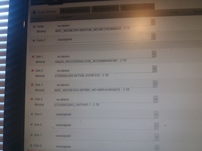

I have updated my 2 servers from 6.3.5 to 6.4.0

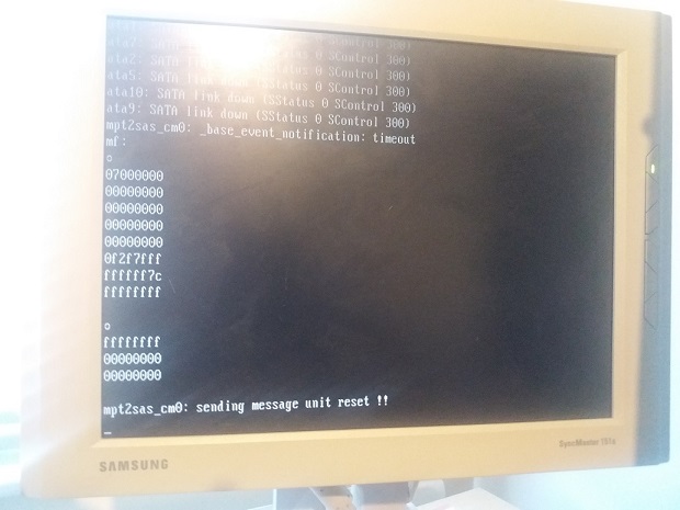

One server update went OK, however the second server is causing me problems. it appears that the DELL H200 card is not being detected, the array starts but no disks are shown.
I have manged to get the array working by having to swap the card between 2 PCIe slots a number of times.

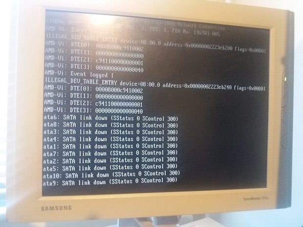

However I found that the server had no network connectivity this morning, despite the NIC LED's being lit. I havwe tried to disconnect and reconnect the network card, and rebooting the switch, but all of these have had no effect.
In the end I have had to carry out a hard reboot, and the array is currently carrying out a parity chck.
Please see attached diagnostic file and screenshots - I have never had a problem like this on previous verious versions?
PS Since upgrading I have found that clicking on the log tab now just gives you a blank page with no information?
backup-diagnostics-20180116-1716.zip
