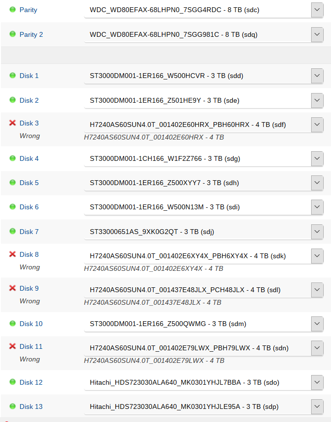

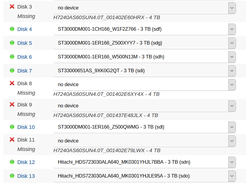

I was previously running v6.34, with 2 Parity Disks (8TB), 2 Cache Disks (256GB SSD), and 13 Data disks (Mix of 3 & 4 TB SAS).  Months back, I had added 4 new disks to expand the array.  After which, when rebooting, those Disks would show as "Missing" / "No Device".  I would then select the appropriate disk for each device and start the array.  PITA, but hadn't been able to spend the time to troubleshoot.  Jump to this morning, verified by nightly CA_Backup and upgraded to 6.4 through the Plugin.  Upgrade completed successfully, I went into Settings\Disk Settings and disabled Auto Start prior to rebooting the array (since I assumed I would need to re-assign the "Problem" devices).
Sure enough, after reboot the same 4 disks are marked as "Missing" / "No Device".  I selected the appropriate drives, at which point they change from "Missing" to "Wrong".  Unlike in 6.34, which recognized the identification and allowed me to start the array.

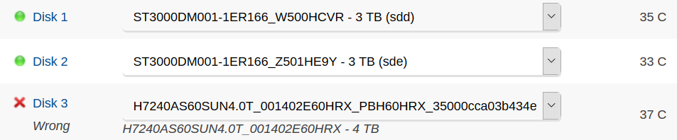

The names do appear different in Identification-
for example:
H7240AS60SUN4.0T_001402E60HRX_PBH60HRX - 4 TB
when it's looking for:
H7240AS60SUN4.0T_001402E60HRX - 4 TB
I believe the LSI controller is contributing to the name difference, however in 6.34 I was able to manually assign (through the GUI) and start the array.
So my big question is should I use Tools\New Config to reassign the disk to device mappings (Preserving the Parity and Cache slots), or is there a better way to resolve (I can always revert back to 6.34)?
I've include my last syslog, and some images of the Array Devices screen from 6.34 and now 6.4.

Change setting Display world-wide-name in device ID to Automatic.
See Settings -> Display Settings.
Doing it now...
Still lists as "Wrong".
Are these disks connected to a RAID/SCSI controller?
If yes, you may try the Dynamix SCSI Devices plugin.
Here is the controller:
Serial Attached SCSI controller: LSI Logic / Symbios Logic SAS2008 PCI-Express Fusion-MPT SAS-2 [Falcon] (rev 03)
I'm hesitant to add the plugin...
Setting WWN to automatic should have worked with this controller. You may want to file a defect report and refer to here (6.4 has some changes in regards to SAS support).
I've pulled the Diagnostics to submit with a defect report.
Any recommendations around my "New Config" question?
What are the ramifications to running "New Config" while preserving the Parity and Cache slot assignments.  Then reassigning the disks to the same slots they were previously (with WWDN set to automatic)?
Thoughts?
Yes, you can do a New Config with retain ALL. Then select parity is already valid when starting the array. No ill effects.

With "retain all" the list of devices is simply prepopulated for you. You can make changes afterwards, but most assignments will be already correct, saving you work :)

You can start with the ‘retain all’ option, and then change only the slots that need correcting.     Much easier (and less error prone) than trying to enter all slots from scratch.
Will do, Thanks for the clarification!
Running the New Config Utility (with Retain All) corrected the naming issue and all drives are now online with a running array!
Once back in the Main view, I selected Parity is Valid and started the Array, everything seems to be back to norm.
Later tonight I will reboot the array to see if the original issue is resolved,  I'll update this thread after verification.
Thanks all (especially bonienl)!
Quick and final update.
I rebooted the array, all drives were recognized and the array auto started without issue!
The original problem with the 4 newest HDD's listing as "No Device" in their disk slot after reboot has been resolved, as well as the "Wrong" device error that appeared after the upgrade.
