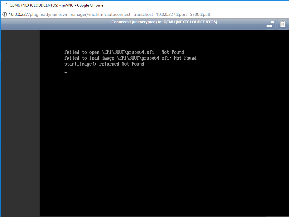

hmm when trying to boot the nextcloud machine seem to be getting this error not quite sure how to go about it

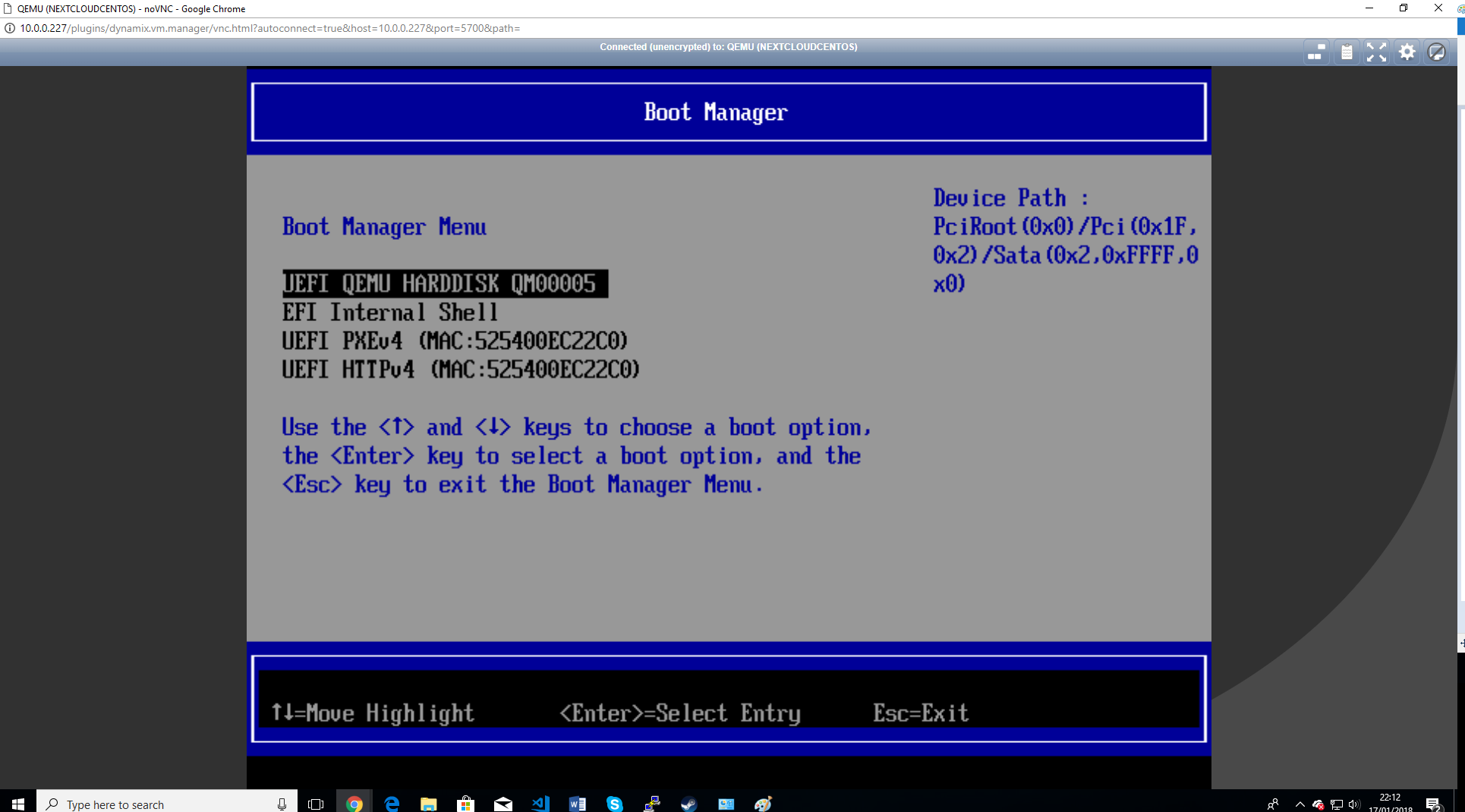

imageproxy.php?img=&key=00b562fcac28e727
additional pictures

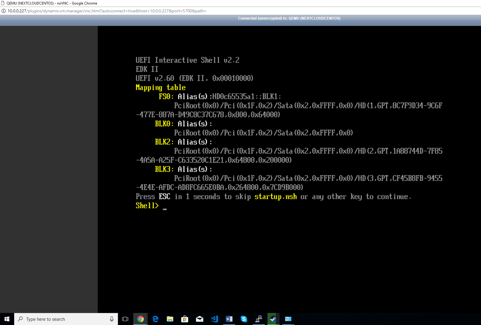

shell message if it helps
