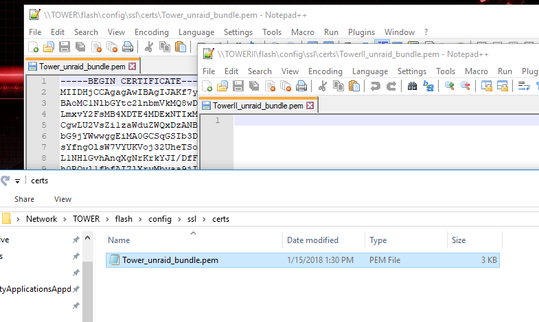

At this point I figured this may have to do with the new ssl certs feature, so I compared the PEM file between the two servers and found my updated server had the BEGIN/END CERTIFICATE and the BEGIN/ END PRIVATE KEY information in the file.  The PEM file on my 2nd server with no GUI was totally blank so I followed the OP and updated the ident file and modified the "Use SSL" line to "No" but still no success.

This was an excellent summary, but I would have preferred to see it in the release thread :)  (thanks to the mod that moved it!) Anyway, I would delete config/ssl/* from the flash drive and reboot.  Unraid should regenerate the missing *.pem files. If you still have issues, attach the full diagnostics after your next boot.
