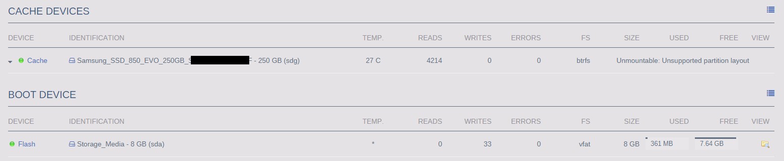

I'm a mittle frustrated right now. Due to the update from the latest stable version of unraid (i believe it was 6.3.5 or so) to the actual stable 6.4.0 all went right beside of i'm having trouble with my cache drive too. On the main page it says "Unmountable: Unsupported partition layout". It was formated as btrfs an all was right before i had updated the server.
I tried these changing of sata cable mentioned in an other post, but that didn't helped.
I stopped my array and accessed over the folder icon in the main tab, there where all folders, but as i started the array again the cache drive failure is there again.
Today i discovered the all the shares are gone after some hours (maybe 12 or so) after a reboot of the server all shares are up again and the server is accessible again.
