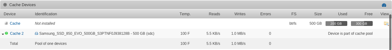

Thank you @johnnie.black I was able to get it back online. For now I'd like to just sort out why the following is happening. I want just the 500G drive on my cache. When I try and mount it as disk 1 for the cache it gives me the formatting error.
What is the exact error your seeing? Alternatively post your diagnostics after getting it.
