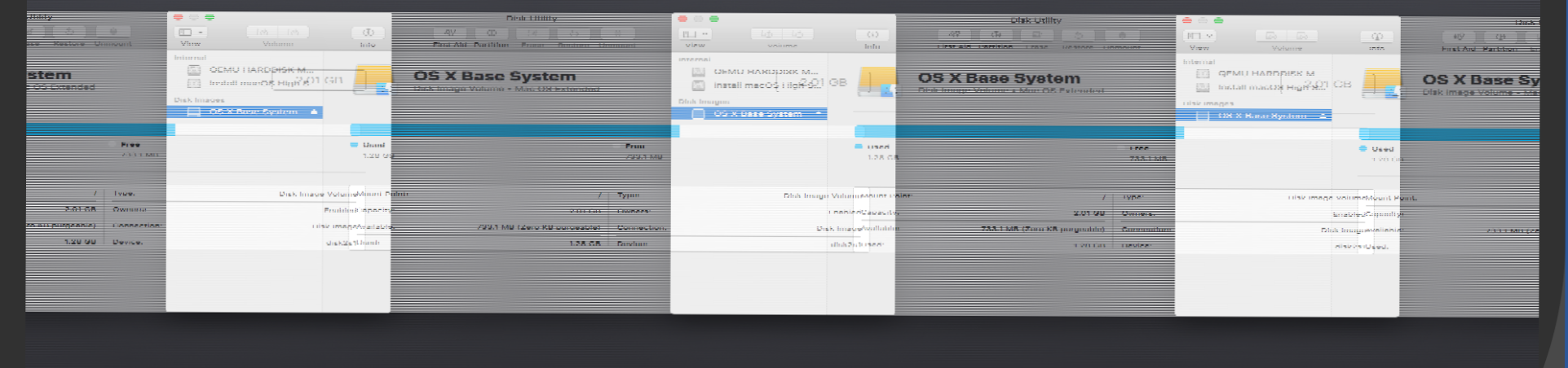

vnc screen not correct
i am trying to make a Mac OSX vm computer (like who has the money for the real thing) i have been following the steps from this youtube video, the thing is that when i do a vnc connection to it the screen looks to be squashed.
this is the xml for the vm

if anyone can see were i went wrong then that would be a big life saver
probably a setting in the bios os the vm has incorrect dimensions set.
well is my face red. just had another look at the video and i had set the screen size to 1280x1024 not 1920x1080. all working well now, silly mistake
