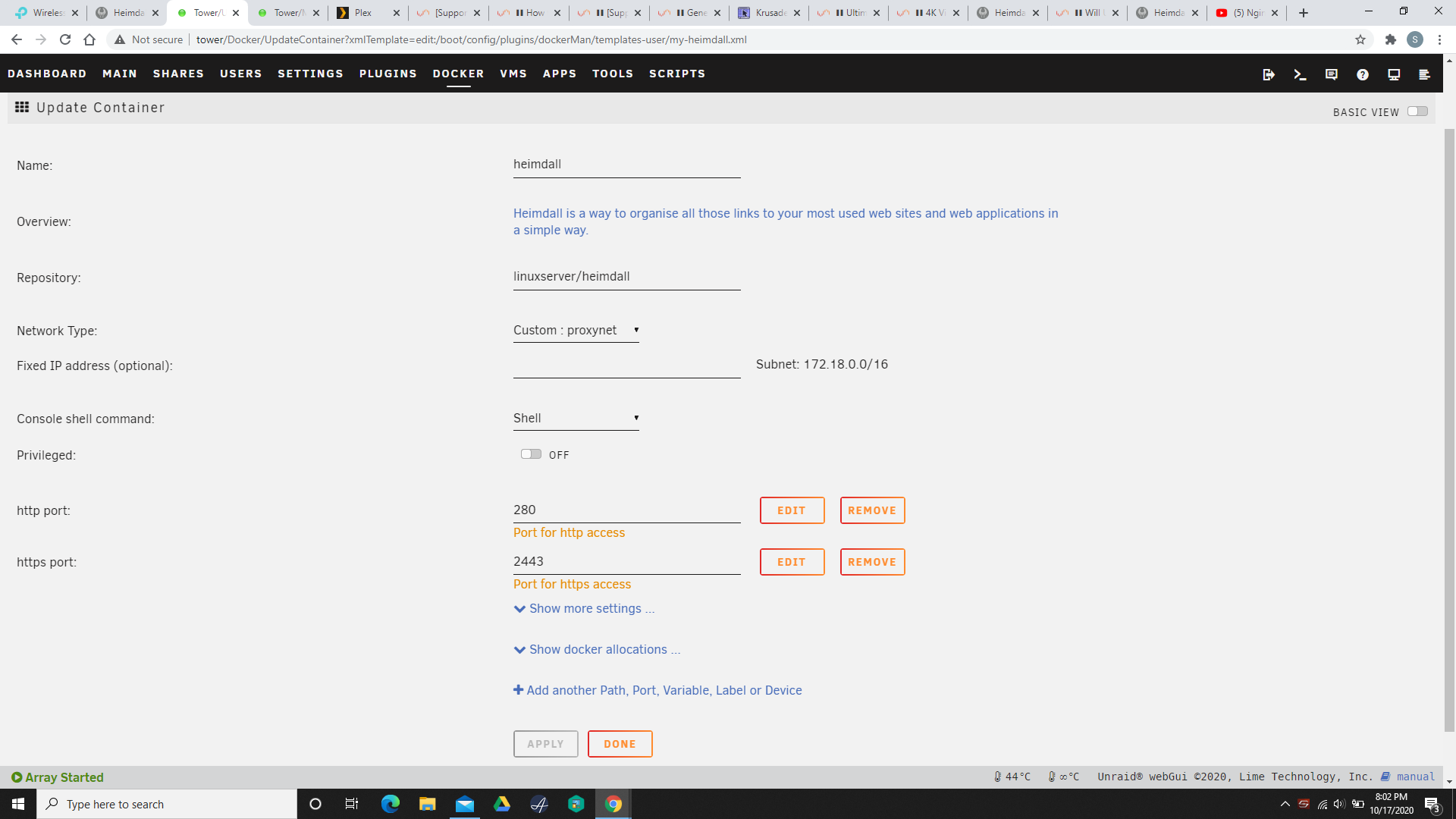

You have to go into the Heimdall container template and assign port numbers. It conflicts with the port numbers of Swag....when I opened the Swag webgui it took me to a messed up view of the Heimdall webgui.  So in the template for http I used 280 and for https 2443. Now I can access Heimdall from the webgui and from my custom url.  Somone said it doesn't need a port number but it appears its best to use them, and if you don't it interferes with Swag

Did you add ports in your Heimdall template? Once I added ports (I used 280 and 2443) then it let me access the webgui. Its the fields "http port" (280) and "https ports" (2443)

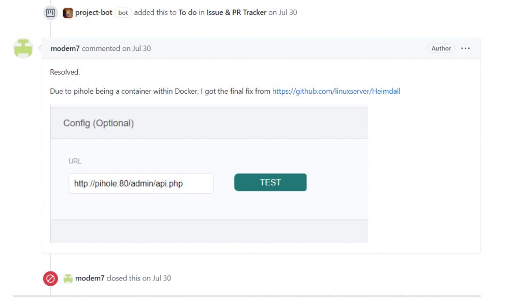

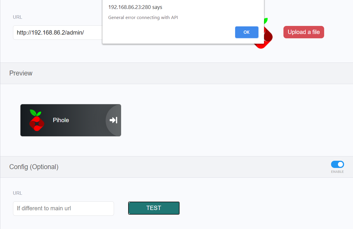

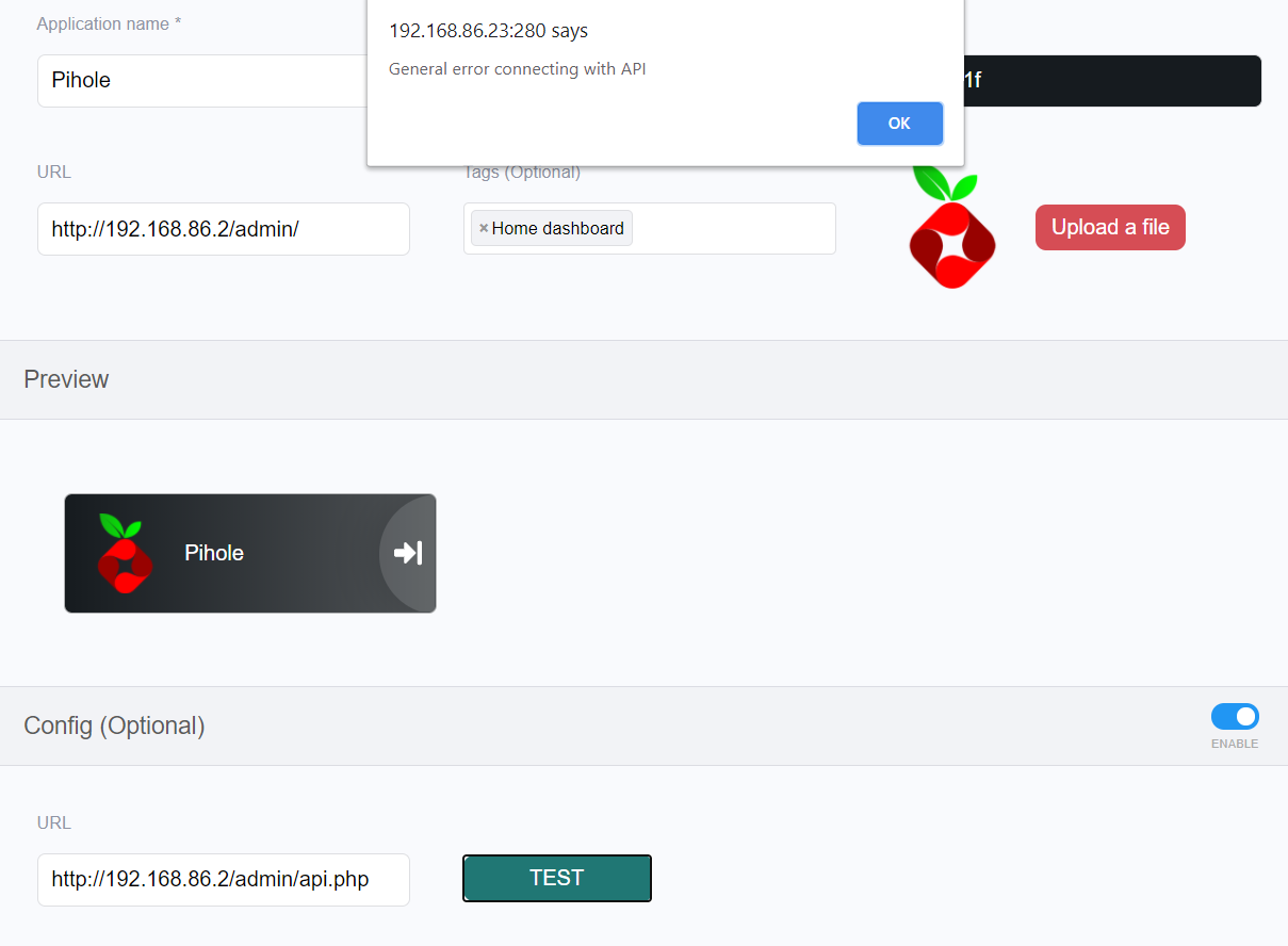

I did. It's working now, thanks! But I'm having a problem getting pihole connected. I keep getting this error even though my information is accurate. Let me clarify. I can save it and use it but I can't get a successful test. I believe if that were successful I'd get reatime data.
Edited by DuneJeeper

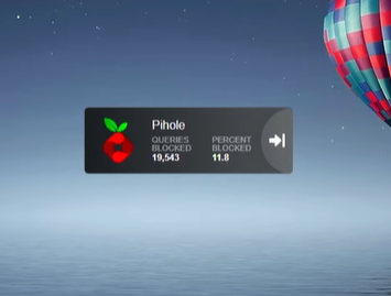

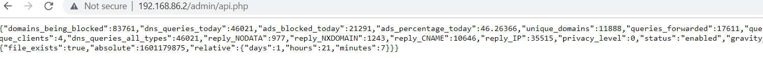

Ok I've tried some different configurations to no avail still trying to get realtime data on my icon. Example is from a video.
I continue to get the API error even though I'm linking directly to the api.php file
My configurations seem correct as setup and suggested
Any more ideas? It's probably something so little I'm missing.
clarify pic

In my Heimdall template for http port I changed it to 280 and https port 2443 BUT I believe in the Heimdall conf file it has some stuff in it relating to port 80, but I didnt change anything in the conf file, its just however it comes. I have a Swag reverse proxy setup....I dont really understand exactly what all its doing....could it be affecting the Heimdall in a way that is causing that?
