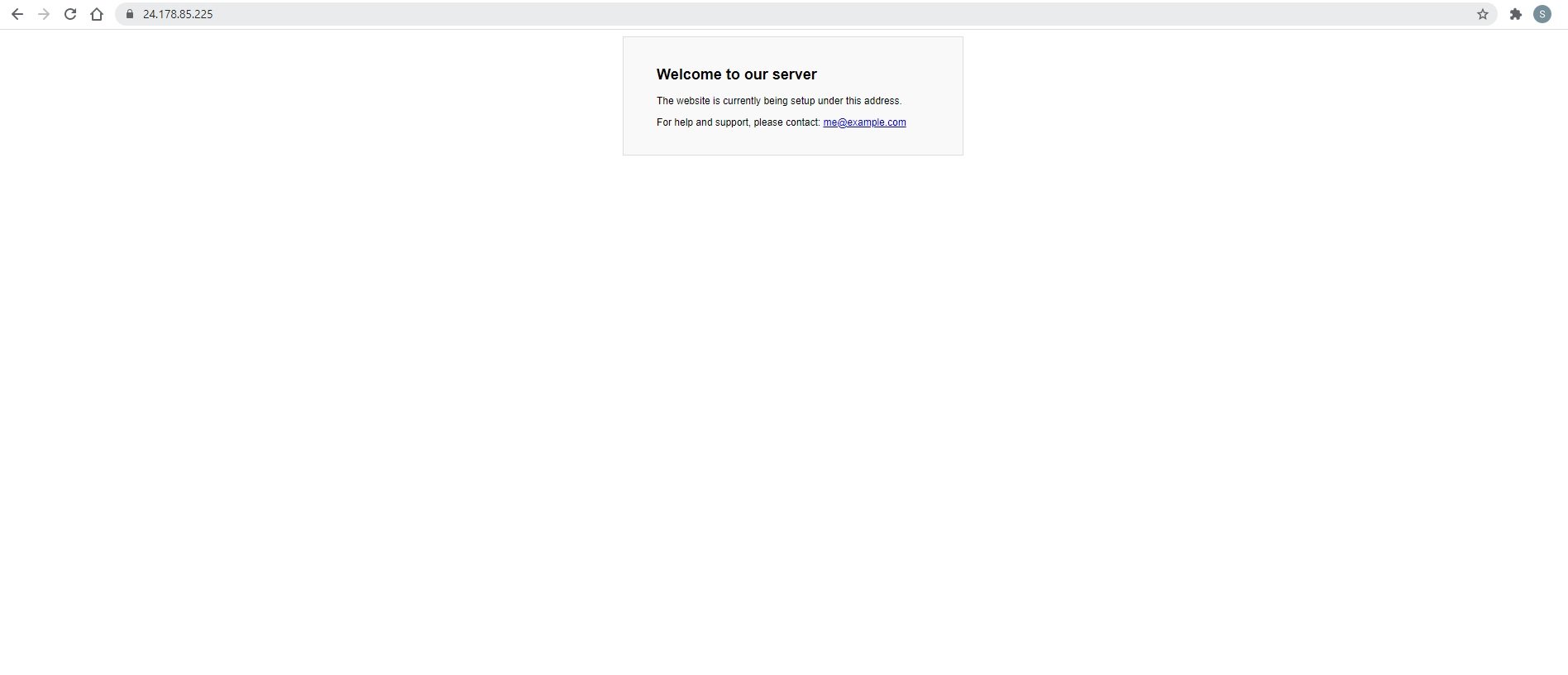

The behavior you are seeing would seem to indicate that port 80 externally is somehow being redirected to port 280 internally.
I dont have anything in my router like that.  Could it somehow be related to the reverse proxy?
Perhaps.  I am no expert on reverse proxy/SWAG so, unfortunately, I could not tell you what to look for there.  Perhaps someone with more experience there will chime in on this thread.

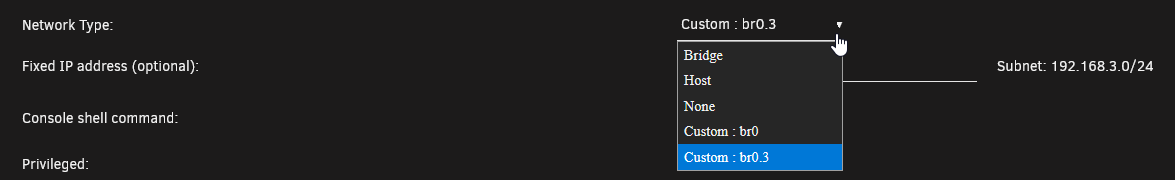

How do you put Heimdall on a completely seperate IP address?  Maybe I should consider doing that
I set up a VLAN (192.168.3.x) following this guide.  UnRAID server is on 192.168.1.x LAN
VLAN shows up as br0.3 in Docker container network type.  Once selected, you can assign a fixed IP address (as I do) or let the VLAN DHCP assign it.
NOTE: if you want to try this, it may not be necessary to setup a VLAN.  It may work fine for you on br0 (no setup necessary).  For me and others, IP addresses on br0 cause call traces and server lockups which a VLAN solves.  It seems hardware dependent and your hardware may not cause the problem.
 I have several docker containers assigned IP addresses on the 192.168.3.x VLAN subnet.
Thanks for the info.....I may do that.  So going this route since you select the new vlan in the docker template as the network type then you cant run it in a reverse proxy setup....is that correct?  I suppose why you aren't running a reverse proxy

When setting up Heimdall with the Swag reverse proxy, are you supposed to edit the name of both the Heimdall.subdomain conf file and the Heimdall.subfolder conf file (in the swag sample files)?  Basically where you take the .sample off the end?  If so, is there anything else besides the name that needs to be changed in either of those files?
Edited by SPOautos
You might be better off not posting the same issue in multiple threads. It's hard to follow what has been done.
You only enable one of the reverse proxy configs depending on if you want to do subdomain or subfolder. There are instructions if you have to do something to do proxy conf or not.
You can easily check if this is a port forward error or reverse proxy by stopping one of the two containers and test what happens if you try to access your IP/domain from the outside.

You will get that page when you just use the IP as nginx, the webserver doesn't know what you want and serves the default landing page. Don't enable the subfolder again. That is probably what have caused all this.
Regarding the subdomains, I didn't mean the server one, but all the others you made. No point if you use subfolder for those apps.

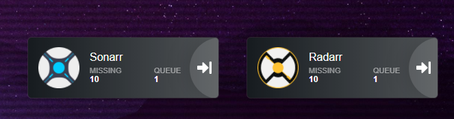

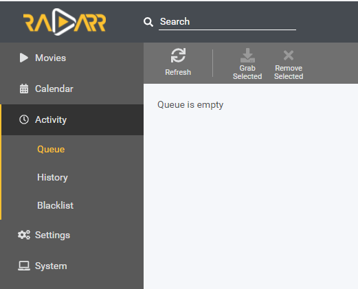

Hey all, having an odd issue where Radarr is being reported as having 1 item in the queue, however my queue in Radarr is empty and all missing movies are currently unrelased still.
This has been going on for a few days now, can't figure out what is still stuck in the queue anywhere?
Screenshots below.
Thanks in advance!
Screenshots below.
Thanks in advance!

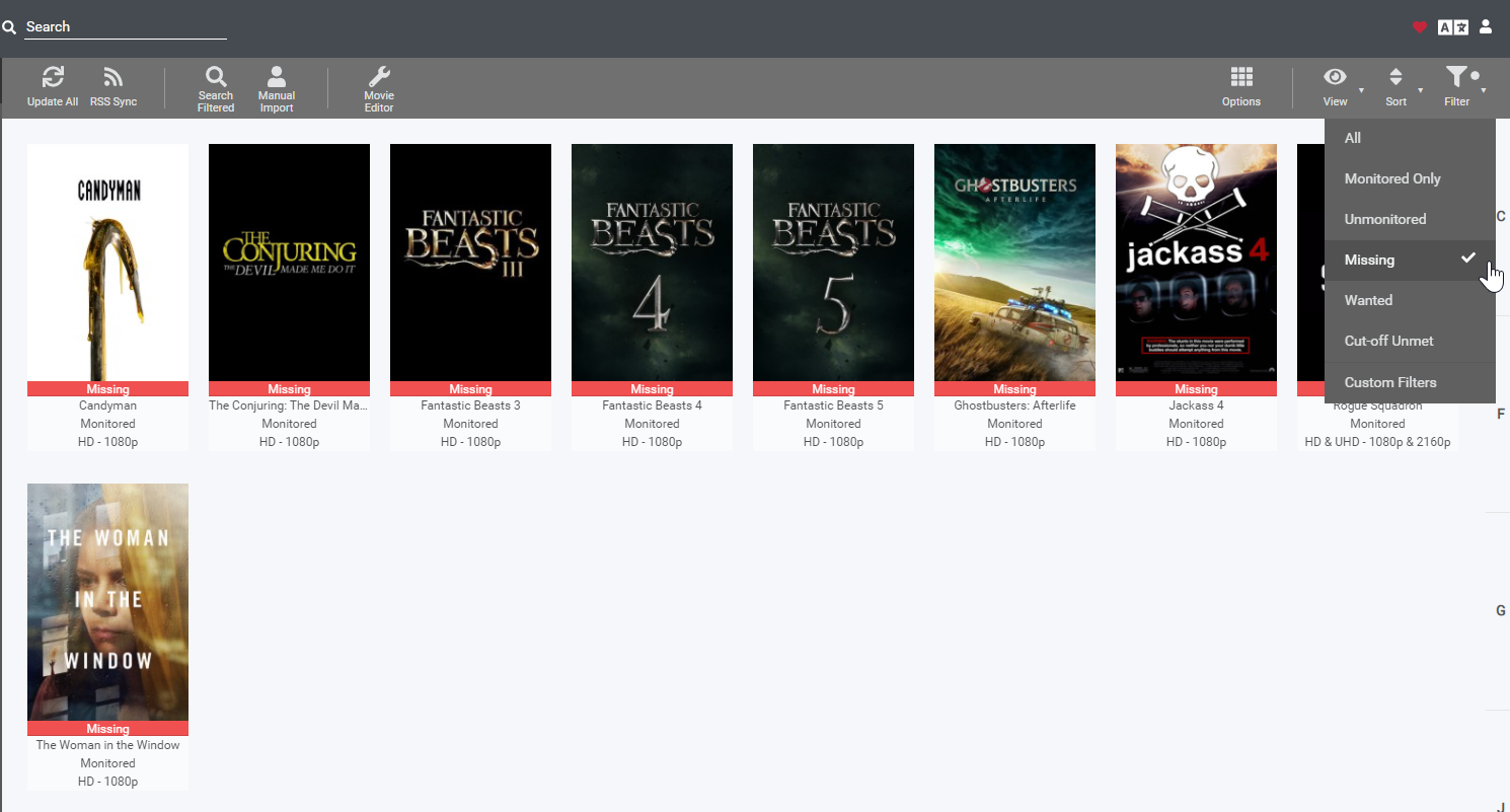

Still having this same issue and I cannot, for the life of me track down what's wrong. Anyone have any advice before I blow away the Radarr container and re-import my library from scratch?
copy/paste of my update in rdarr thread.
So this did end up being a Radarr issue after all
Adding info here incase it helps someone later.
The API command I ran and dumped to a text file helped me find it.
curl -X GET "https://localhost:7878/api/v3/movie" -H "accept: application/json" (also added API key for auth that I removed here)
I then looked for "hasFile": false to find what movies were missing, and found one that wasn't in the GUI under missing and just removed it from Radarr entirely for now to prevent the issue.
Queue issue was an "unkonwn movie" which you can show in UI via options toggle in top right corner. Somehow missed that. Used a separate API command to find that an unkown movie was in queue but this part was findable/fixable via UI in the long run.

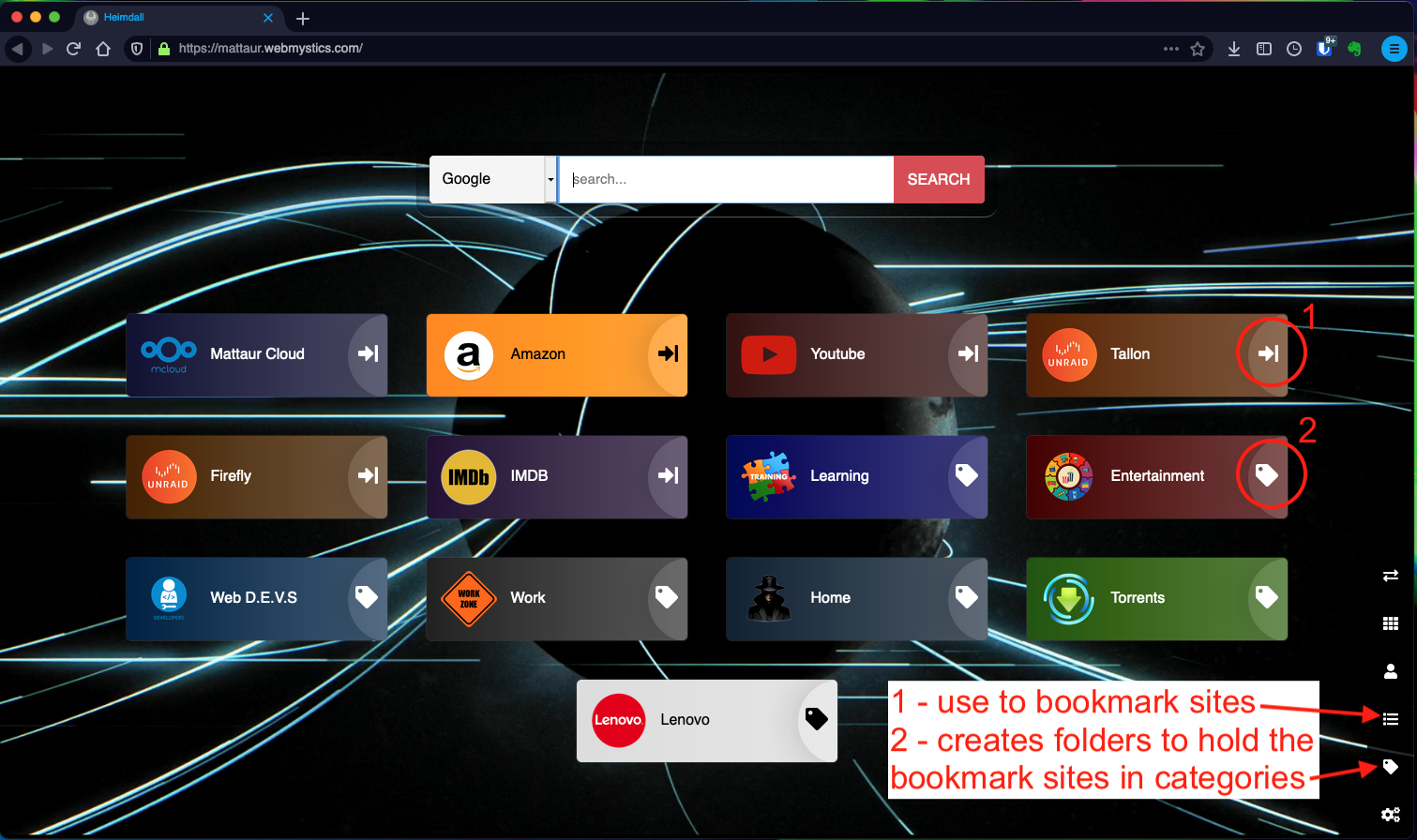

Hello everyone,
I'm using Heimdall as my browsers start page inside my LAN (unraid server is not open to the outside) and find it very convinient. I'd like to add one or two website bookmarks though (let's say forums.unraid.net for example) but that doesn't seem to work? Does Heimdall only give you the option to add links to your unraid hosted apps or is adding external weblinks also possible and I'm just doing something wrong? Thanks in advance.
check you network setup.  I also use Heimdall and my dashboard is for everything, Dev, Work, Home, Entertainment etc.
