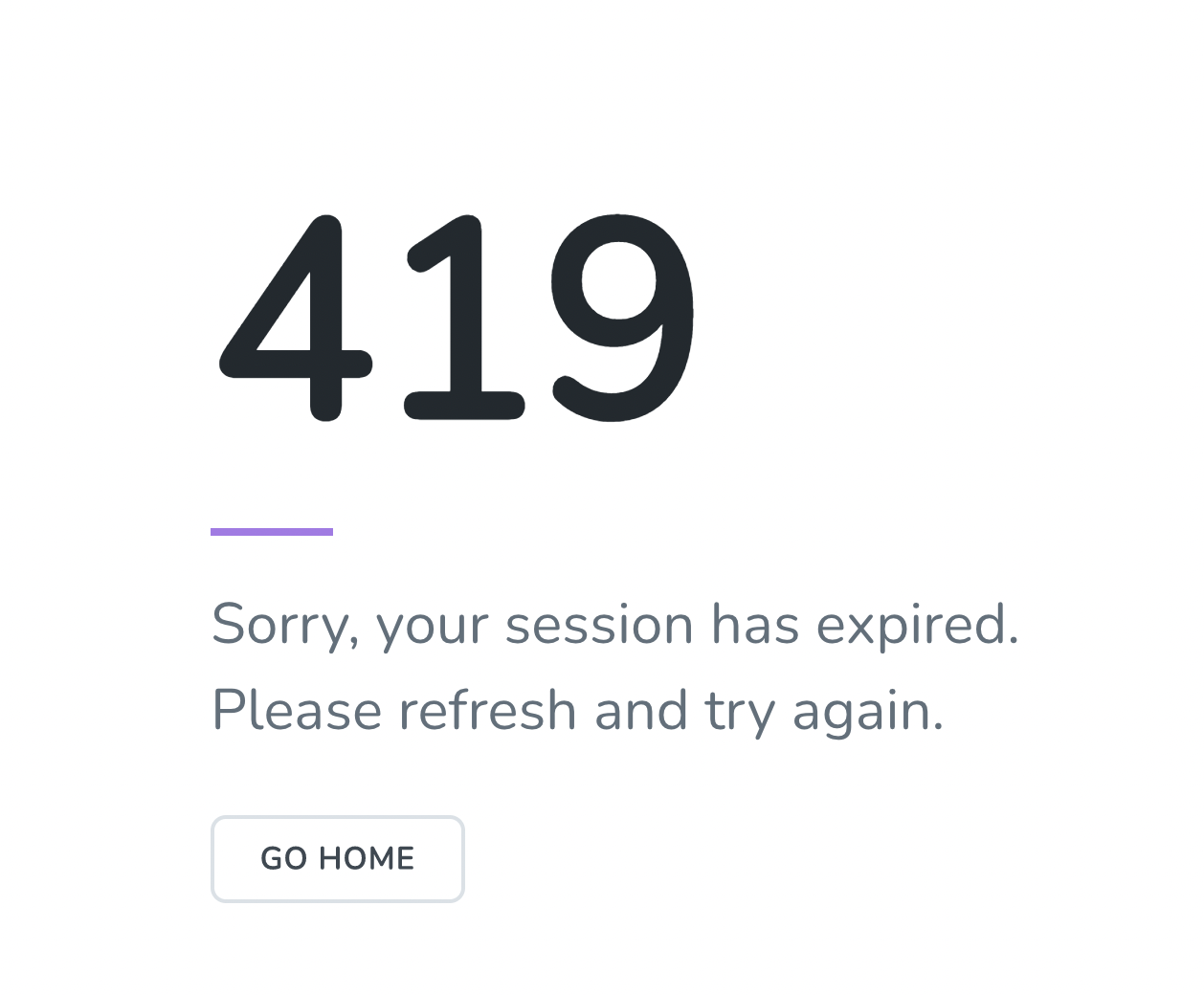

On 9/2/2020 at 6:26 PM, greg_gorrell said:
Does anyone know why I would be unable to access Heimdall all of a sudden?  It worked fine for a year now then over the past week since we had a power outage, I try to login and go to a 419 page informing me that my session expired.  I just access this container inside my network via IP so no reverse proxying or DNS issues.  I also tried deleting the keys and still had no luck.  What might be causing this and how can i force a new session?
Hey! Facing the same issue here. Did you manage to solve it?
  • 4 weeks later...
I had the same issue. fresh install. 419 error when trying to make any changes.
anyone know how to check the logs and see why there is 419 session expired issue?  @linuxserver.io
thanks so much!
@Zotarios
actually, I got it working now.
1. Completely remove the Heimdall installation data folder (/mnt/user/appdata/Heimdall);
2. In the docker config, user your own PID and PGID (cannot be root or the default ones);
3. Re-run the docker, and it worked :)
