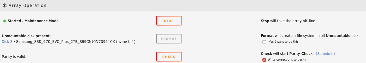

After stopping array and turning on maintenance mode, I do  N O T  see "Check Filesystem Status" available for Disk 3 under MAIN --> DISK 3. The section is just missing. It is available for other data disks, just not this one.
This is what I am seeing in maintenance mode at the moment:
Am running 6.8.3. Not sure how to proceed here.
EDITED TO ADD: second screenshot shows that it still wants to format the drive.... Also, I have not rebooted since beginning this process, if that makes a difference.

3 hours ago, jkp1187 said:
Okay, so followed directions as above, and it looks like it completed, but it's still showing as unmountable.
Please post the diagnostics: Tools -> Diagnostics

Looks like you used a slightly smaller disk to replace disk3:
Aug 26 18:00:39 ZOE-X1 kernel: attempt to access beyond end of device
Aug 26 18:00:39 ZOE-X1 kernel: md3: rw=4096, want=4000797296, limit=3907029104
Disk needs to be same size or larger.
